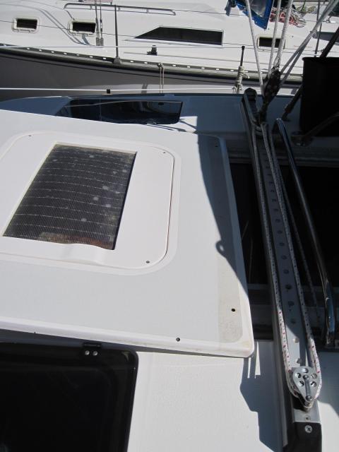

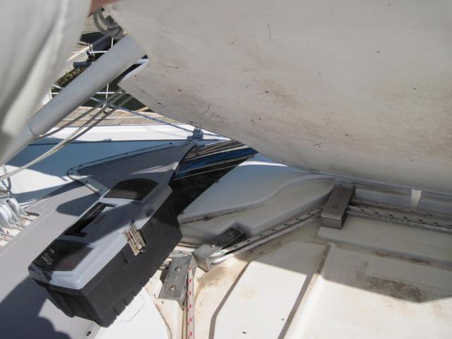

Here are some photos of what is under the sea hood of a Hunter Vision 36. There are two large bolts that run thru the traveler and into the top of the cabin that help secure the sea hood. Then there are about six small screws that hold it in place.

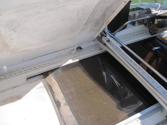

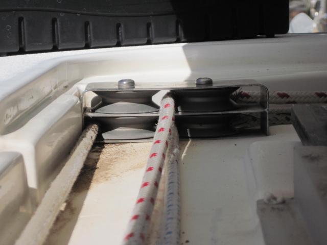

Looks good Steve. I take it is not glued down so you can re-reeve those sheaves relatively easily or add to the vacant position if needed. Also handy to service them if they get gummy. Those angles are pretty large. Any problem with friction? In picture 3 it looks like you are parked next to your old boat!

Yes the old Heather Marie is parted next door.
There was no caulking which made the removal quite easy. I was expecting that the bolts that when through the traveler would be a bugger to remove, but they came out like a hot knife through butter. The only issue was lifting the hood high enough so it would slip out.
The photos are AFTER a major cleaning. There was a lot of mud and debris under the hood.

That sure looks a lot like my 40.5 set up. Traveler looks the same. I have two machine screws on the traveler that are bigger than the others and a couple of positions in from the end of the traveler. Is that similar to yours?

If you look at the first photo there is a blob of caulk. That is where these long 7" screws went through the traveler. You will also notice that there are two holes on the aft edge of the sea hood. That is where the bolts when through the hood.
If you have any screws/bolts that are NOT the end screws for the traveler and are inside the dimensions of the sea hood, they can probably be removed to see if the hood can be removed.

Talked with Garhauer, they are sending bearing sheaves that they say should fit original deck organizers...
If that is true, I will use them on the main and jib halyards!
