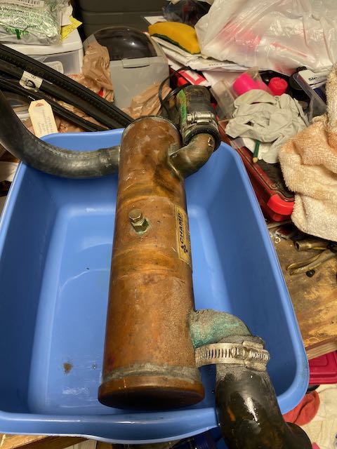

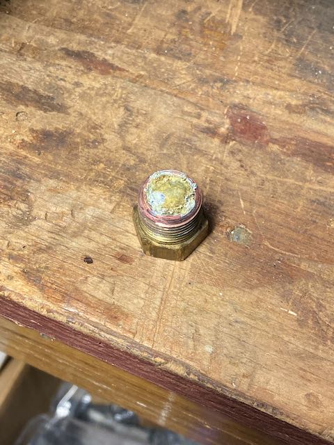

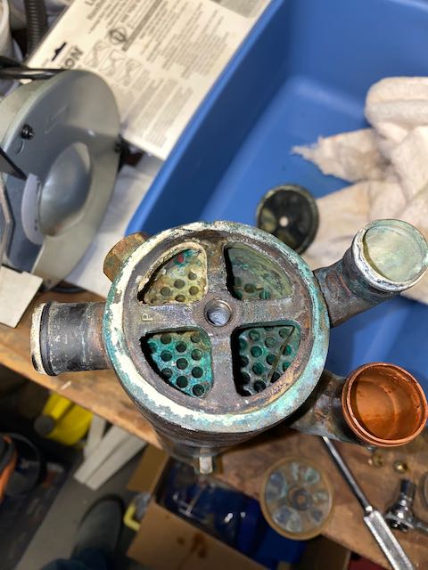

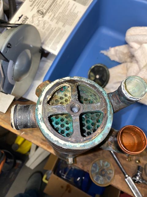

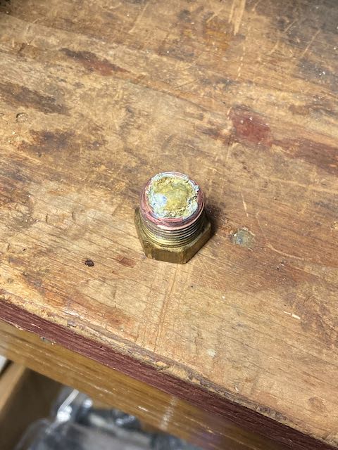

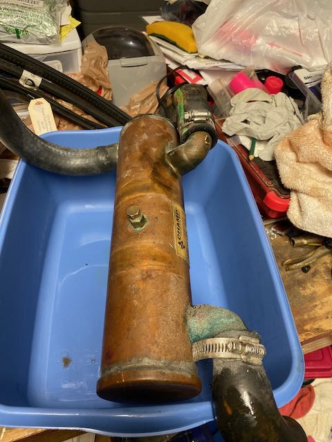

Heat Exchangers are pretty basic radiators. You can buy all sorts of products to clean a unit, but it can be a lot simpler.
Remove it, open it up and look inside. I bought my boat in 2015. It was running ok. so for 4.5 years I just ran it. I decided it was about time to open it up and change the zinc. Well the zinc was gone. and this is what it looked like.
Zinc gone. A bit of copper corrosion, and mostly clean inside.
Took it to a Radiator Shop. They cleaned it, rodded the tubes. Removed all debris. Painted it. Installed a new zinc and pressure tested the unit. $65. Back on the boat working like a Heat Exchanger should.
Not a big problem and I now have a date and record of the service.
