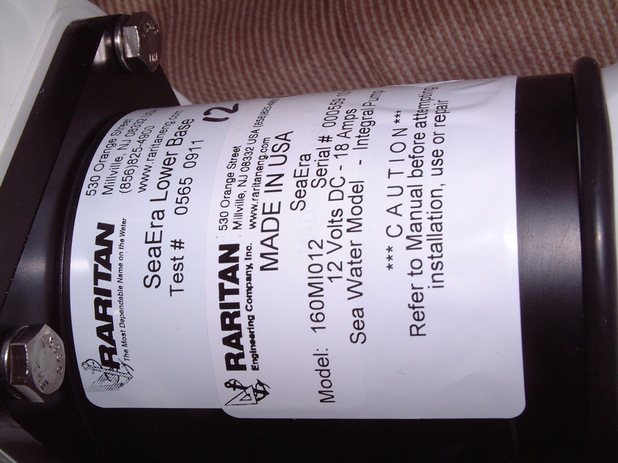

@seadaddler - You asked the model number of the motor. As this may have been superseded, there may be a new part number. I installed in the Spring of 2012. You can see the part number of 160MI012 in the picture below. Defender shows it as just 160012.

I was able to take photo of motor model and looked buying one as spare in case of a
problem and got price $175.00.
