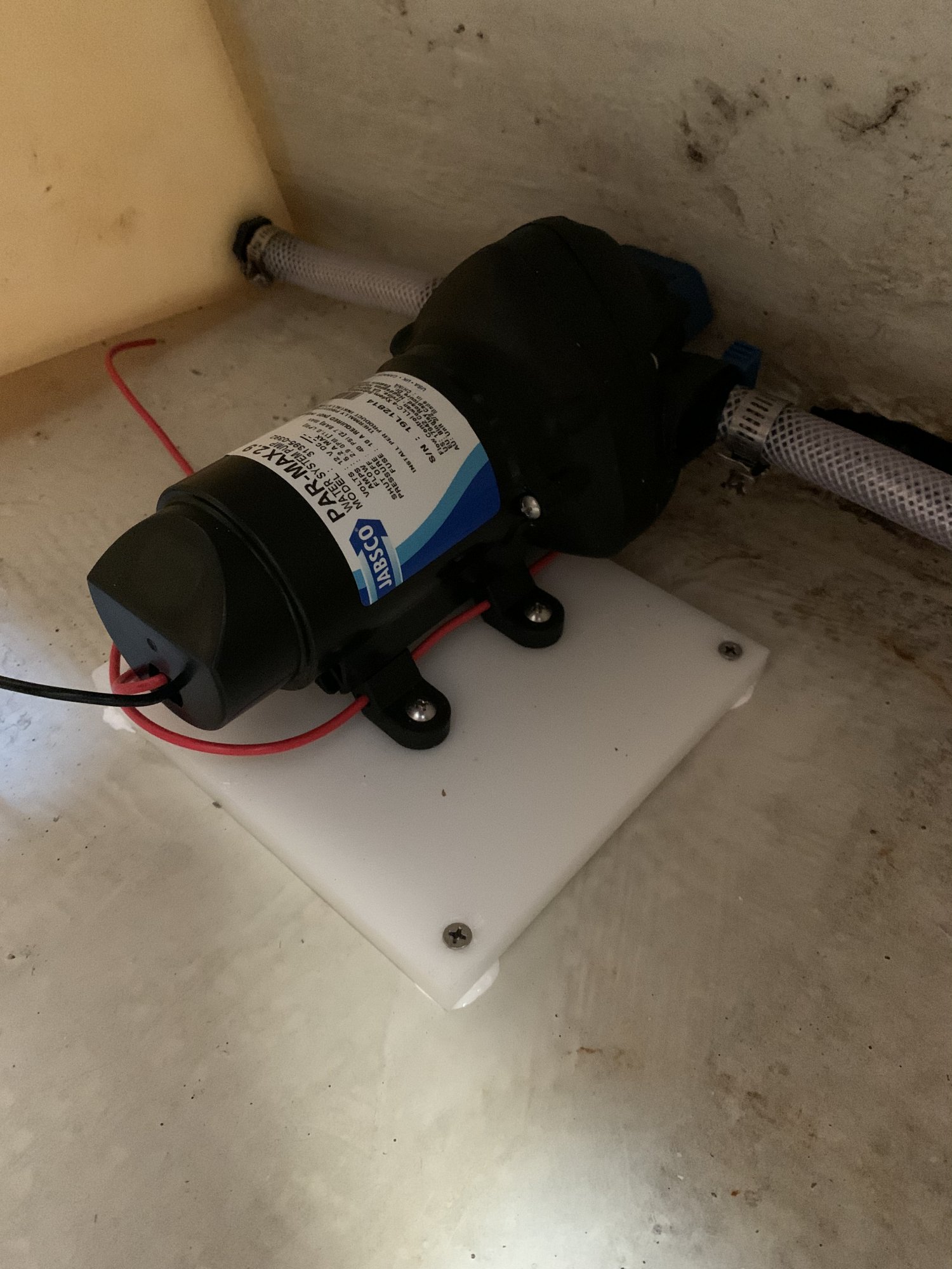

I came up with this wonderful solution using a piece of 1/2” plastic. 5200 on the screws, which just pierce the top layer of fiberglass on this balsa core hull. this provides a permanent platform where the appliance can be easily replaced. It may only be possible with a wood core, as there is on this J/30.

I’ve seen where guys will drill the hole oversize then fill it with thickened epoxy to protect the core then drill into the epoxy. Personally I’d do as suggested and epoxy a piece of ply or plastic and screw into that

Use a sharp bit. The J30 has a cored hull. Drilling into it will give water a way to enter the core. It would be safer to epoxy small blocks of wood to the hull and secure the wire and hose to those blocks.
The PO of my boat drilled into the bilge to secure the pump. Water leaked into the keel, froze and left me with a fun project in the spring. I'd recommend an adhesive over screws as well
