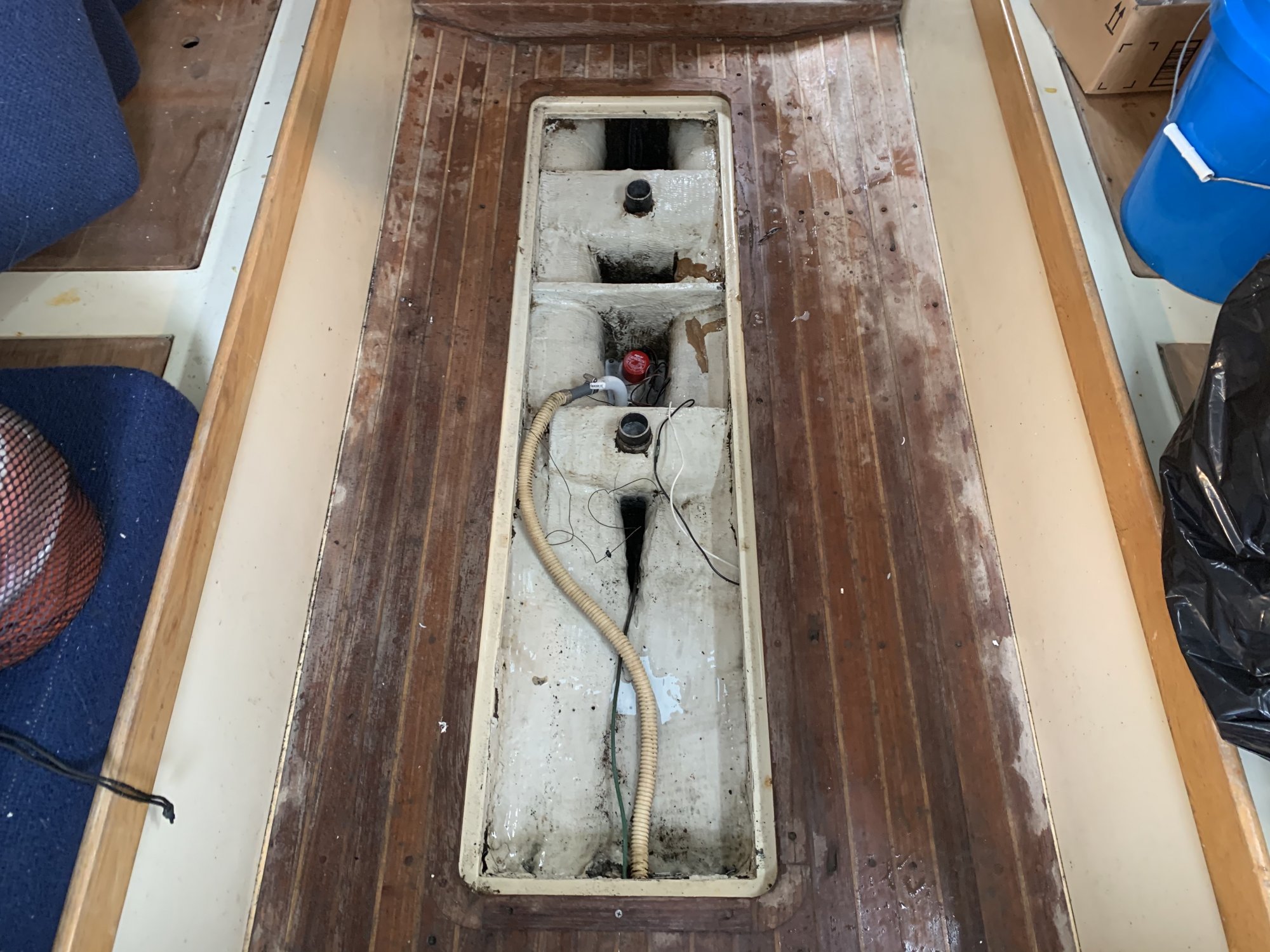

I just installed a bilge pump in a J/30 I just bought and am trying to secure the wires and bilge hose to the fiberglass. I am wondering if there are any tricks to drilling and screwing into fiberglass. I already broke a drill bit, though it may have just been low quality.

(sorry to divert from the original question) Because screws cost almost nothing and they're easy to attach. This is on a vertical side wall of the engine pan (engine bay). The other side of the wall is very high up in a blind bilge. I do actually have some "marine epoxy" in one of those 2-tube injector things. When I used it on something else, I noticed that the leftover from mixing it was very brittle. Would this be better than a couple of screws?
In the photo you posted, everything in the bilge is wood covered by fiberglass. The hull is cored with balsa wood and the the stringers or floor timbers are wood and covered with fiberglass. Penetrating the skins on these parts would put the wood at risk of getting wet.
When you talk about the engine bay, I'm not sure which parts of it you are describing. The two longitudinal ribs that the engine sits on are most likely wood encapsulated with fiberglass.
Epoxy is very brittle, it needs fiberglass or some other thickener to make it less brittle. Thickened West System epoxy or Jamestown Distributor's Total Boat epoxy would be good choices. Both West (SixTen) and Total Boat (Thixio) make epoxy in easy to apply cartridges this would be appropriate for this application.
To @thinwater's point about wood in the bilge being a bad idea, in general he is correct and I would agree with him. However, in this case it is not a critical or structural application, so I would be less concerned about the wood. If the wood should rot, then just grind it out and put in a new piece. If you can use a rot resistant wood like white oak this would be less of an issue.
A Weldmount stud would be the most durable and most expensive option. A piece of pine glued to the side of the bilge with HW store epoxy the least durable and cheapest option. Drilling and screwing directly into the hull the worst option and one the should be avoided at all costs.
