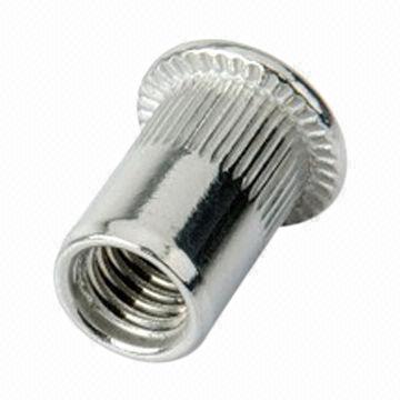

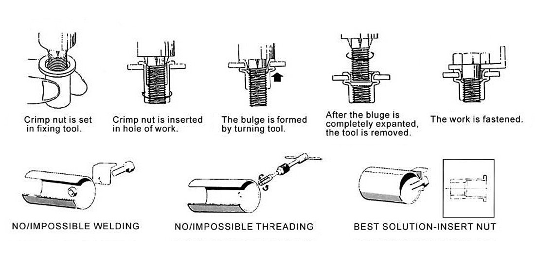

Stainless inserts I could go for... way better than many posts above for products that are just nickel plated from Home-Depot... However, these are still overkill and costly (considering the cost of the rivnuts plus the installation tool. Then you have the risk of fouling the threads with epoxy when installing. Yes, you can wax them but you risk cross-contamination and then you gotta clean the wax out... plus, they will still rust eventually and be a bear to remove. The WEST article claims 800 psi strength on threads cut into epoxy. The OP's Dodger will have grommets every 6 to 8 inches, why would you need more than that? Seriously, this is a $20 repair and this thread is going nuts on it (no pun intended).
In my humble opinion, given that the mounting holes are blind, and a strong, secure attachment with corrosion-resistant hardware is high desirable, the best answer to this problem is a stainless steel rivet nut insert. Just make sure the grip length of the rivet is adequate, and you'll need to purchase a relatively inexpensive tool. I advise "bedding" the hole with epoxy or acrylic resin as you install them.

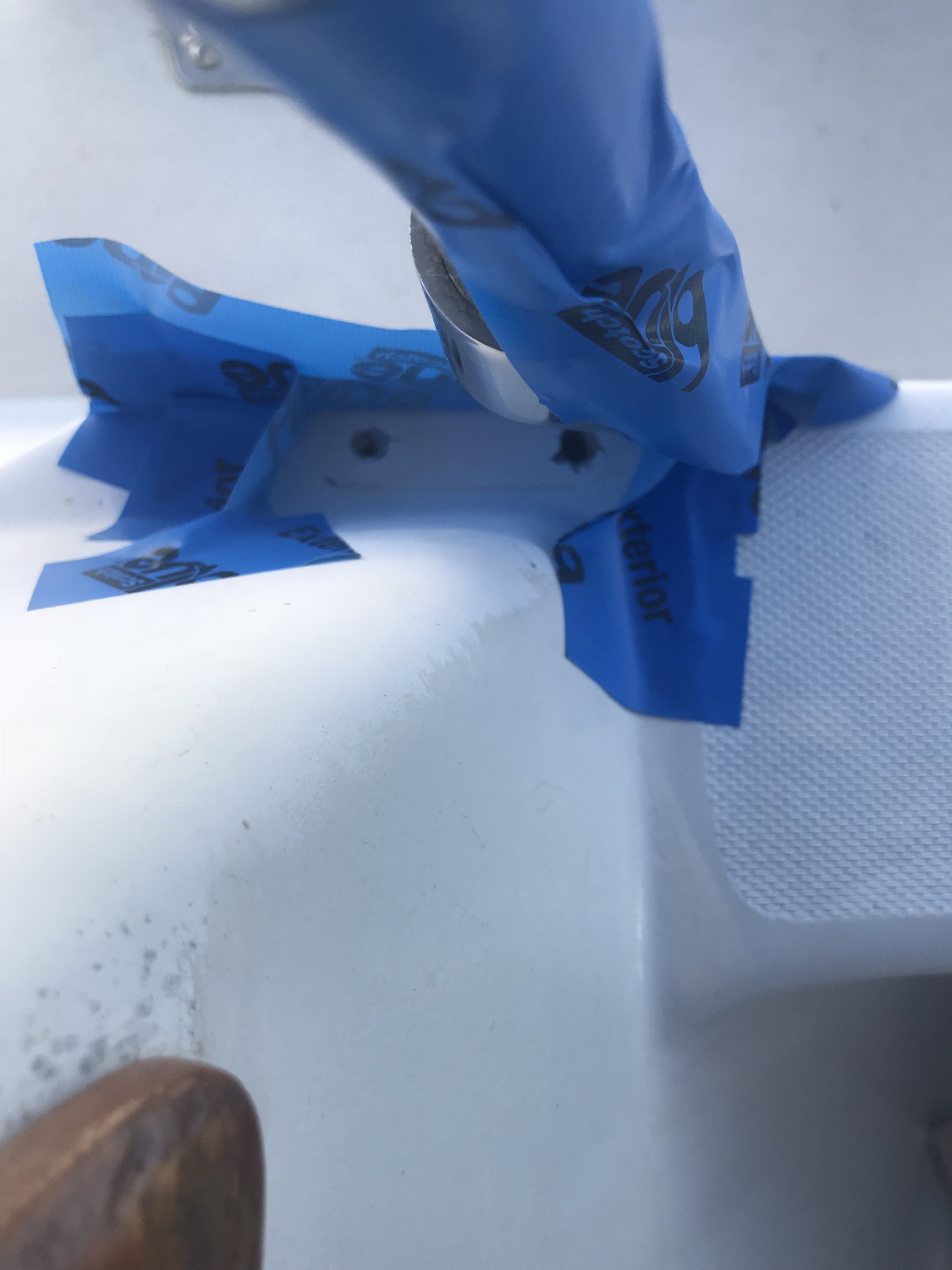

26F70A44-5264-41E0-AB74-8862F3746C81.jpeg I attempted to tape off the area to reduce the mess I knew I was going to make at this point.
You can get to where the cabin top comes down but just outside the cabin top, where the holes are is not accessible.
Like I said, I knew I was not doing it right and just wanted it done. Lesson learned. I attempted to use fiber mat to ‘thicken’ up the epoxy (it didn’t need it... I did not realize how sticky it was going to be so went ahead anyway)
There is a list of what I should not have done. Possibly the worst part is that the previous owner probably would have been more than happy to come show me the right way... but I wanted to do it myself.
All that said, we bought this boat to learn how to sail and learn how to work on boats. Before moving up to a larger cruiser. So I am learning.
I know I won’t do that again.

For what it's worth, they are less than $2/ea., and the tool can be had for as little as $20.
So, for eight holes, say you had to buy ten inserts and the tool, that's $5/installed insert, and at the end you have two leftover inserts, and the tool.
2 pump of epoxy and 2 tablespoons of microfibers = $0.56
Drill bits and taps you already have in your tool box = $0
Still a stronger repair, can be reversed/repeated/repaired easily, will not rust.
