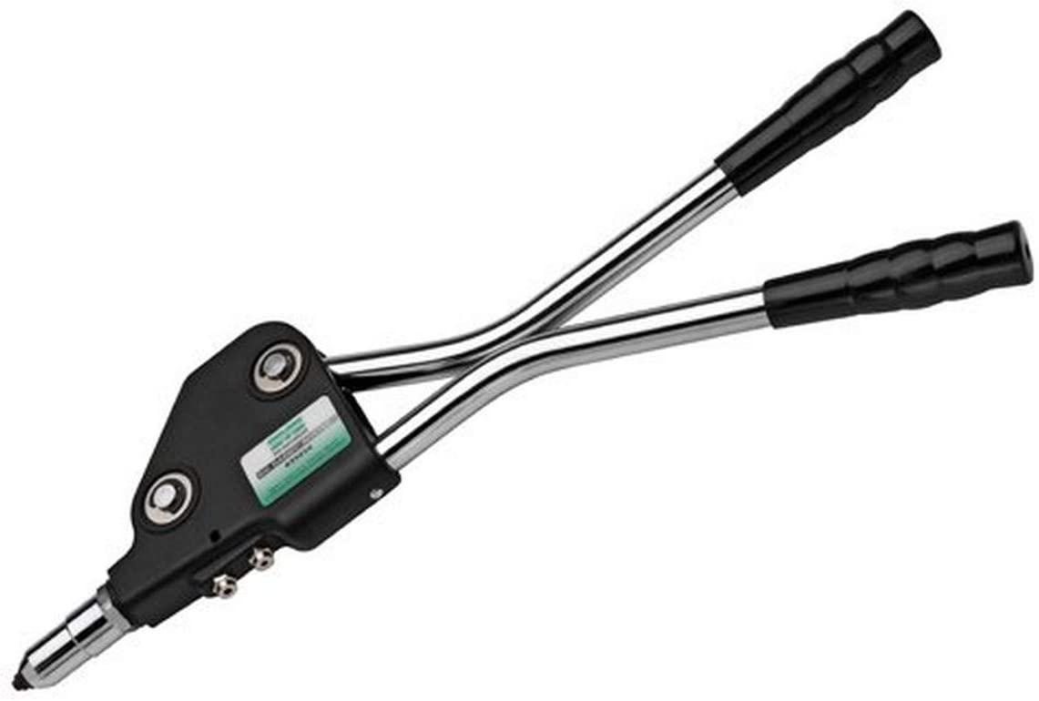

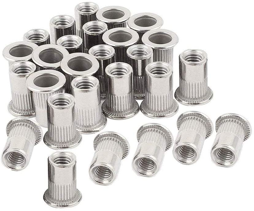

Personally I would use SS rivet nut inserts. Have used them for years in Industry. Like a rivet however you use a SS bolt to attach track ,is removable and much stronger then tapping aluiminum and replaceable if ever stripped ,however unlikely. Used them 3x this week alone. They are also available in Aluminum, steel etc
