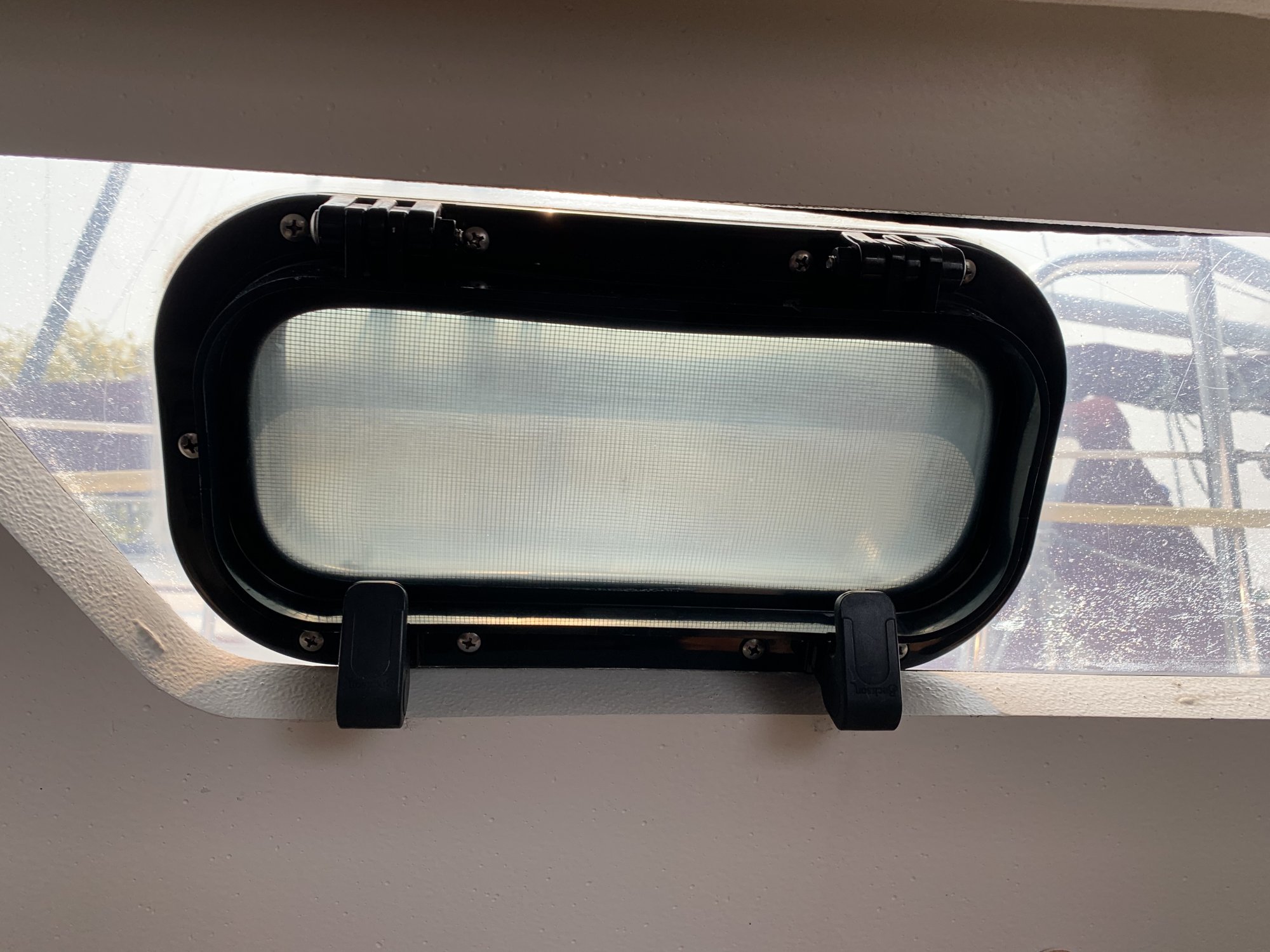

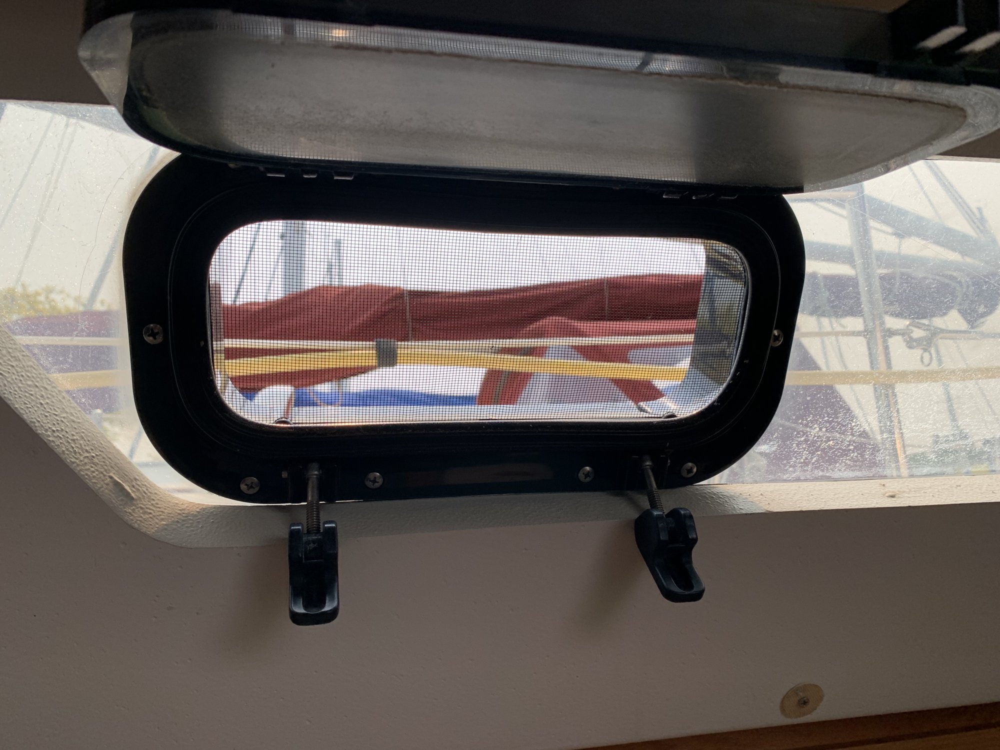

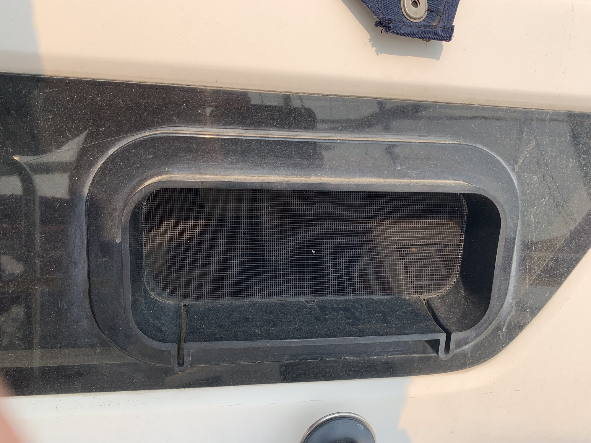

The screens on the window over the fridge and in the head need to be replaced. I’m not sure how to do it, hopefully it’s as easy as taking off the inside trim and I don’t need to break the seal on the plexi windows. See pics

They are removable from the inside after you open then. I did replace them, it was with some normal screen replacements material. They also can be ordered from cataline direct.

Ooow, that’s what I was hoping for. Did you remove the screws and the whole inside came off? And was there a round rubber ‘gasket’ that fits into a slot to keep the screen in place?

I honestly don't remember. The screen frame is part of keeping those from leaking, so plan accordingly to avoid rain, trust me:)

Those opening ports are Beckson Raindrain. Just open the port, carefully pull out the rubber gasket (its slotted into the frame) that holds the screen in place and that's it. The screen has sort of a molded-in plastic perimeter. You might be able to find some way to glue or attach new screen to the old edge, but its probably easier to order new screens from Beckson.

New screens came yesterday, installed today just like mentioned above. Open window, remove gasket and old screen, clean everything, install screen and gasket. Thanks for above info.
