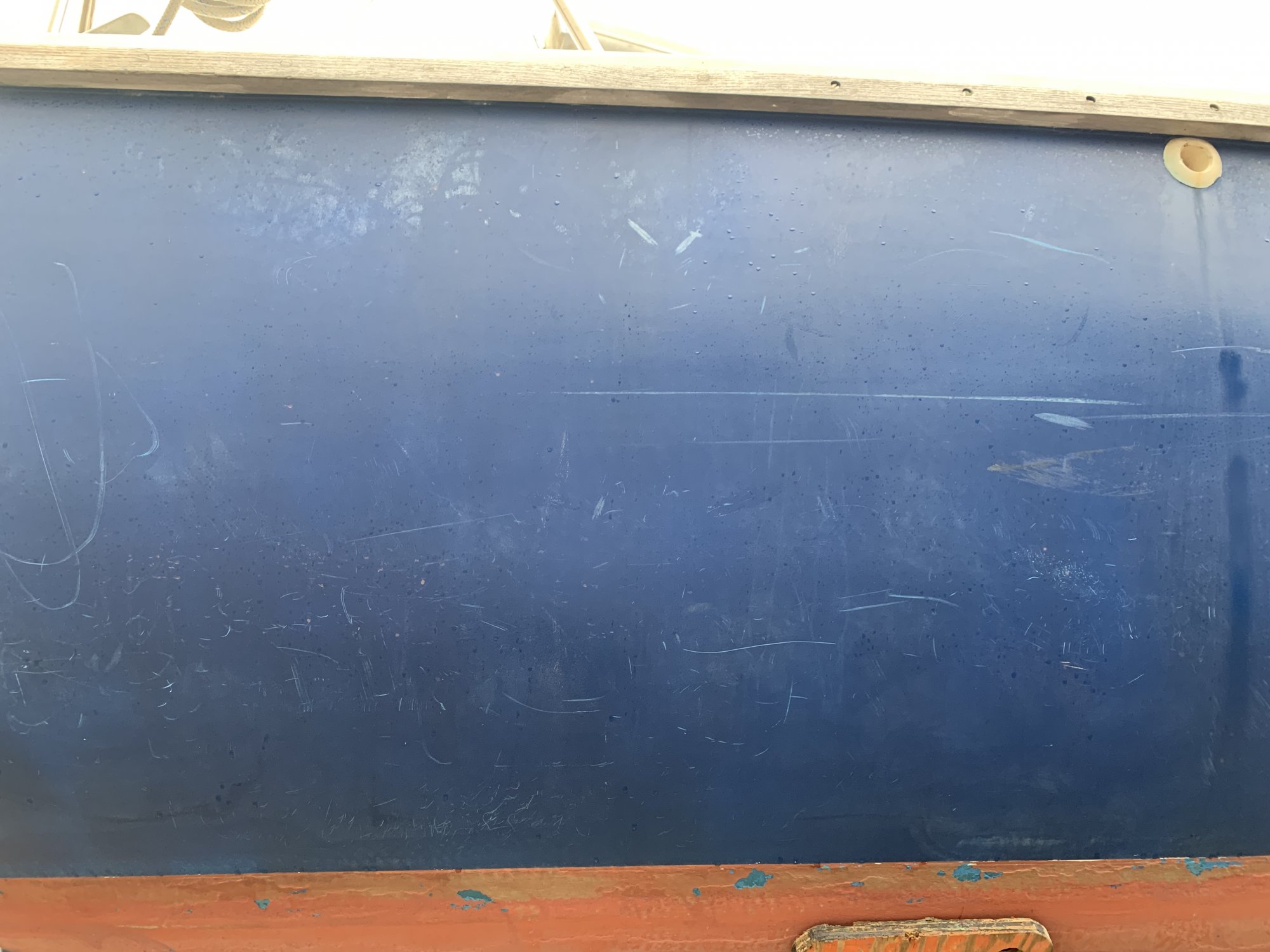

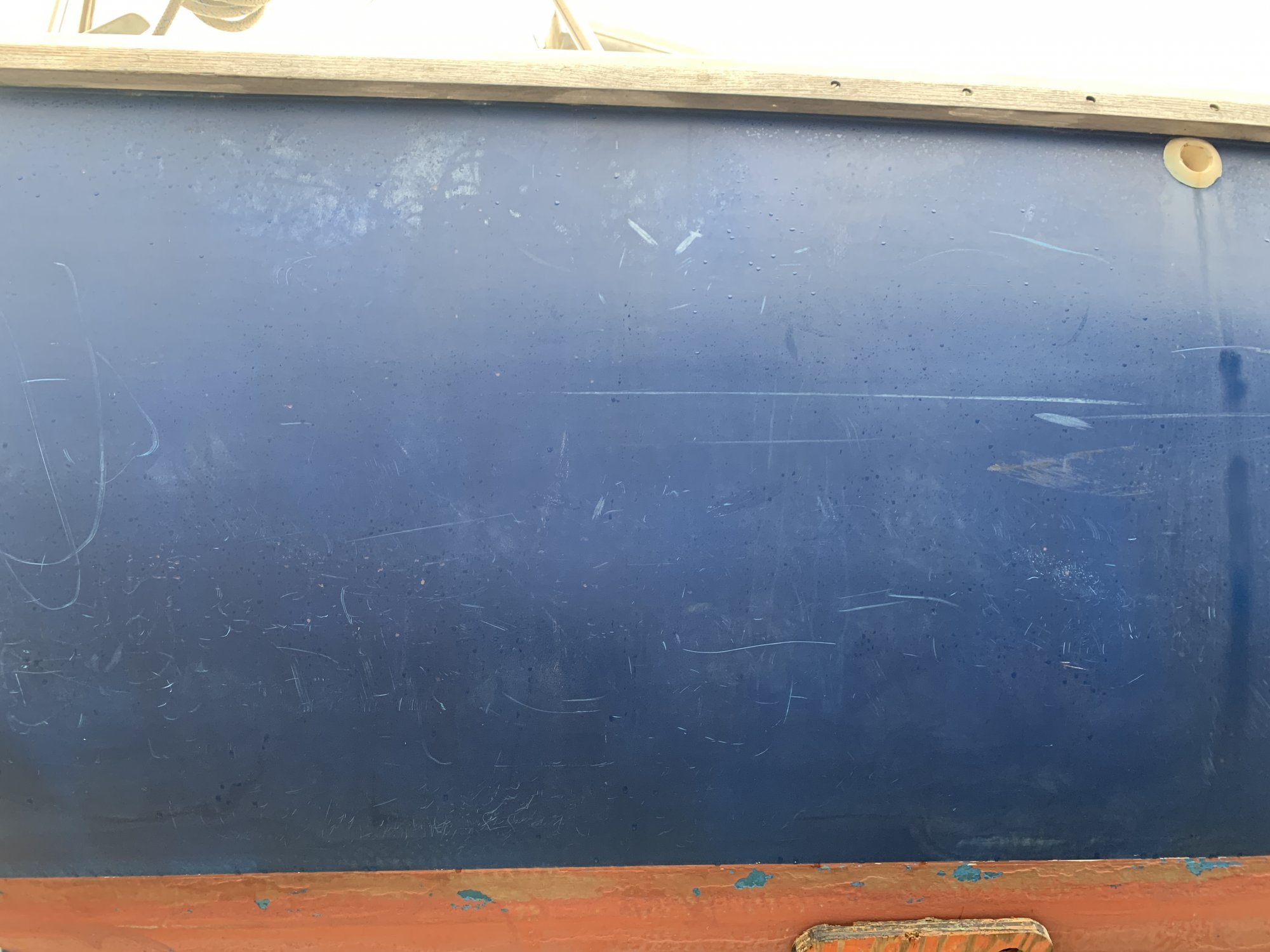

I had my previously white 1983 sailboat gelcoated blue in 2020 by a hardworking local guy mostly known for fiberglass repair. He prepped the crap out of it but something obviously didn’t go right. After 2 yrs of usual dock bumps etc, it now it looks like this. A lot of the scratches go through to the previous gelcoat. Now it’s on the hard for the winter, trying to figure out how to best salvage this situation. Most straightforward (and cheap) option is to wet-sand, compound, polish and wax. I can also try to repair, the guy left me the leftover blue GC, but that seems like a lot of V-cutting, filling and feathering. I can also just throw in the towel and have it redone but before I spend the cash, I wanted to know what you guys thought the best possible outcome would be with the other two methods.
14,293
I'm afraid the deep scratches will need to be repaired with new gelcoat and the 2 year old gelcoat that you have has probably passed its shelf life.
While dark hulls look great, they make minor scratches and dings far more obvious.

unfortunately it’s time to do over. I’d advise you to go back to white. Anything else and you’ll always have very obvious tells when you get even a small scratch. Remove all the blue gelcoat then paint it. Roll and tip. Much easier to touch up in the future.

You could fill the scratches, sand it and put on more gelcoat layers. Let’s be honest, you‘ve been rough on that boat. It’s got dock rash. Unless you start babying the finish and using clean soft covered fenders, in another 2 or 3 years it’ll probably look like it does now.

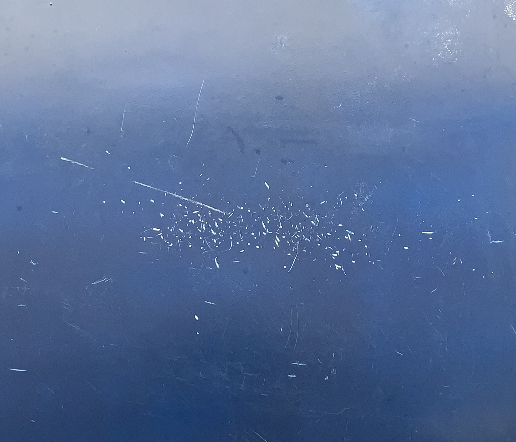

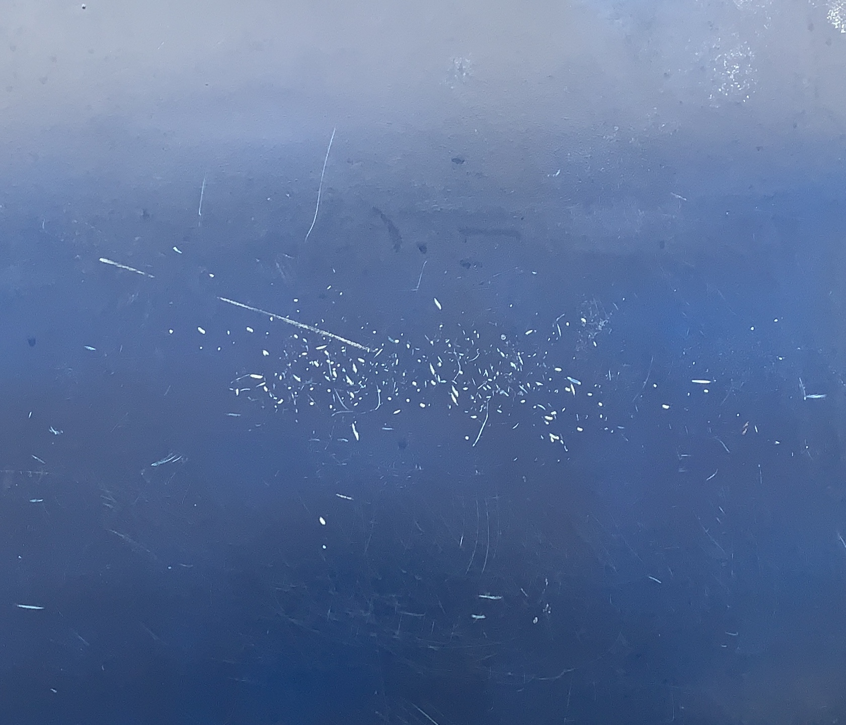

Edit: Your second picture looks like something was banging repeatedly against the hull. Did you leave a fishing rod out with a sinker hanging? Also, the upper-right part of that image looks like the gelcoat is too thin - is that white showing through? Gelcoat isn’t paint... it needs to be thicker. Also, it doesn’t look smooth or shiny. After 2 years it should not chalk.
You can try a heavy compound or wet sanding with 400/600/800 grit. Start in a limited area and see how it looks. The blue might be too thin for that, though, and it won’t fix the white showing through.

Gelcoat is tough, but it is not bullet proof. Neither is paint. I'm speculating a bit, however, when the new gel coat was applied, it was probably thick enough to give a nice finish, but it was probably not as thick as the original factory applied gelcoat. That, and darker colors show defects more than lighter colors, so any damage becomes more apparent. One of the reasons white or off white gelcoat is the goto color for boats.
As for the chalking, different formulations of gelcoat have different tolerances for UV which is what causes chalking and fading. Color also makes a difference. Red gelcoat is terrible, chalks and fades quickly. Some blues also chalk easily. Annual waxing with a good quality wax will slow the process down.
Andy Miller on the BoatWorksToday YouTube channel has many videos on gelcoat and painting. Before making a decision and spending big bucks, spend sometime over the winter reviewing those videos so you can make a well informed decision.
For the next year it might be worthwhile to just clean things up as well as you can. A good machine buffing with a good quality buffing compound followed by a good waxing will improve the looks, but not get rid of the deeper gouges. This will give you some time to think about your options and practice docking and protecting your hull.
In the end you will have 4 choices, live with what you have, gelcoat again, paint it, or use a vinyl wrap. Apparently a lot of aluminum boats have gone with the wraps, less expensive than painting and easier to repair.

As mentioned above, the blue gel coat does look thin. So thin that minor scuffs show through to the white.

Gelcoat is basically a polyester resin, most resins have a "post cure" phase where the resin feels cured, but it isn't. It is still a bit soft and will take more time to fully cure and be as hard as it will be when fully cured. The post cure phase may last a week or more. This is when the gelcoat is most vulnerable.

Your gelcoat is in poor condition. Lots of porosity as well as the scratches we see in your photos. If the white we see is what is below the blue, then wet sanding is futile. If you had scratches that did not go through the blue color, wet sanding the entire hull and then buffing might make it look pretty good, but I don't think this is the case here. It is better to paint a hull than re-gelcoat it in my opinion. Today's Linear Polyurethane paints, like Awlgrip have better color retention, abrasion resistance, etc. Pretty toxic stuff, so if you do it yourself, you should protect your lungs, eyes and skin. It is sprayable or can be rolled and brushed on. You just have to pick the right products for the job, which is explained in their product information. Interlux also make a linear polyurethane roll and tip formula for the DIYers which you might find more user friendly. The color selection from Awlgrip is much greater than what Interlux offers, if that matters.
