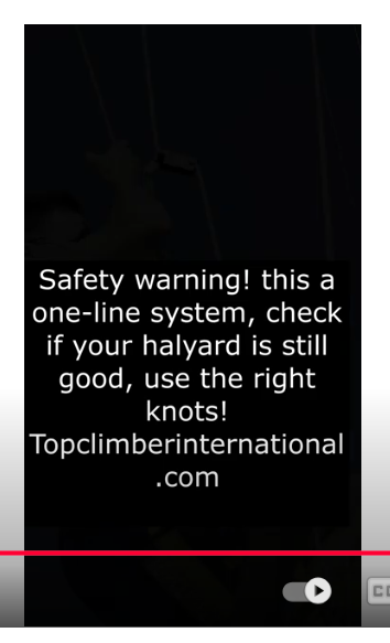

Not a question. Just had to say I scored an item I have wanted for a while! I bought a slightly used ATN Topclimber Mast Climbing system for $150 on FB Marketplace. I've wanted my own since a slip neighbor used his on my mast to replace my anemometer vane. I'm approaching 70 years old but I stay fit and I'm confident I can do this. Thanks for hearing me out.

It's supposed to arrive Saturday so I'll check. I imagine they are metal. From the video, it seems to stay clear of the mast.

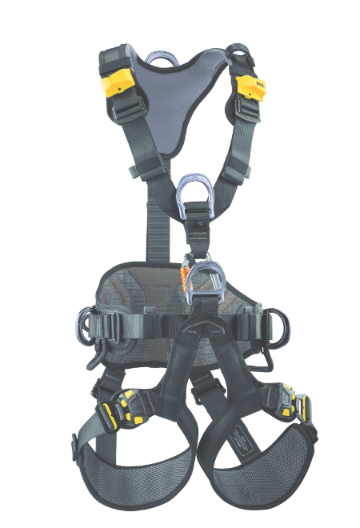

Get a climbing harness as a backup. As they say, "Two is one and one is none."
I agree. I use two completely independent harnesses. I use a 5-strap safety harness with D-ring attachment at the waist for my primary climbing gear. I do not feel secure in any of the "bosun chairs" I have tried. I then back that up with a safety harness that attaches at chest level for an independent back up. That way if for any reason, I lose consciousness, I can be lowered upright instead of inverted. The safety harness is tied to one harness with a bowline and the climbing harness is tied to two other halyards. each are controlled by my wife. I self-climb using the fourth halyard which is cleated to the deck and tensioned. I use a prussik knot to a pair a stirrup to stand up in and then my wife hand pulls the climbing harness up to my new height.

A few things.
  • Wrap the outside of the ascenders with athletic tape. Better grip, no scratches, takes minutes.
  • One RATED harness is all that is needed. That is all tower works and climbers use. But the bosun's chair is not rated, so it actually counts as zero.
  • The harness must be such that you can not fall out, even inverted. If you have a waist, a snug climbing harness works. If you don't have a waist you will need a body harness. OSHA requires them because that is the only way they can be sure for all workers of all shapes.
  • For hand time comfort look for wide leg loops. Narrow, climbing harness loops and standard fall protection harness will put your legs to sleep. You need a big wall harness, a tower harness (above), or you can add padding to a climbing harness (works really well).
  • Practice low on the mast until it seems easy and logical.
  • Pre-tension the halyard snug. This will prevent sagging back and bouncing.
  • And most important. The primary and secondary halyards must climb-worthy. The sheave and axle it runs over must be climb-worthy, and the tail must be well secured (a cleat or winch in addition to a clutch IMO). You don't need 4 halyards if they are good. With two ascenders on the halyard you really do not need a belay, other than against the chance of a main halyard failure. But the primary halyard must be above question. If it is not, replace it with a climbing rope (a rope suitable for climbing). If the pulley or entire masthead is suspect, you can back up your climbing with a Prusik around the mast.
Finally, your belayer is NOT a practiced climbing belayer. Might be a good guy, but that is not the same as training. Don't expect them to do something that they are not trained for and practiced in. A winch is NOT designed for lowering people, and a MUCH higher percentage of people have been dropped on sailboats than with climbing belay devices. I was around the seen after a guy got dropped lowering. The belayer made some unknown mistake. We think there may have been a loop of slack and the rope popped off the drum. This is NOT what winches are for. I've been lowered from climbs and rappeled many thousands of times, sometimes in horrible conditions, and getting lowered with a winch gives me the creaps far more. My opinion based on some accidents.
padded harness

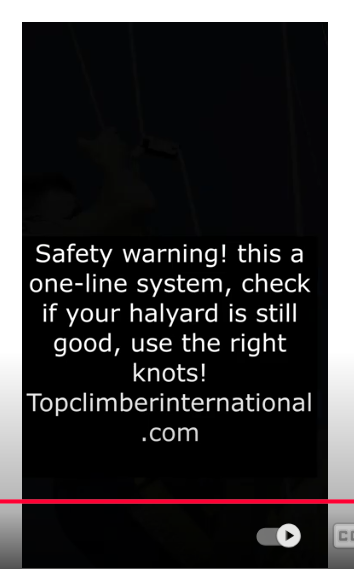

No ................... use a rated safety backup harness with its own halyard. The topclimber is not a rated harness.

So true.
The Top Climber harness not being rated. It's sort of a joke and they should leave it out. It's that bad. I'm also not that sure I like any of the webbing, since it carries no UIAA or ISO approvals.
And thus a second halyard is required. If it were Petzel gear I would feel differently, since it IS rated as a single line system, with all gear up to UIAA and EN requirements. But only if the primary halyard is not 100%, we can't know, so 2 halyards is smart. I use a second.
The ONLY benifits of the Top Climber system is that they collect the gear for you. The gear is ... built to a price point.
