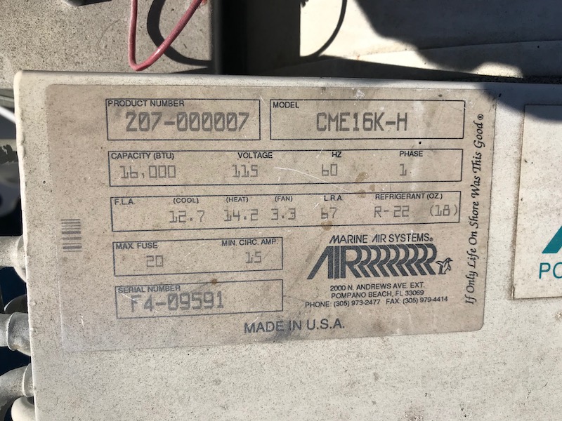

I think this is a good thing.
There's a marine mechanic who spends the winter in our marina working on barges and other boat repairs for the owner. He had a Marine Air Systems 16k BTU air conditioner, with heat, complete with water pump and digital thermostat for sale.
He had pulled it out of a boat he was working on up north, for use in his Hunter 40' but decided he didn't need it since he spends his summers up north in St John, NB.
It looks to be in great condition. No rust in the pan or on any of the components. Has all the parts to install it. Supposedly only has a couple of hours on it.
I paid $250 for it which, if it works well, I think is a great price to get AC on the boat.
My biggest concern is the sticker says it uses R22 refrigerant, which is being phased out.
Hopefully it will work with a replacement refrigerant if needed.
The model is CME16K-H.
Here's a photo of the label and the unit. Anybody have experience, good or bad, with one of these units? I know it's a reach but anyone have a manual?

Sounds great if it works as advertised. One thing you might want to keep an eye on is if 16K is too much for your boat; it's the same size as in our 37'. From what I've read bigger isn't necessarily better beyond a certain point, as the unit might not cycle long enough to dehumidify the air very well.

That is a great deal, Ward.. I have one of their 12000 BTU units that I installed in 1995 or so.. I had to replace my compressor because the case corroded through (my fault) .. Mine has run almost continuously as a dehumidifier since installation..and many weekends with us aboard.. We don't decommission in the winter so I mean continuously.. Great unit.. Any shop will have F22 and if the unit does not leak, none will be required.. My unit did not need F-22 until I had to replace the compressor and it has not needed any since.. On the coast in 'Jersey in the summer, I think you'll be fine with that capacity.
I know this is a concern in room air conditioners but my wife likes the thermostat set low for sleeping so we always buy oversized units. We'll see how it works on the boat.
Maybe we can use it to keep our beverages chilled as well.:laugh:
Glad to hear positive comments about the Marine Air units.
@Justin_NSA Thanks for the link. Sounds like having R22 isn't really an issue.
Anyone have a manual for the unit or similar unit they can scan for me?

I think that unit uses a scrol type compressor and if it uses that type compressor then if you purge the sys I believe it can take the newer replacement refrigerant. Check with a company that works on reverses cycle sys for variation before obviously. R22 is still obtainable just expensive because whoever has it knows that they have it and you need it unfortunately. I'm pretty sure that just about every system out there can be converted fairly inexpensively.

Hi Ward, we have the same unit on our boat for the main and forward cabins. A 9K BTU unit for the aft cabin, both original 1991 still work great on both sides, but seldom used except for heat during the winter while at the dock. Never gets that warm or humid around here. It always amazes me how it can draw warm air from 45 degree sea water. The 16K BTU unit (120VAC) and the Little Giant (120 VAC) sea water pump both consume about 12 amps while running. Pretty efficient. Most any marine refrigeration technician has R-22 on hand, but a bit pricey. Then again the unit does not take that much.
I have the User Manual, but no Service Manual, if that is what you mean. If the User Manual will do I can send you a copy. Let me know.

its possible to get the R22 but expensive, however the volume of the stuff in that AC unit is relatively low compared to a home system.
Presently, I believe residential systems are a couple of generations removed from R22 if they even used it. I had the misfortune of a heat pump crashing last year at about 20 minutes beyond warranty. The cost of leak testing with the old refrigerant was so prohibitive coupled with the age of the unit made me decide to replace the whole thing. The people who cornered the market on the remaining old refrigerant are making a killing selling it by the pound.
