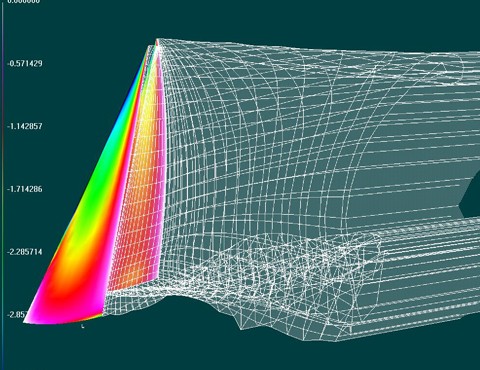

There are plenty of resources that will talk about the relationship between lift and sailplan. Twist factors into this, but only because the effects of the changes in velocity and angle (friction and coriolis) as elevation increases. The underlying concepts do not change.Google 'CFD sailplan' for more insights.
