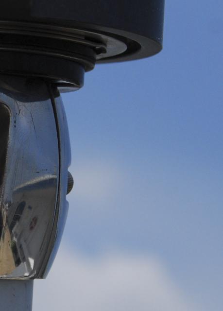

"Whilst the furling mechanism of the furler works well, I have discovered that the genoa has developed 2 chafing spots. These correspond with the location of the 2 cap screws in the sail feeder.
Even though the screws are tightened, their edges do protrude slightly and seem to rub on the sail when furled.
I am surprised to encounter such gross design fault."

- Picture 'Sailfeeder 2' shows clearly that the screws are not recessed
sufficiently enough, even though they are tight and the halves of the
sailfeeder are tightly pressed together.

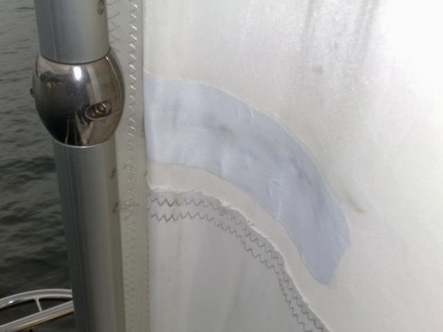

The picture also shows (underneath the tempory sailpatch) the developing
holes from the chafe.
- Picture 'Sailfeeder 3' shows that the sailfeeder/foils are installed
according to the manual.
I think that the pictures demonstrate that part of the screws with their
ribbed heads protrude enough to cause serious chafe. Do these appear to be
standard screws? The heads seem to be to big for the aperture.

"I guess I might wipe the head of the fasteners with silicon acting as an
anti-chafe guard.
Your installation looks good and the feeder and fasteners are as designed.
We have improved our installation manual and is worth downloading with great
hints and tips."
Response to Schaefer:
"Thanks for your advice. However, I do not think that a silicone application
is a permanent answer. It will be worn off in no time. The only real
solution would be to file the existing screws' heads off (which could
possibly result in further unforeseen edges and rust) or preferably in
properly fitting screws. If the latter are available, could I order them?
Otherwise I shall have to continue to use sacrificial sailtape - which is
certainly not a satisfactory outcome."

Kinda odd that the fitting is of a larger diameter than the foil which would put greater stress on the cloth at that point. The silicon recommendation was bs; it appears as though the only solution is to use different screws (a round head might work), file that part of the screw head fair and/or put some duct tape on it ;-)
Jul 3, 2004
8
- - kansas
You could exchange those screws for the same except for a button head, which would be quite safe in the recess.

Got the same problem
I just put a piece of sail repair tape over the spot to protect the original sail cloth. Next time in the sail loft I will have them add a patch over it. It is not worn through just marked up from that big round fitting.

Try a Low Head
A button head might or might not work - generally the screw head diameter dimension is larger. There is also a screw called a low head cap screw - these generally have the same head diameter as the standard cap screw in your picture, but less head height. This may well solve your problem, though the head is not as strong as the standard head. Is it highly stressed?
Here is a link for metric screw dimensions: http://www.metricsunlimited.com/products.html . If I remember correctly, inch screws share similar screw head proportions - you might try a search on "inch screw head dimensions" or similar.

If the cap-screws can't be easily replaced or filed enough, I would be tempted to file their protruding edge off, then fill the screw "pocket" with some epoxy and sand that flush.
Maybe even some tape over the screw-pocket would suffice.
