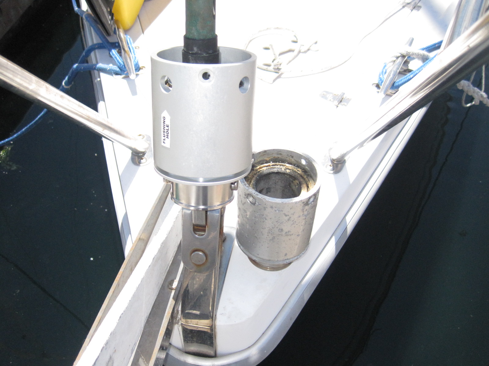

I received the new drum from Schaefer and finally found time to do the swap. Easier than I expected, I could do it in half the time now, but hopefully never have to. I should have done it sooner.
No need to drop the forestay, as shown in the video the drum disconnects from the torque tube fairly easily, then disconnect the bottom pin on the forestay after slacking the forestay and the backstay (as in the video use a halyard as a temporary forestay) and swap drums, then reconnect. The forestay is only disconnected for a few minutes.
As you can see in the picture, there are two flushing holes in the new drum. The bearings themselves are Torlon plastic, but the races are aluminum, and that is what corroded in mine causing the roughness. Being able to flush it properly will let this one last a long time.
It's Smooooth!
If you have the old style drum and it's at all hard to turn, it's well worth the relatively small cost and time to change it.
Now I'm still waiting for the new sails to play with!

Very nice. With the two side by side it is easy to decide which on you want on the forestay adjusting your sail.
Fair winds.
