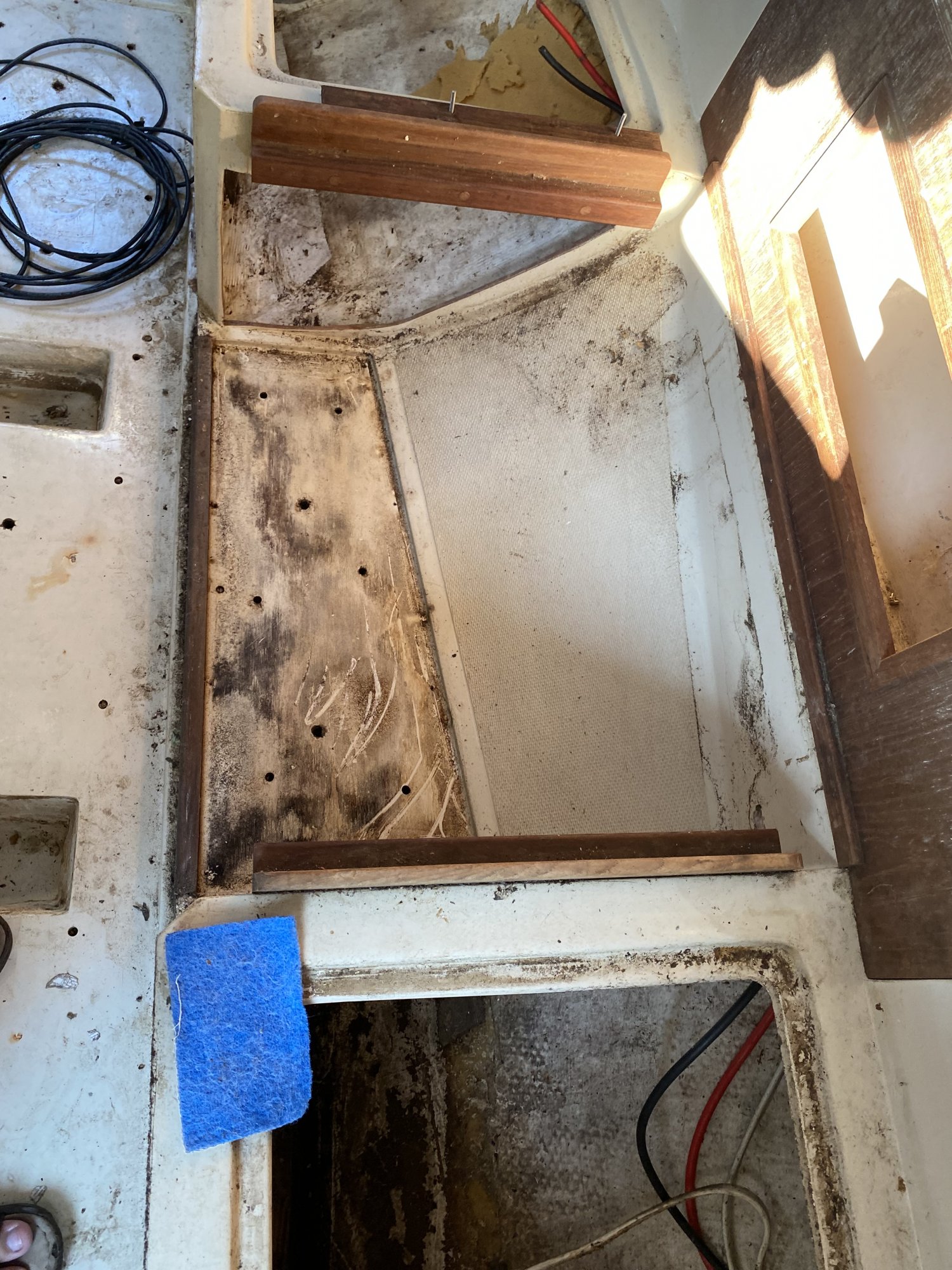

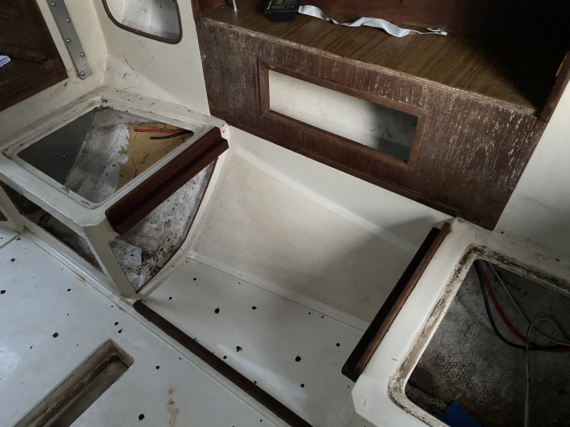

So not much to report for this week, I spent most of it in Alaska. Today was the only day I got to work, and this weekend won’t be much if anything at all. So when I get to Serenity I notice a bunch of stuff going on. The boat behind mine sunk and they just got her refloated and were trying to secure her to prevent her from going under again. Apparently a shaft seal finally failed and the pump couldn’t keep up, then the boat got unplugged and that was the end of her pumping. The marina staff tried to rescue her in time but didn’t have the correct hoses for the pumps within easy reach, by the time they got the right hoses the cowl vents were underwater and even the 120v pump wasn't enough. Here is a pic of the boat with the new ”waterline”. The owner passed away a couple weeks ago so I don’t know what’s gonna happen with it. It is a wooden boat too.

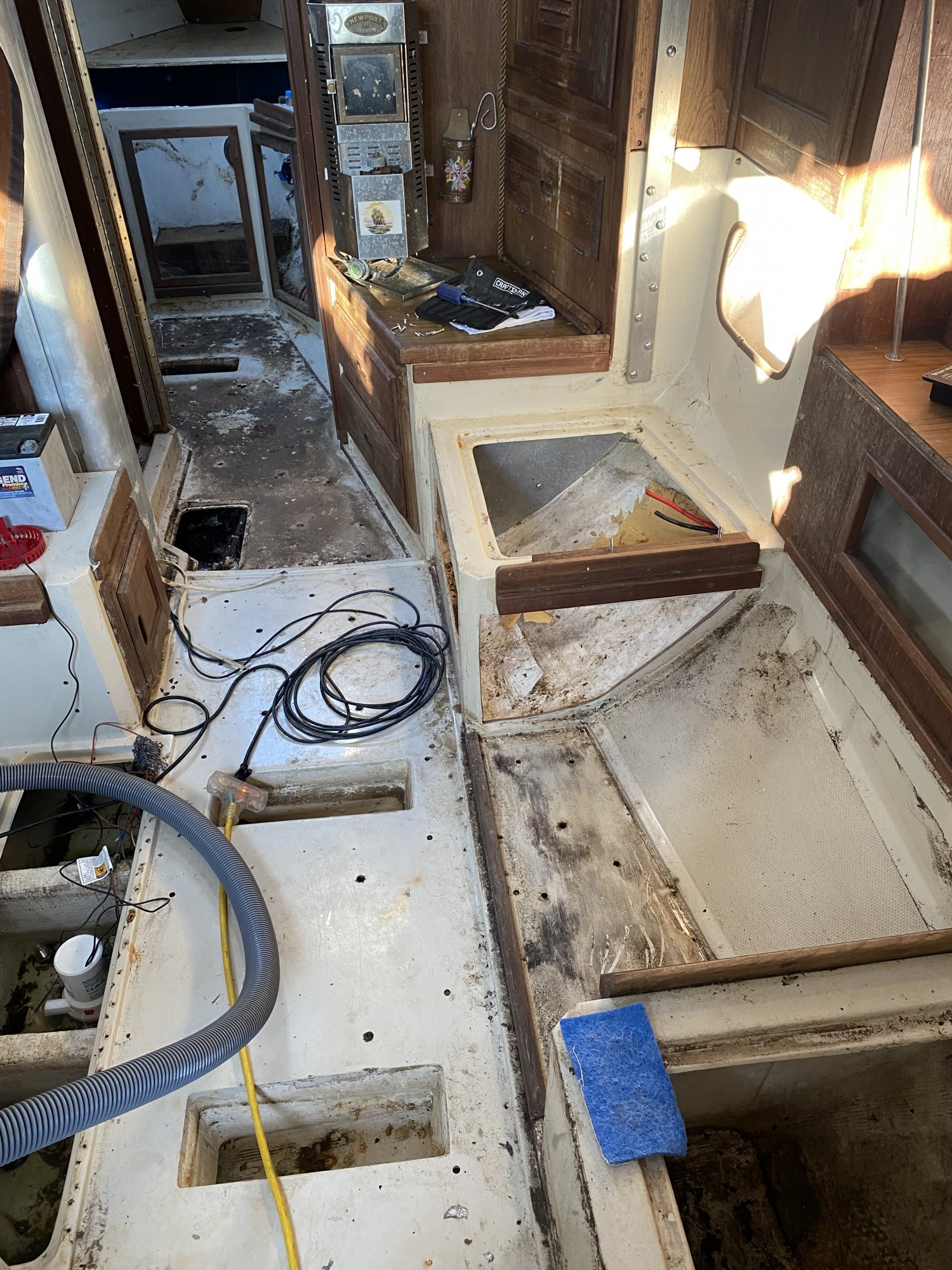

Now to Serenity. Todays goal was to remove the ply on the starboard settee and return that area to its original configuration, I also removed the flooring piece. Then remove the floor for the v-berth area and general cleaning in the forward spaces. Well I got the water and mud out of the head, I’m thinking that mud and all the mud I have found is made of mostly dog poo. It smells horrible. After the sole came up, there was more mud underneath and I got out the scrubby pad and Simple Green and went to work. The after pic of the v-berth floor didn’t turn out so I will have to get another one of those later but you can see the mess I started with. Oh, and the crap and debris under the bed got vacuumed out for the most part. I didn’t get a chance to scrub there but that’s going to be soon. Enjoy the pics.
Here is how the day started… after the removal of the decking at least.

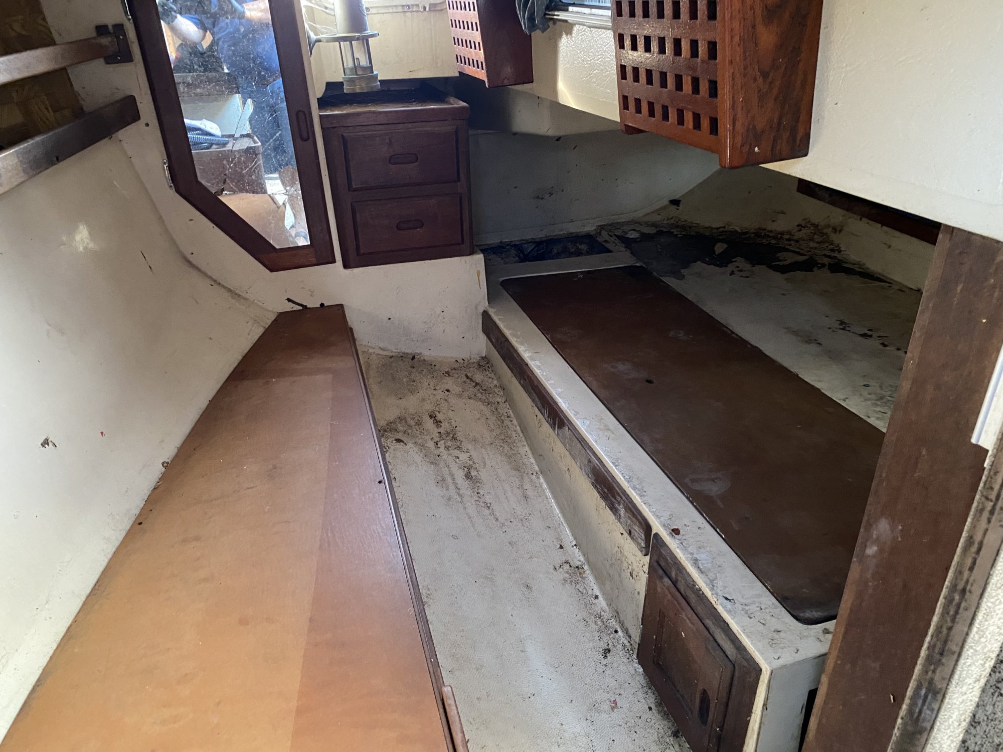

Here is the pic of the settee area, there was barely enough light to get this pic. look how much better it’s getting already.

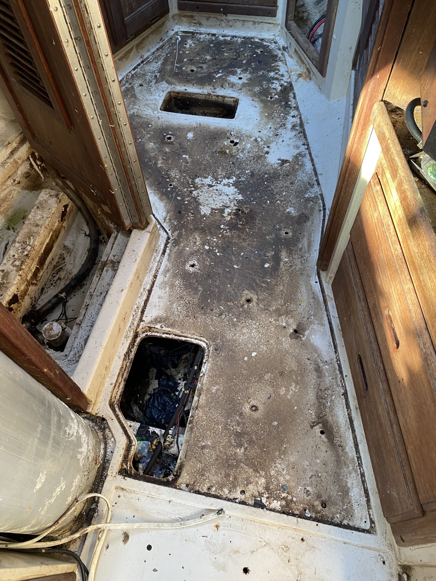

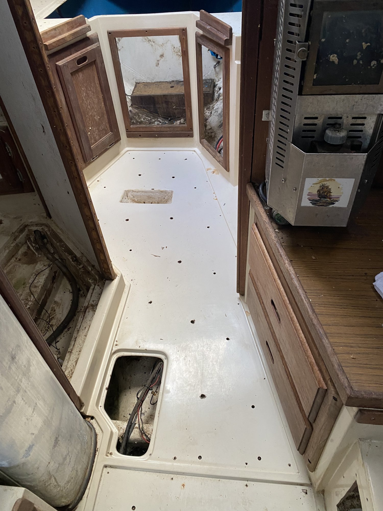

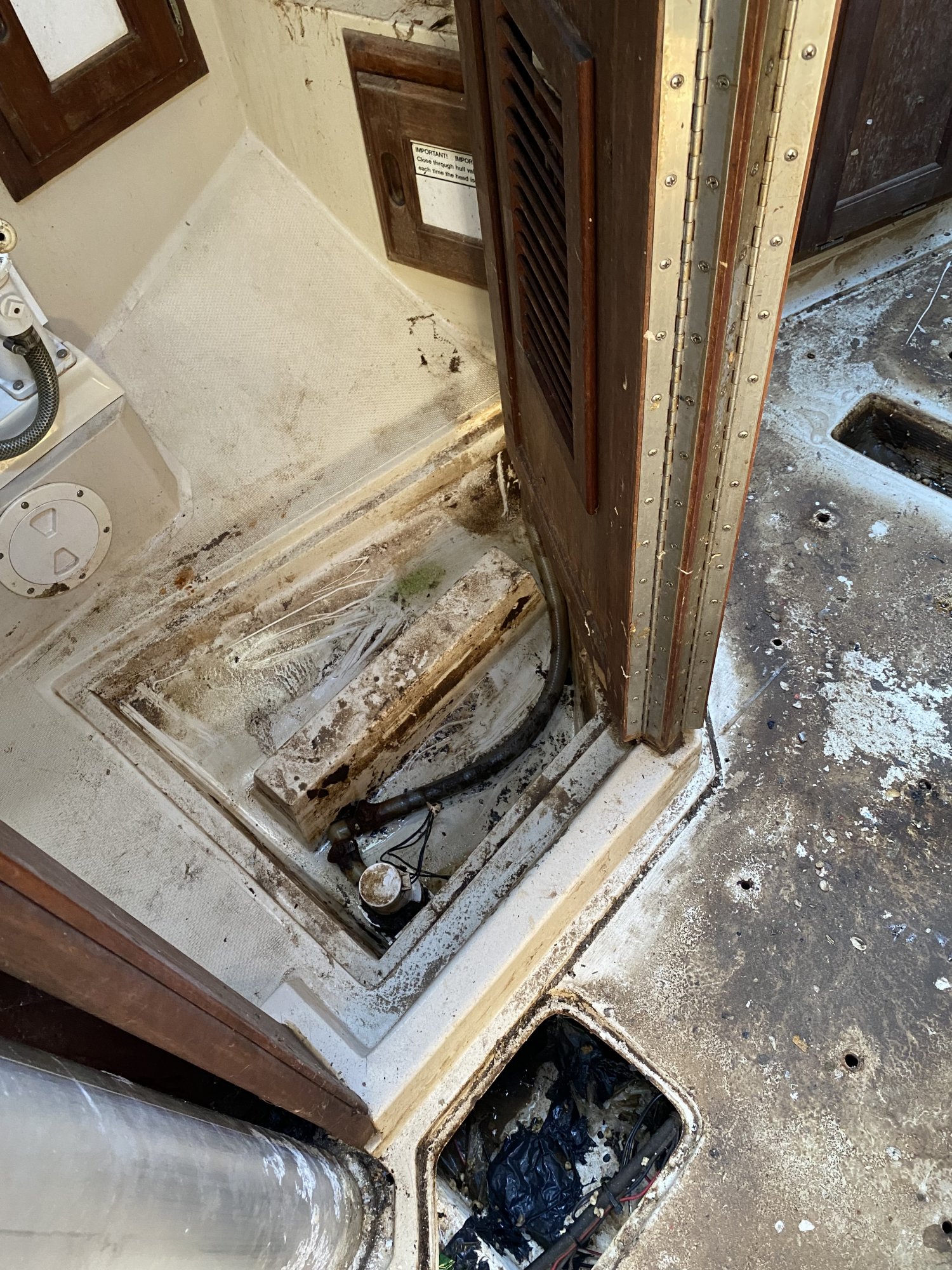

Here is a pic of how good the floor in the v-berth is. I didn’t really do much to the boat today just removed the doors to the head and forward berth for refinishing and also removed some of the messed up fittings from the previous owners. Nothing really picture worthy other than the floor I missed last time.
