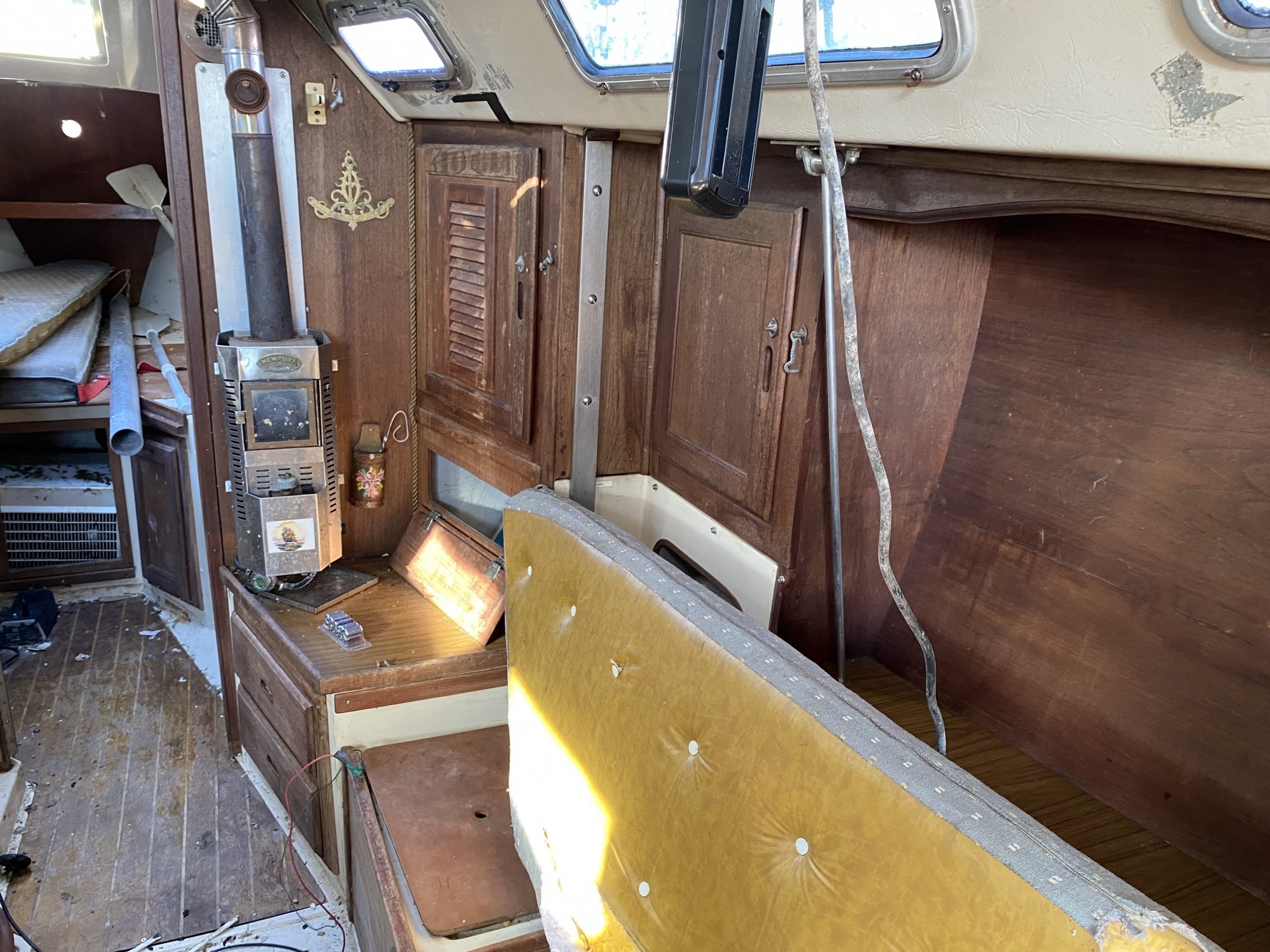

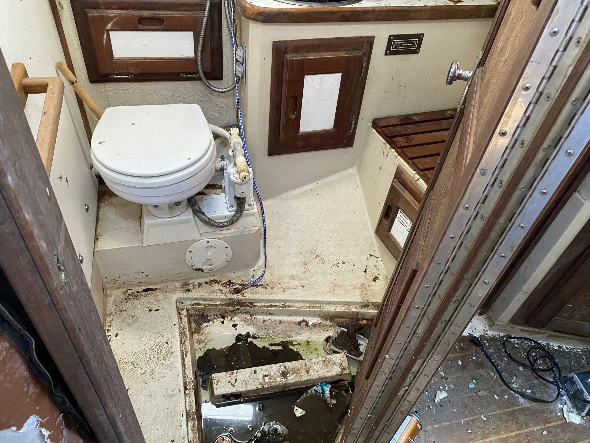

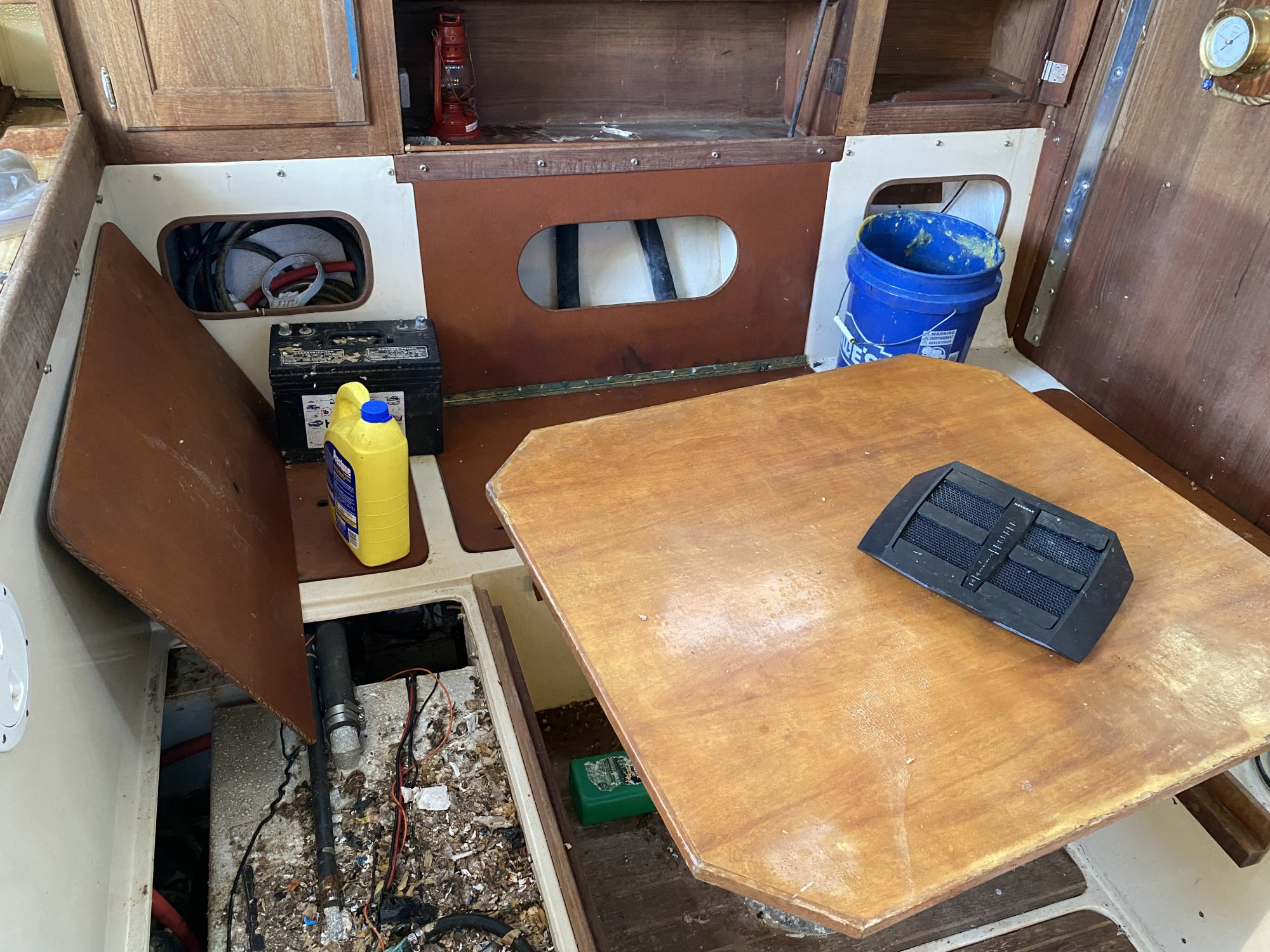

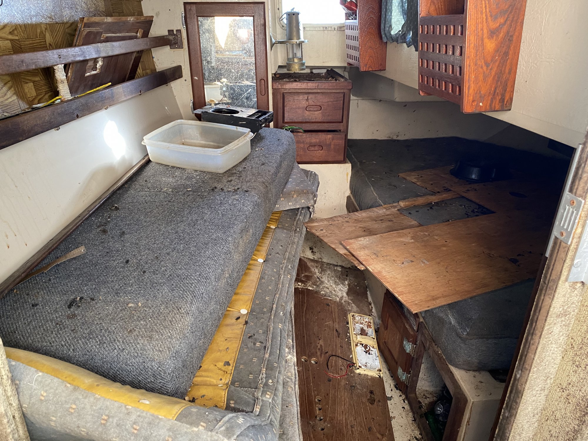

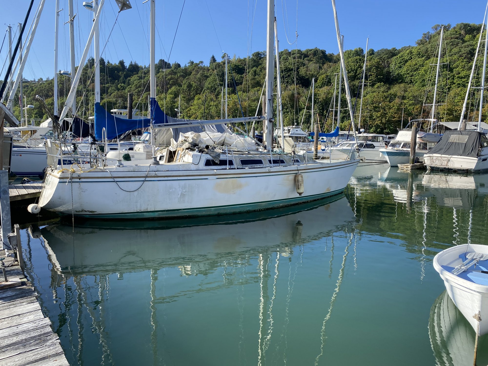

here are a few pics I took today, to give you all an Idea of what I’m up against… and you haven’t even seen in all the cubbies yet!
Outside, not great but not bad.
From the companionway.

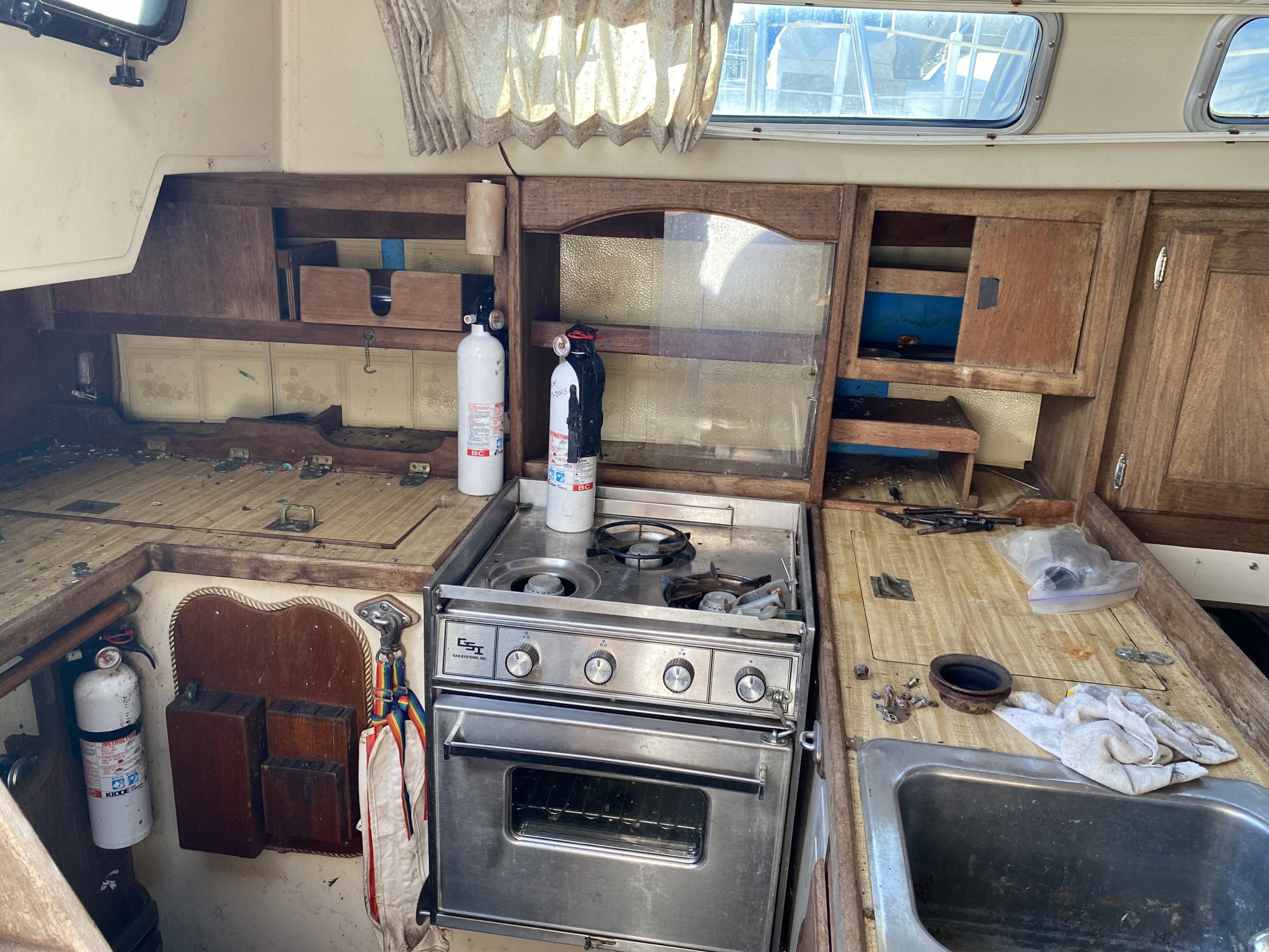

Galley.

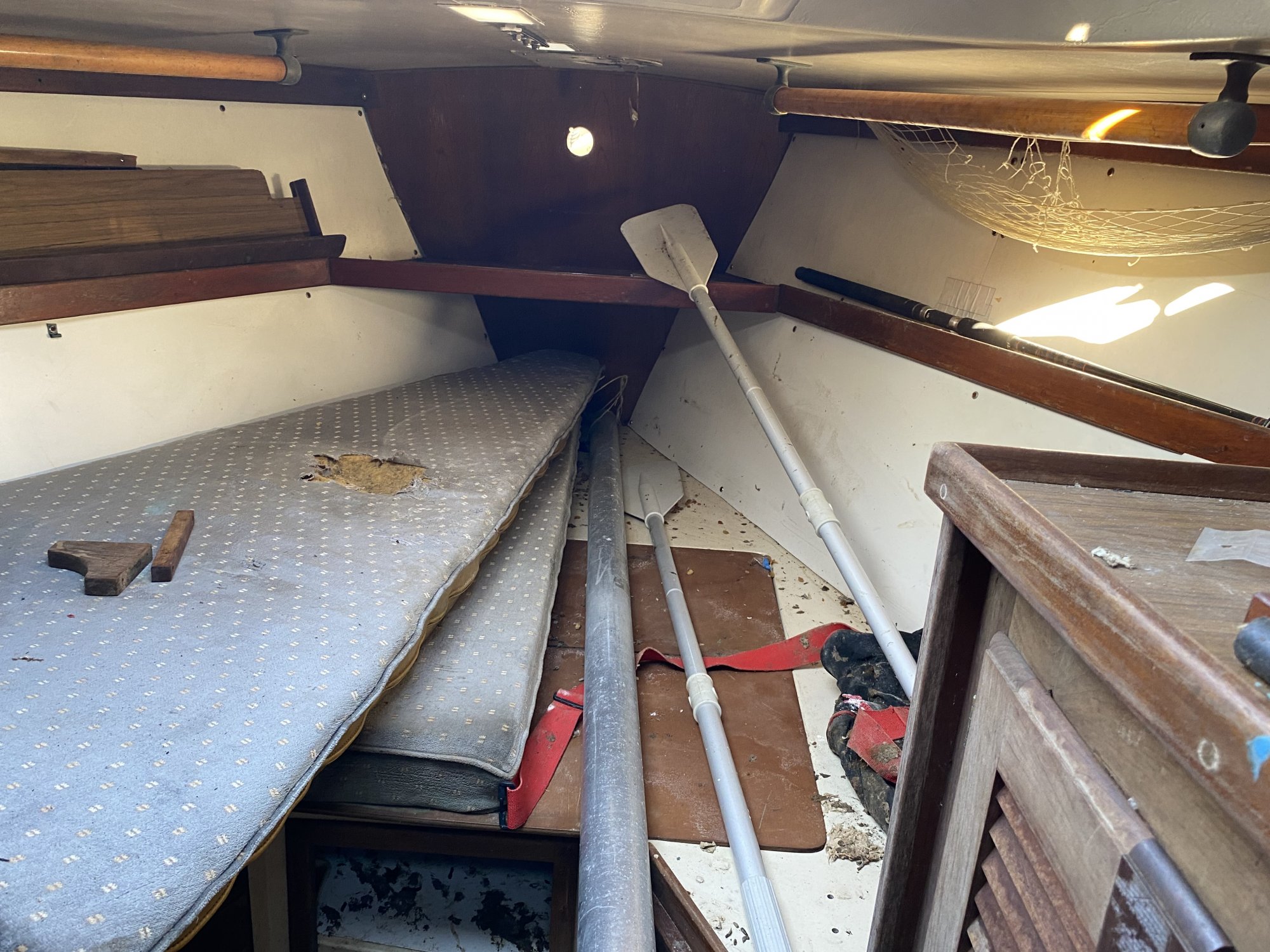

Aft berthing.

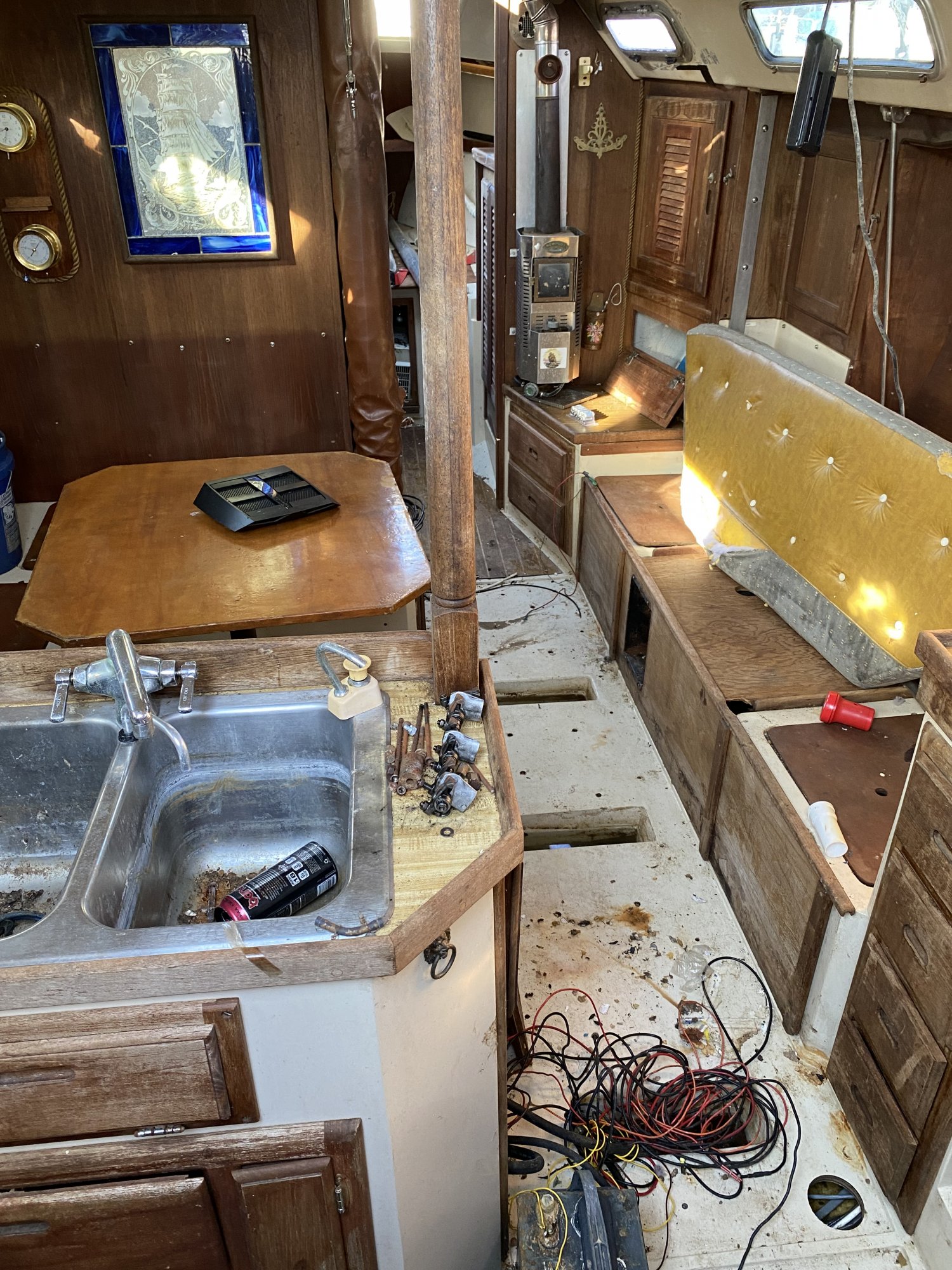

Galley Table.
Well it has a small heater… not sure if it works or not…
Head, and yes I found the floor piece, it’s in pretty good but not perfect condition.
Vee Berth, and most lik where the critters are.

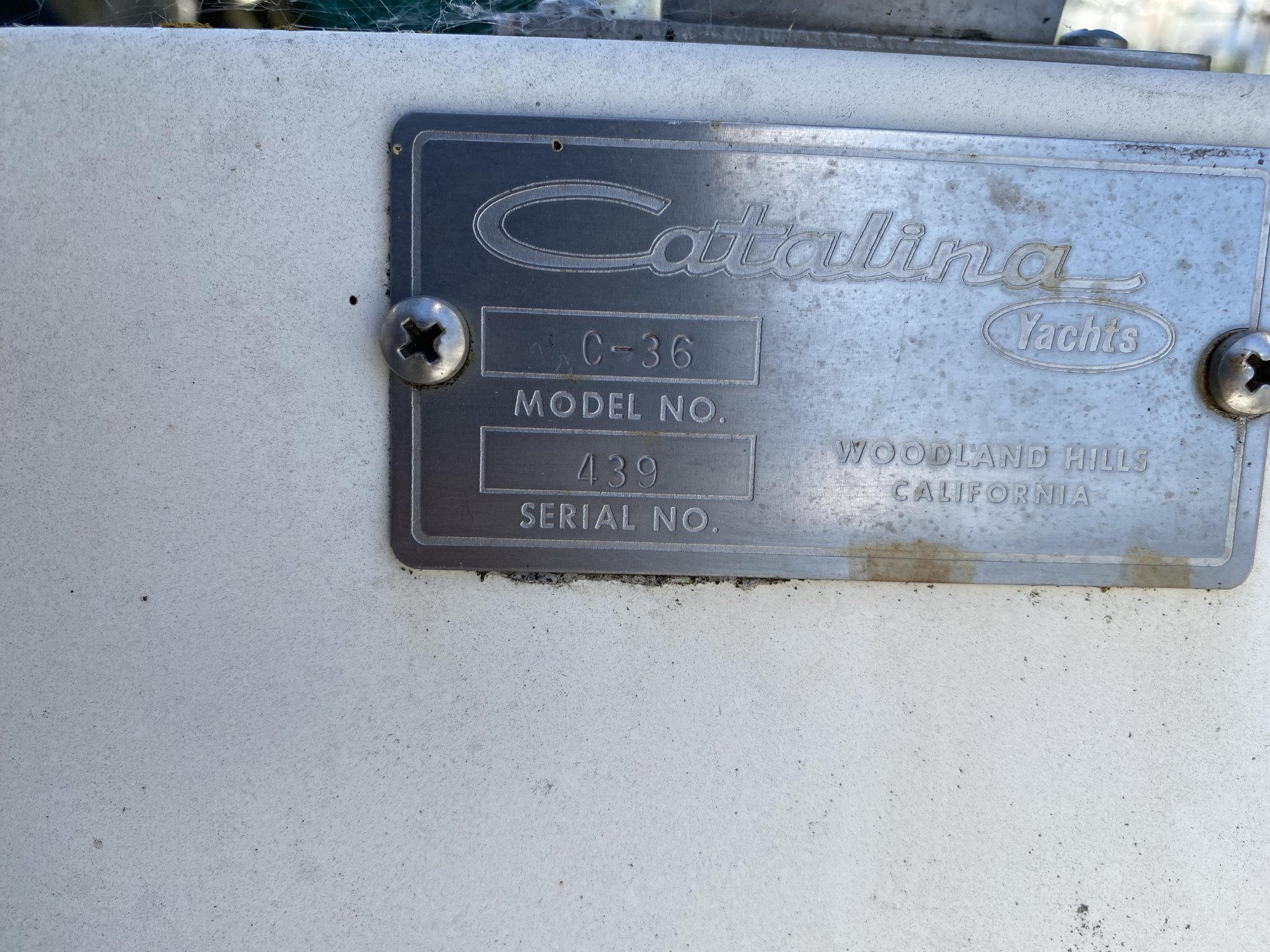

And my data plaque it’s a 1985 and hull number 439.

Well, the outside doesn't look nearly as bad as Luna was when you started. I suspect that the interior will more than make up for that difference. :facepalm:

I see that they left the rocker arms and pushrods next to the gallley sink! Ya gotta wonder where they took the head..
The head was in the marina office for a while, it had bent valves, but no one knows where it is today. One of the pushrods is bent as well. I hope it didn’t scrap the cam, as that is one part that doesn’t seem easy to find new.

I see she has a Raritan head, and. Dickinson heater, so some things are worth salvaging ;-)
The wiring looks like a challenge though.:facepalm:
Greg
Nothing I haven’t tackled before. With Luna I tore out every bit of wiring that wasn’t embedded in fiberglass, and completely rewired her both AC and DC.
