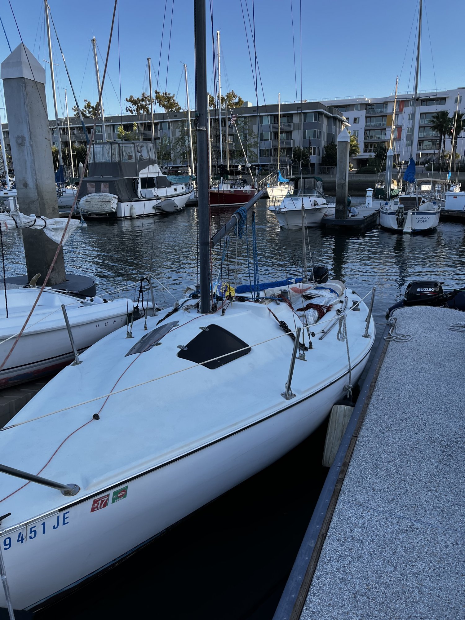

Hi everyone, I have a 20 ft Schock Santana that I bought to support a charity for young sailors. It's in good shape except the motor bracket has damaged the stern where it is mounted giving it a flex that should not be there. There are two things stopping me from reinforcing the stern from the inside: 1. It will be hard to reach without cutting access panels 2. The boat will be used by several youngsters who will not be able to reach over the stern to pull start my 3.5 hp outboard anyway. So I was thinking electric and wondering if anyone has experience with something like a Minn Kota 55 lb thrust motor? I see a Newport with 86 lbs of thrust for around $400 on Amazon. I already have a couple of dc 27 batteries which they could be mounted in the bilge and cabled to reach the motor. The boat has a displacement of around 1400 lbs. The motor will be used to motor in and out of the dock to reach the main channel about 400 yards away. The boat has a 30 amp shore power hookup so recharging will be easy. I don't have the budget for one of the Spirit motors and am wondering if a trolling motor would work. I have no experience with them.
