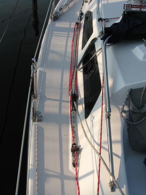

After using the system for a whole season I really do like it. I pay a whole lot more attention to car position and sail trim (could be I am just starting to learn sail trim a lot more too). When pointing the cars definitely adjust themselves aft due to the force of the sheets. When running them forward for a downwind run they also help. Shell's advice was top notch; glad I listened and did not over engineer.

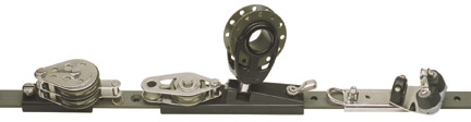

Hmmm, maybe I do need pictures
Here is a factory picture. I will get some pictures of them on the boat.

It will fit the existing OEM track. All you have to do is pull off the end trim piece. They will send it to you on a short piece of track, just line them up, and slide it on.
There have been a few discussion about folks who did not follow this advise and the ball bearings fell out.
Valcour, In the picture it looks like you got the cam cleats for the end. Is that correct? I passed on them and so far have not needed them.

Yes I got the cam cleat option for a simple install. Where do you cleat yours?

Usually docking cleats on stern
I have thought about adding some cam cleats on my stern rail. The Garhauer cam cleat solution is pretty elegant, but on the Potomac you don't get to do a beam reach too often so when we do we so far have used the cleats on the stern. I did see an example set at the boat show where they had the lines looped through and brought around in a sort of continuous loop (now I wish I had gotten a picture of that). Biggest problem with that is when you are racing or in rough weather someone has to lean partially out of the cockpit to adjust them. If I use the stern rail it eliminates that problem.
