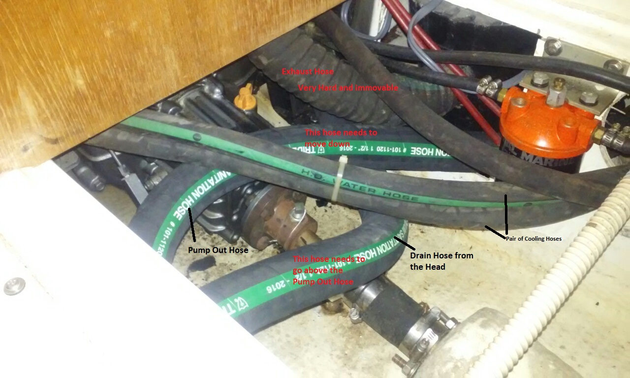

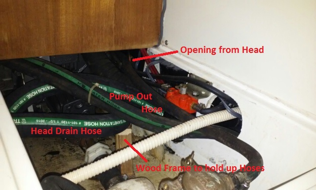

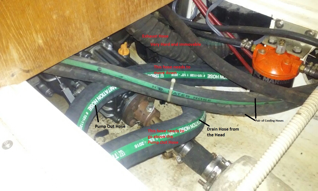

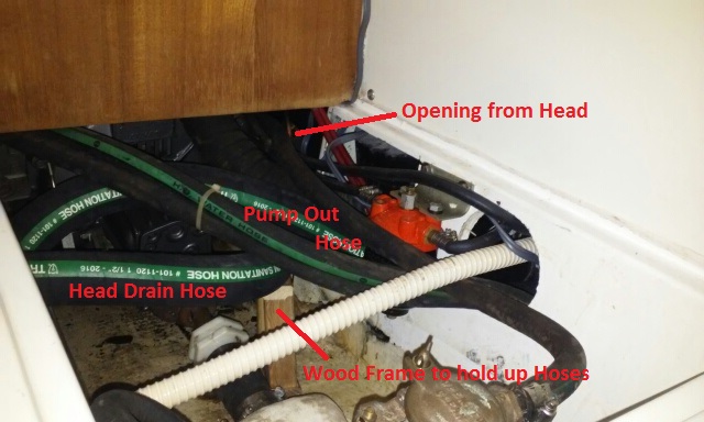

I'm looking some ideas. I installed new Trident hoses in my '88 Hunter 28.5 to get rid of the smell. The problem is that the drain hose from the head loops down and then back up, causing a lot of the water and waste to remain in the hose, thus, it would seem, promoting faster penetration. It would take a LOT of pumping to pass enough water to clean out the hose, if I even can. This is the way the hoses were originally.
Yesterday, I tried to disconnect the pump out hose and move it to be below the hose from the head, but because the exhaust hose is immovable, I can't get so that the drain line is above the pump out hose.
Incidentally, with the current setup, the drain line is NOT touching the prop shaft...
