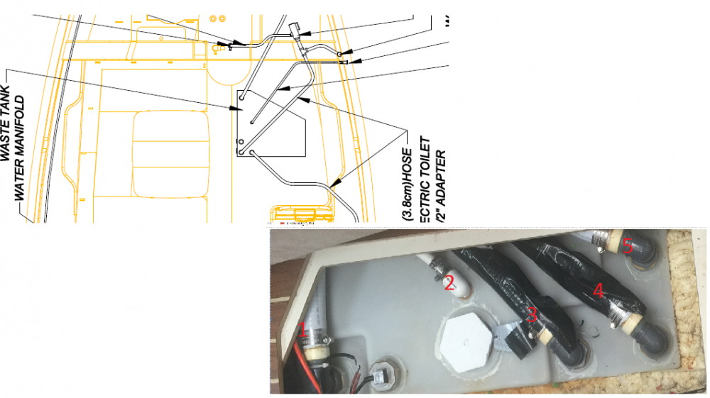

So I have been doing my planning and measuring and in the process I came across a 5th 1 1/2 hose and have know clue what it is for or where it runs too. I attached a picture and guidance much appreciated

It appears that the tank has TWO discharge ports--one with a line going directly to the deck pumpout fitting, the other going directly to an overboard discharge pump and thru-hull. Both will have pickup tubes going to the bottom inside the tank (trying figure out why they'd both be wrapped in black plastic sheeting). But I'll be darned if I can figure out what the 5th hose is for... UNLESS it's the inlet for a second toilet or an inlet hose for gray water. If that's what it is, it shouldn't be because USCG regs prohibit combine gray and black water in the same tank due to the risk of harmful bacteria from sewage migrating into the sinks.

There are two heads, deck pump out discharge and macerator discharge plus the vent so 5 hoses.

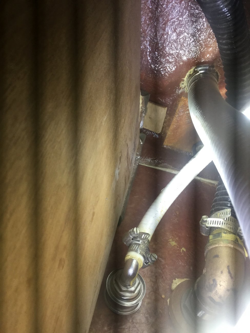

HELP. I am two thirds the way into replacing the sanitation hoses. Everything has been going smoothly till I got to the pump out hose, the hose clamps are so high up I am having issues reaching them to in screw them. Tried a macgyver by adding some length to my ratchet but not effective. Anyone have this issue. Picture of the hose attached to the deck fitting as you can see it is way up there in a tight spot

Problem could have been avoided if you'd turned the clamps around to put the slot on the other side of the hose before you put the hose onto the fitting (I know..."NOW you tell me!"). If you can loosen the top one enough to rotate it to the left a bit, you can prob'ly get a 90 degree screwdriver into it. If not, can you move the black corrugated hose out of the way enough to get a 90 degree screwdriver into it? Maybe reach behind it? I can't see the screw on the bottom one enough to have any ideas, but if you can tighten one clamp, it should be ok on a pumpout fitting.

Hi Peggy thanks for the quick reaponse. The issue is actually the manufacture ( hunter )did it when they built the boat . I am still trying figure a way to get them off and a plan to putting on the new hose and clamps . I have very long arms, per my wife and the fitting is at the top of my each. Kind of worried I will not be able to put the new hose on if I take the old off. Expertise welcome

Go into the salon and take off the screws holding on the handrail and trim that cover the underside of the jib cars. You only have to take off enough to be able to pull down and get a socket on a long extension onto the hose clamps. At least one other person helping is very handy at this point. Hunter did not think about the replacement of these items.

Unfortunately Peggy you can't even touch what he's looking at. The reach from inside the forward hanging locker to the deck is impossible. There is the need for some other disassembly. The manufacturer never thinks beyond the warranty period for removing and replacing parts.

You are the man I totally missed that little gap. Used a old plumber trick to get the clamps off cut the pipe with a dremel then cleaned it up from inside the opening right up to the deck fitting. Then a little work loosening just enough to pull off. Thanks again for the tips you just saved me a day of figuring!

O and then took the deck fitting off so I can make sure I can get the hose on tight. Reseated the fitting with 4000 pushed the hose clamp in place and used your trick. Working like a champ
