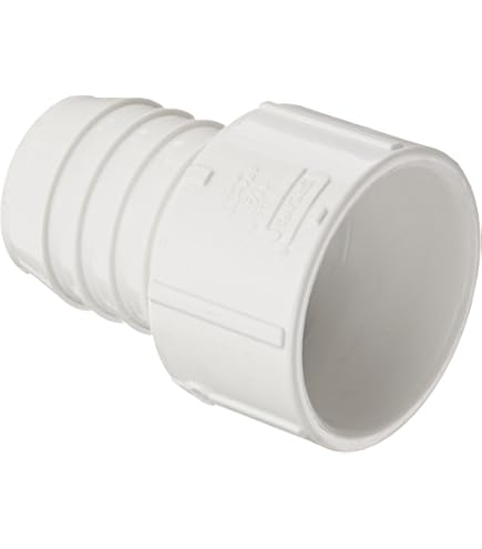

Anywhere you can use PVC pipe, you will be better off than hose. If you have straight runs, make it PVC. You can get PVC pipe to hose barbs for transitions. Don't use 90* elbows, but if you can make turns with 30-45* elbows, or a couple of them in series, then use those. If you have runs that you can't get pipe into, then use couplers on shorter sections.
You need to "soft couple" pvc pipe to anything rigid (toilet, tank, thru-hull etc) using about a foot of hose to have a connection that won't leak. Hard pipe couplers will.
That is one of the purposes of the pipe-barb couplers in a run. Use PVC pipe everywhere you can, and couple in short pieces of hose where you cannot.
