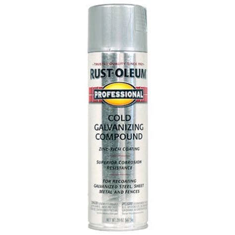

Use Rustoleum Cold Galvanize spray. Same stuff as the Pettit Barnacle Barrier except very much less expensive. $10 for 20 oz vs Pettit $30+ for 16oz.
