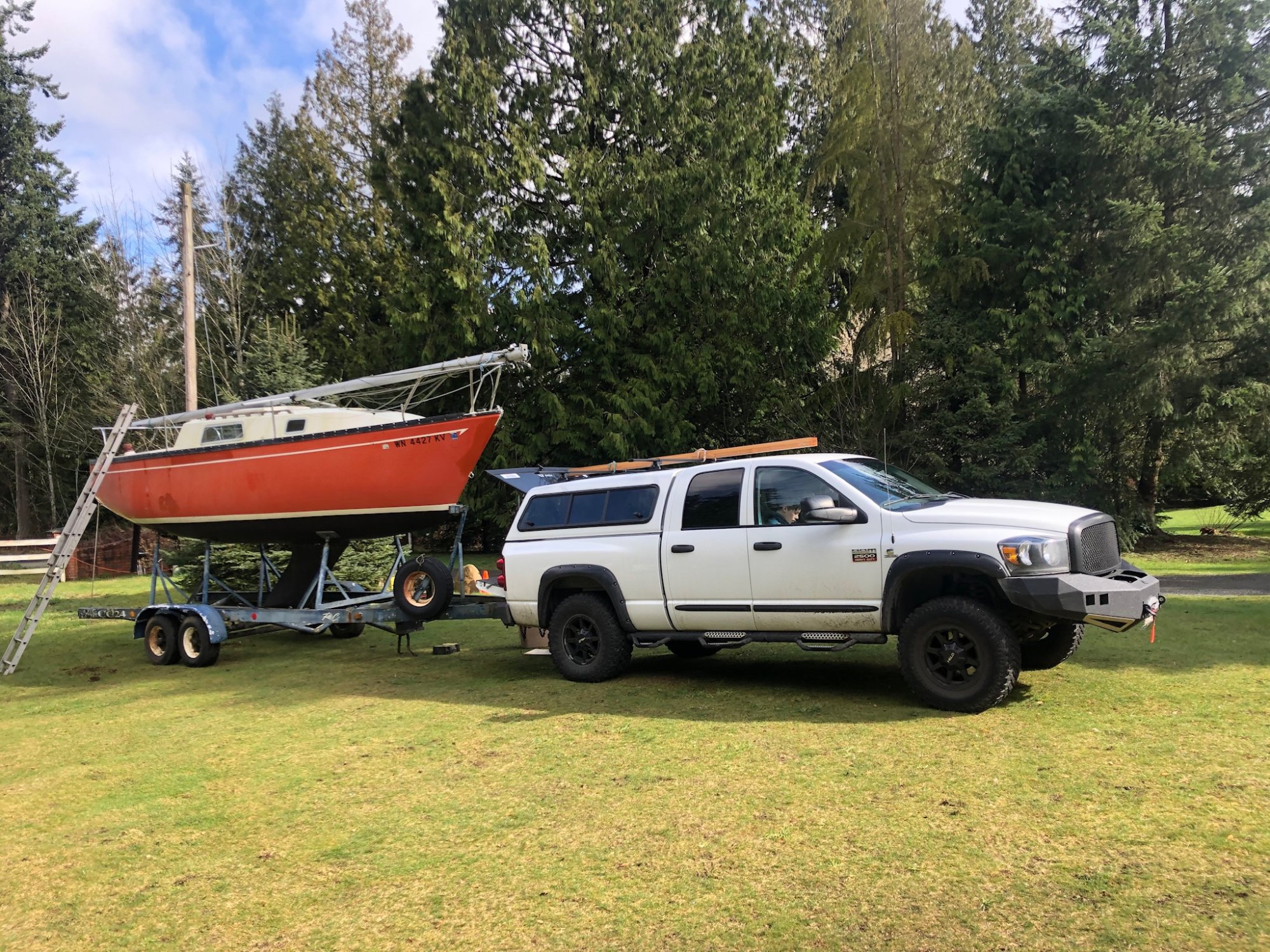

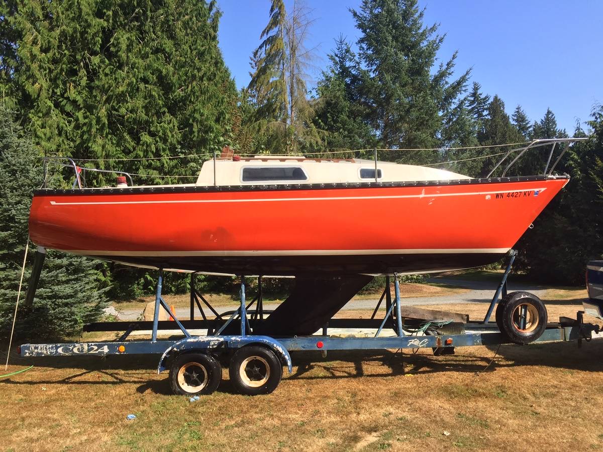

Here are the pics from finding her for sale, and hooking her up the first time to my rig. Managed to get home safely, and am now getting ready to give her a thorough work over.
Haven‘t stepped the mast yet, but that’s going to be my first project now that I’ve got her in my yard. Make sure all the standing and running rigging’s good, Then verify all the through hull fittings, see if I can get the motor on line, then its gonna be straight into the drink.
Ill be looking for friends out there in the Sound.
