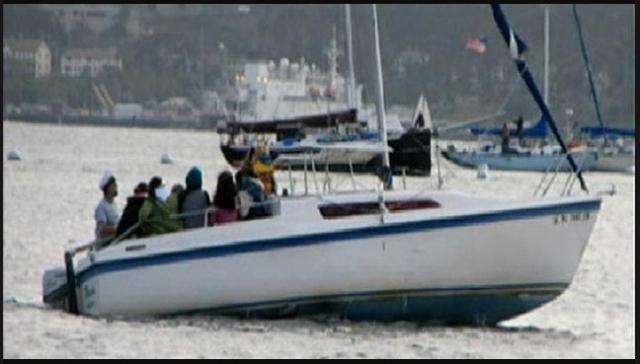

I know there has been a lot of discussion on this sad subject. Attached is a photo taken just prior to the boat flipping which resulted in the deaths of two persons. You have to ask yourself, would you take your boat out loaded like this? Full keel, swing keel, water ballast, cabin cruiser, trawler, O'Day, Hunter, Catalina, MacGregor, Chris-Craft, Baylinner, etc....., clearly overloaded. I've seen fairly big cabin cruisers on San Diego Bay loaded with a bunch of party-people, and they all like to hang out on the forward deck. I've seen 45'-60' boats in this situation where you could clearly see the rudders. Even the Queen Mary almost rolled during WW-II while crossing the Atlantic. She was so overloaded with solders they believe she came with a couple degrees of rolling while in a storm. Anyboat can flip, the captain is ultimately responsible for the safety of their passengers.

The weight is not the problem here....it's the distribution. Looks like 8 to 10 people onboard, figure 2000lbs. If these folks were properly distributed throughout the boat I'm quite sure it would not have flipped. The skipper must surely be an idiot for allowing, first that number, and secondly them all to be sitting together.

Was that boat sailing when it capsized, or with they out for a motor?

It doesn't look as though the water ballast was in by the way it is sitting in the picture. I use town an M and without the ballast it wasn't the most stable boat, and with that many people in it, Yikes

Not that it makes a big difference, I believe that picture was actually taken the day before the accident. The "skipper" routinely overloaded the boat. IMO

Actually, the photo was reportedly taken minutes before the accident. The people were on a kyak and couldn't believe what they saw and took the picture. The picture shows they were motoring, however one report I read stated only the jib was up and a wind gust hit the boat. I don't know how you could sail with the jib with that many people in the cockpit. I know with only 4 in our cockpit makes getting to the winches a bit of a job. So I like to have someone standing in the cabin to make room in the cockpit, and have additional weight forward.

Whats up? If someone had just sent me this picture and asked what I thought was going on without adding any details? I would make a guess that some guy had his whole family out for for a swim/float and every body went to starboard so the kids could swing on the boom out to port.(maybe with added comments about traffic,life vests,rigging & boat overload) Does it look like that to anybody else or is it just me? (am understanding a previous day)

I guess that could be, except that the water temp. is about 55 degrees, and no one is in swimming suits that I can see, and the photo was taken by reportedly eye witnesses. Let's say it was the previous day.....still poor judgement. Don't get me wrong, I don't want to get into MAC bashing, thats not the point. It makes no difference if it was a sailboat, or powerboat,(Lord knows we've seen plenty of overloaded bow-riders and fishing boats), it was just poor judgement, and very sad.

actually I meant to write(without adding any details) When you blow up the picture what does it look like they are doing to you? At the time I first saw this pic news reports were still unconfirmed as to; was this a sailboat or not and 25' or 35"or not. There was an interview and a statement from the picture taker having regretted not reporting it to the authorities when taken a previous day. About that picture, several questions popped into my mind. doing what? photo shop? actual time/date? only one pic? and more.

What I can't figure out is this: The boat is clearly heeling to port, but there are clearly at least four people sitting on the starboard side, which means about half the weight is on that side, no?

if you look close at the pic you will also see that the bow is to high for just motoring in the area they are in so my guess is that pic was taken just before it wet bottoms up...prolly in a port turn under power and they way it was loaded it was easy to flip upside down

To me, it doesn't look like that picture was taken from the level of a kayak. Another website had a quote from the guy that took that picture. He said it was taken the day before. He was on a boat.

What strikes me about this picture when I put it in context with my own experiences is how much of the bottom I can see. He must have forgotten to fill the ballast tank. If each person had an average weight of 150# then he just added 1500# to the total weight. You should not be able to see bottom paint with a boat that overloaded unless .....

As a naval architect with 40 years experience doing trim and stability calculations, I would have to say that, unless the camera caught it in some instant of strange heeling, pitching, and heaving, I 100% agree with you.
10 people at 160 lbs average weight would put a boat this size about 3 inches below the waterline she was floating at before they boarded. Their weight being aft of amidships would cause the bow to go up and the stern to go down by about equal amounts. If you mentally heel that boat back level in the picture, the painted waterline would be about at the actual waterline. It this picture is a true reflection of her actual trim and flotation at the time of the accident, either her waterline was painted very high (which it doesn't look like), or the ballast tank was not filled.

Just as a point of interest; does this particular boat type actually have a water ballast tank? I doubt that full or empty it would have made much difference with all that weight aft.
I believe that the boat as pictured is crossing a wake. If you look aft....

First, I thought this subject was beat to death in the first go round and now it seems as if it is an entirely new subject ! Oh well, you got me back in! This boat is a water ballast boat and it has been pretty clearly established that there was no (or not nearly enough) water in it from the beginning.
I finally went to Heart of Sailing website and looked at many of the pictures in their album from both Dana Point and San Diego over the past couple years, and see that this is by no means a first time for this many people to be aboard this small exact boat. There are picture after picture of 7-8 and some with 9 people on it, in every assortment of size (lots of small children) and most are of the adults with no life vests on. I am sure there have been many conversations in the past week as these folks realized that "there but by the grace of God...."
A wake was mentioned......., and those are always present on the bay... but as they were possibly still plucking people from the water, or very close to... not only a huge Cruise ship went past in the fairly tight spot all of this took place, but a Car Carrier went by as well....... we heard the 5 horns and just cringed.

And the Pop Top is open which makes it that much easier to fill the cabin with water if there is a capsize. For a supposedly experienced sailor he made a lot of mistakes.

Look at the flag in the background. I believe part of this heel was due to windage; Mast, furled head sail, boom, poptop, people. Lots of windage.
The wave at the stern appears to be from the boat itself which is more pronounced from all the weight in the cockpit.

The pop top being open also adds a lot of weight high up on the boat. I have a Mac 26. I've never taken it away from the dock without the water ballast full. I've had maybe 9 or 10 people on it before, but half of them were young kids, and some were always below.
