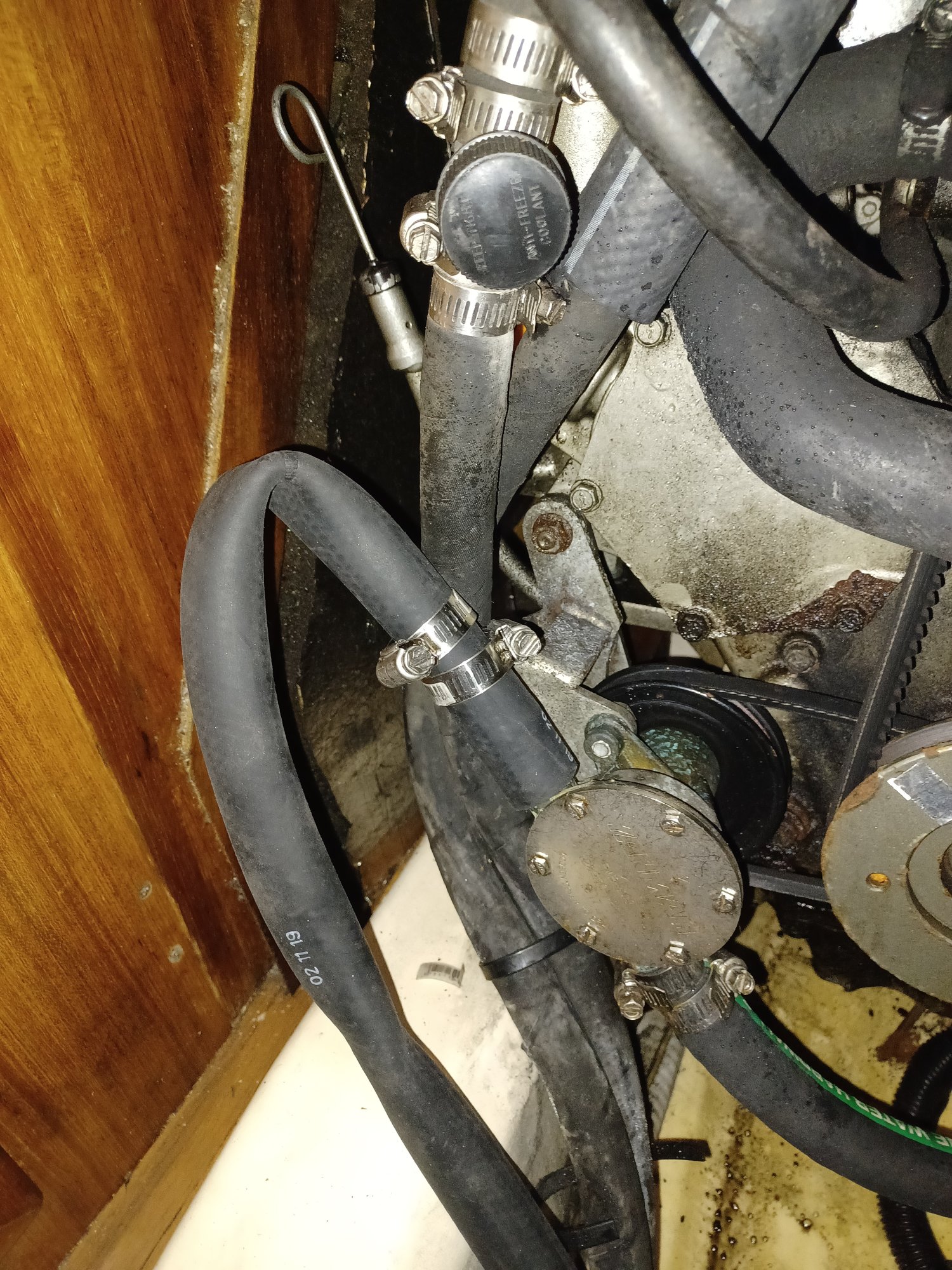

What hose should I be using to connect seawater strainer to engine? I tried 3/4" 80psi heater hose but configuration of inlet to engine is such that I need to do a 180o bend in a small space and hose crimps and seems likely to impede flow of water to engine.
23,028
That hose leaves the pump and does down. To Where?
Perhaps a picture that shows where the hose goes.
A hose with a wire will allow a gradual bend and keep the hose open.

An angled hose barb at the pump would reduce the required bend, but that leads me to another question. That tight hose loop looks like something may be missing. It’s hard to tell from the photo, but is there a sea strainer out of view or does that hose go direct from the seacock to the pump with no strainer? A hose up to a bulkhead mounted sea strainer and then down to the pump would coincidentally eliminate the tight hose bend you have now.

The strainer is located next to the thru hull fitting in the center of the boat, about 5' away. The original hose was corrugated to allow the 180o turn. Ordinary wire- and non-reinforced hose at 3/4 will crimp without the corrugated wire rings because of the 180o bend (already tried). I, too, have discovered Trident and Shields produce this product, but it is not available anywhere on the market it seems in 3/4" diameter (larger diameters no problem). The access to the engine on the Hunter 33 is *very* restricted; in the front of the engine where the hose is located there is IMO no room to attach a hose with large bend (or strainer) because of the way the stairs connect to the deck and bulkheads. i have two more suppliers , whom will (hopefully) get back to me today. Failing that, it seems given space issues and the crimping caused by noncorrugated hose, perhaps the 180o elbow proposed by Richard19068 may be the most effective solution. Quite frustrating situation.

Unfortunately, words do not convey the information that pictures do. With a few routing changes, this will not be complicated.
DO NOT mount heavy brass fittings on this hose. They are unsupported and swinging loose. If you hit the harmonic vibration of the hose and fitting as a unit (often at idle), they will swing wildly and you can imagine the rest.
Please take numerous pictures showing as much detail as possible. Help us to help you.

Good. Glad there is a strainer. I couldn’t tell from the photo. That takes me back to thinking that a 45° or 90° angled hose barb on the inlet side of the pump would take out much of the required hose bend.

The Trident hose that I referenced in my reply above will take a 180 degree bend without collapsing. I've tried it and it will. The application in question is below the waterline and this reinforced hose is designed for that purpose. I question whether the original corrugated hose was reinforced and designed for below the waterline applications.

Thanks! I contacted SeaStarSolutions (Dometic) and they now sell this SeaStar Solutions, which is designed for below the waterline applications and they guarantee a 180o turn in 4 inches(!) It replaces their 252 series hose. I got it at www.go2marine.com, although it seems to be available in a couple other locations. I had issues with the SKU and images provided by those places so stayed with go2marine. I will report back my success or folly here in probably a week .... I so appreciate all the advice from everyone. This is a generous group.
