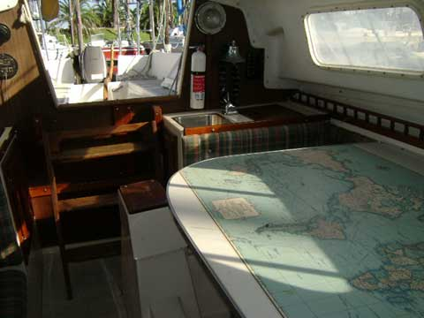

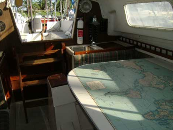

12,953
I used to own a Balboa 26, and they all came with a table topped with a world map under varnish (see photo). I always thought it looked great.
I’d planned to rebuild the table and swap the map for a nautical chart of my usual sailing area, but never got around to it. If I ever do make a new table, I’ll use a chart—maybe even top it with glass so I can mark it up with dry‑erase pens.

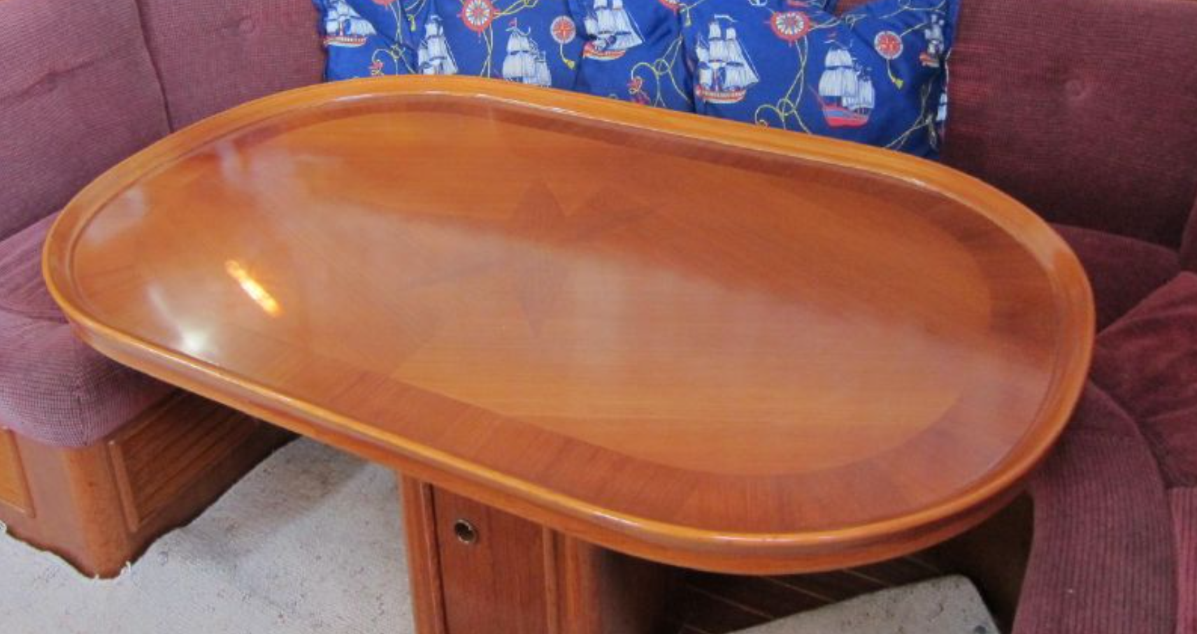

@Timm R Oday25 Here's a photo of my saloon table. Hard to see the detail, but the rosette in the middle is surrounded by 4 quadrants of wood with the grain structure aligned on a diagonal, then the outer oval composed of multiple small sections, you can see some of that in the near corners. Then the outside band of wood that also serves as a fiddle.
I didn't make this - it came with the boat...

Wow , both the idea of a nautical chart and DLj' s table are the type of inspiration I was hoping to find here .

@rgranger . That is mind boggling. I have got to get to work on that with a brand new unfolded chart of our local sailing area, placed under 1/4" tempered glass with rough ground edges.

12,953
PLEASE... take picutes and notes as you build this and post it. I'm going to do this someday.

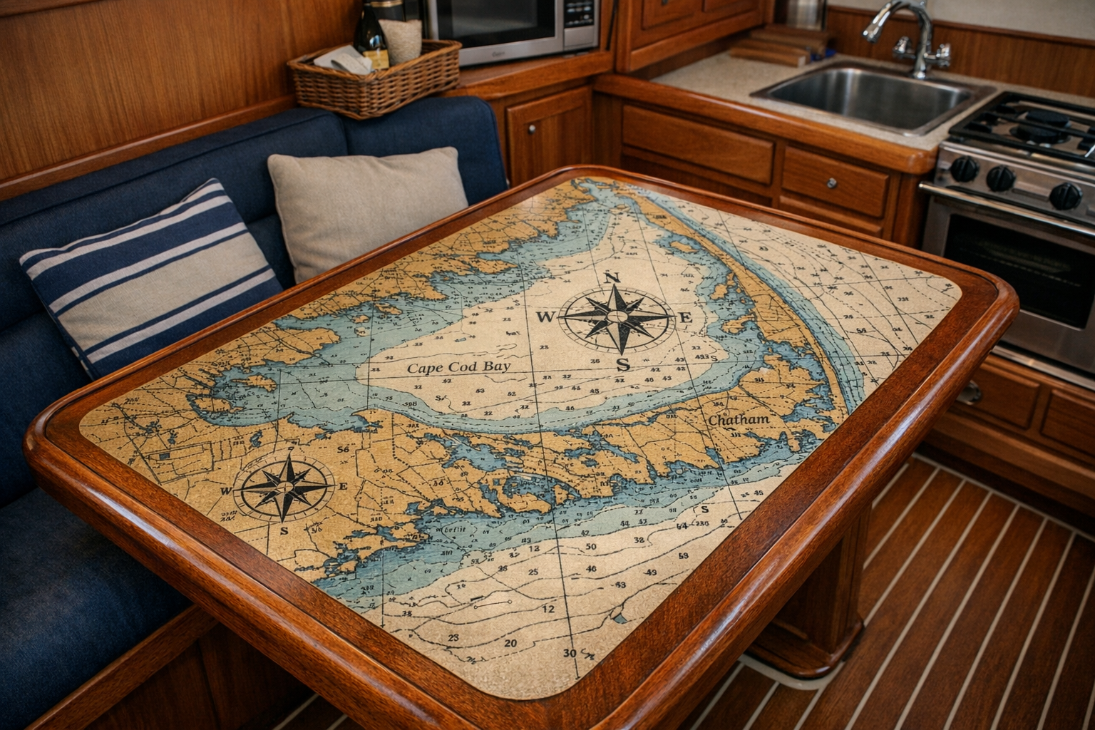

I was thinking that if I used a wooden surface, it might look nice to artificially "antique" the chart by soaking it in tea to brown the paper first. Then the color palette would match. I would have to iron the chart back out to get it smooth again but that is not hard.
This is what AI came up with...I think that it would look a little more "salty" if the white paper areas were slightly browned/tan.
Jan 4, 2006
7,672
That is EXACTLY the sepia colour I would want. There is no way IMHO I would be wandering past that table saying "yanicewhatelseyougot?" the way I would if this were some super expensive inlaid table on a gin mill.
Now, if you could just ask your AI buddy how to seal the edges where the cover (be it glass, acrylic, or whatever) comes to an edge, I'd be all over this thing like a cheap suit.
Right now I've got a lot of other pots on the boat cooker and all of them are at the point of boiling over (aka. spring is almost here) but the first thing I've got to do with the proposed table is come up with a guaranteed edge which will not leak spilled liquid under the top cover material.
Once I come up with that, I will photo the construction to ad nauseum.
Damn, I can't stop going back to your picture repeatedly it's so appealing.
