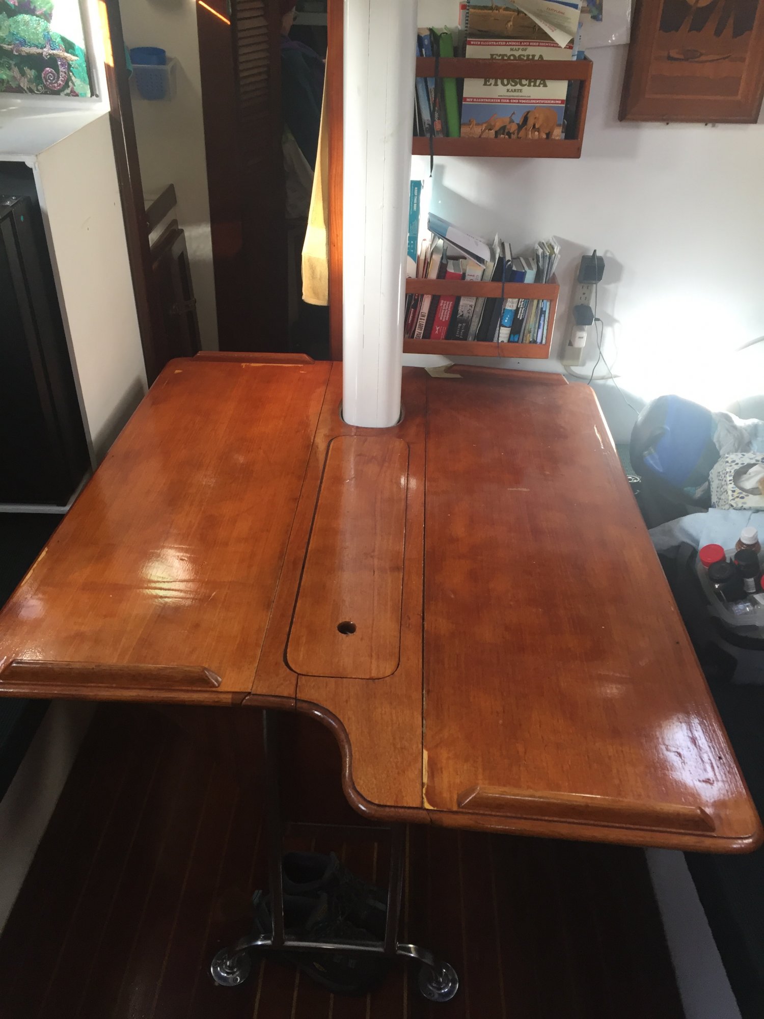

Something I did on my table was to cut a slot on the forward end of the table, basically turning the mast hole into a U-shaped cut out so that the table can be removed without pulling the mast!

If your are having a new table fabricated, I'm interested in replacing the center piece in my table. Over the years, this has gotten chipped up. The slot forward of the mast is very much recommended as my table has be split and doesn't look as good as it could when the table was removed without pulling the mast.

The original table is solid teak in the middle with teak veneer plywood for the flip ups. There is a compartment under a pull out in the center piece perfect for liquor. The edges of the flip ups are rounded, solid teak trim. All is easy to source. Fabrication requires a table saw and table router to fabricate the center piece. I've looked at the different approaches to allowing the table to be removed without removing the mast. The cut out forward of the mast is the best as it is not visible as you enter the cabin.
