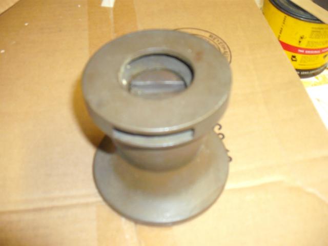

Do they look like this? This one is bronze from my '68 Islander there is a flat bronze handle with a wooden crank and a blade catch in it. But my handle is on the boat and not here.
The winches do look somewhat like this photo, although the center is not retracted as far as the one shown, but is flush with the top of the cylinder. I'll try again to use brute force to unscrew the nut. I'd love to see a picture of the winch handle. If you can post that I'd appreciate it.
