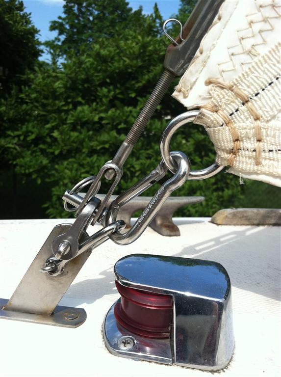

1. Does the forestay and jib shackles look okay? The po used the pin of the shackle to connect the forestay shackle to the chain plain. I added the cleavis pin and seperate long D ring for the jib connection. Photo 2.

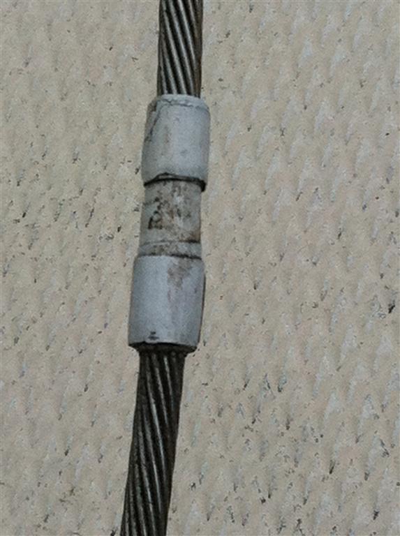

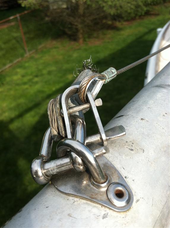

3. Is this a shroud repair? Photo 4.

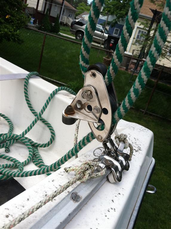

4. The clam cleat of the main sheet block shows some rust and sticks a bit. Is there a lubricant I can use? Photo 5.

Question #1 Those shackles on the forestay and jib may shake loose. If you use them put some ss wire through the hole in the end of the pin and around that leg of the shackle. Wrapping with wire like that is called "mousing" the shackle. It prevents the pins from comming out. Used on mooring or anchor shackles mostly. Question #3 (photo 4) I doube that is a repair, but who knows???? May be a reminant of a wind indicator. Question #4 (photo 5) WD or PB Blaster might help. You might not want to cleat the main sheet in most situations and certainly not if it might get stuck! Question #5 (photo 6) The hold down line is fine, but perhaps you can tighten the bolt at the pivot of the rudder blade. RE: photo 3 Nasty looking strands of cable there. Wrap them at least to protect hands and sails. There are some concerns about changing from line/wire to all line. Check other threads on these discussions.
Phil
PS The pin in the adjuster for the forestay & any others pins like it: Change that to a true kotter pin and wrap it or at least use a ring.

Mainsheet block: it's a CAM CLEAT, not a clam cleat. Check out the West Marine or Defender catalogs and learn the differences.
Instead of WD-40, but some PB Blaster, it's much much better than WD-40 and/or liquid Wrench but avoid getting it on rubber parts.
A little 3:1 oil also goes a long way. Get yourself a spray can or small tube of Super Lube, also great for keeping moving parts moving.
I wouldn't trust a carabiner for the tack of your jib. Also, do NOT use a standard shackle, they tend to come loose all by themselves. I'd try what's called a LONG "D" shackle on the tack, they also come with a 90 degree twist arrangement which could work for you in that situation. Take the clevis pin with the looped keeper and turn it around: have the flat end forward, with the ring keeper aft, that way if the ring lets go the pin might actually stay in place.

Get rid of the shackle for the forestay and pin the turnbuckle directly to the stem. Now you can get rid of the caribiner and shackle the jib tack directly to the lower stem hole.
The forestay is too short if you have the turnbuckle extended so far.... take the hitch pin out of the turnbuckle shaft. Use a cotter pin, or ring, then tape over to avoid scratching.
The bow light should be in front of the forestay.

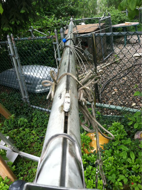

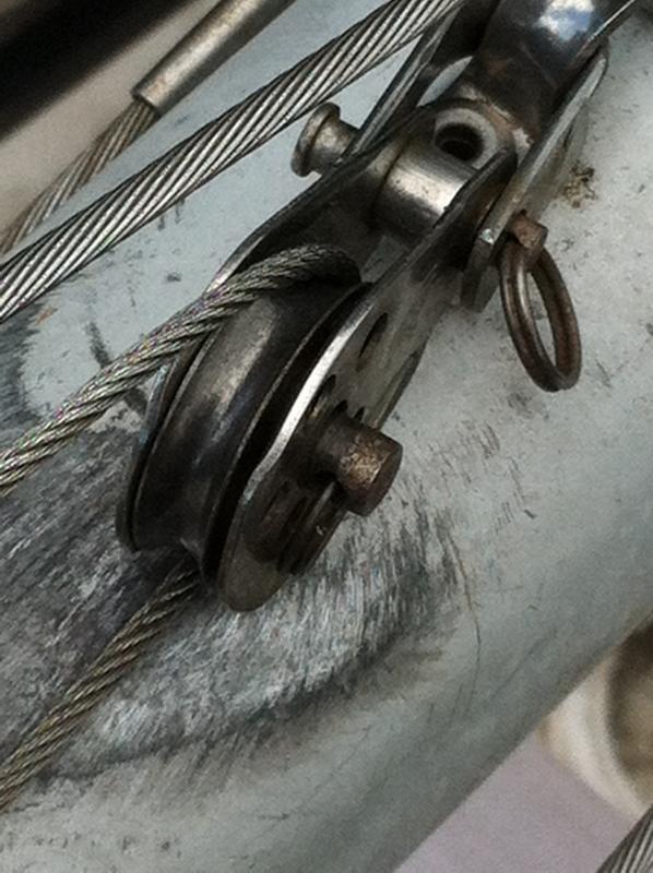

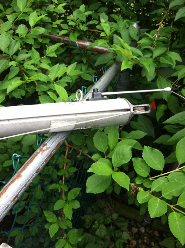

Not sure what pic 3 is... the jib halyard? What's the other stuff on the mast ring.
The "thingy" in the middle of the loop is called a thimble. The little loop is called an "eye" In your exampe the thimbled eye is created by the small ring that is "nicopressed" onto the wire. If the halyard were rope, the eye would be called a "sliced eye"... or you could just tie a bowline through the head board instead of using a shackle.
If you go to any major chandlery, they will have the tools and parts in the store to make these parts.

You can take the cam cleat apart (carefully) to see if the wire spring is broken or jammed. Probably just needs cleaning.... but... dude... that's one ugly mainsheet. On a boat that size I wouldn't use anything larger than 5/16.... so it runs through the blocks easily. I like Samson trophy braid for that application. (fuzzy stuff)

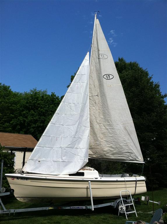

Looking at the picture of the entire boat I was thinking the mast was raked too far back. Maybe loosen the backstay and the fore will be long enough...
Yeah... I agree.... there's no backstay... so adjusting the swept back shrouds will change the rake. Also... remember he has an adjuster somewhere at the top of the stay... that could give him more length without changing the rake.

Joe, pic 3 shows both the jib halyard and main sail halyard.
When I trial sailed the boat in the fall, we did attach the forestay directly to the chain plate. This time, no matter what I did, I could not make it reach. I will try again.

I was hoping you'd show the upper connection and jib halyard block. That picture doesn't really tell me anything.... what is it shackled to, it looks like a mast ring for the whisker pole.

Take a look at your shrouds (sidestays) and make sure they are not kinked or bungled where they connect to the mast.... there's only three wires holding the mast..so if the forestay seems too short, the the shrouds are restricting the mast position. I also remember you saying there's an adjuster thing on the upper end of the forestay... check that.

I posted photo 3 to show the ends of the jib halyard wire and main halyard wire. For storage they are attached to that ring on mast. Not sure what the ring is for.

I also looked at several photos of N17s I agree that my mast may be raked back too much. I'll check that when I can set it up again. There must be a reason the turnbuckle is extended all the way and I could not attached it directly to the chain plate.

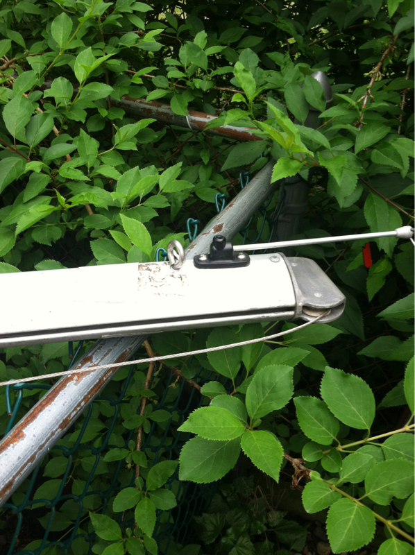

Oh, that mast ring is an attachment point for a whisker pole.

On the standing rigging, I took another look at why the forestay appeared to be so short. I think that when I connected the shroud adjusters to the chain plates, I did not pay attention to if the wire shrouds were twisted.
This time I made sure there was no twist and I was able to connect the forestay directly to the bow chain plate.
As suggested I took a look at a lot of photos and my mast did look like it was raked back pretty far. I went up one hole on the shroud adjusters and tightened the forestay turnbuckle. The turnbuckle no longer looks like it is at the end of it's adjustment. I used SS cotter pins to secure it and will pick up some tape to wrap it.
