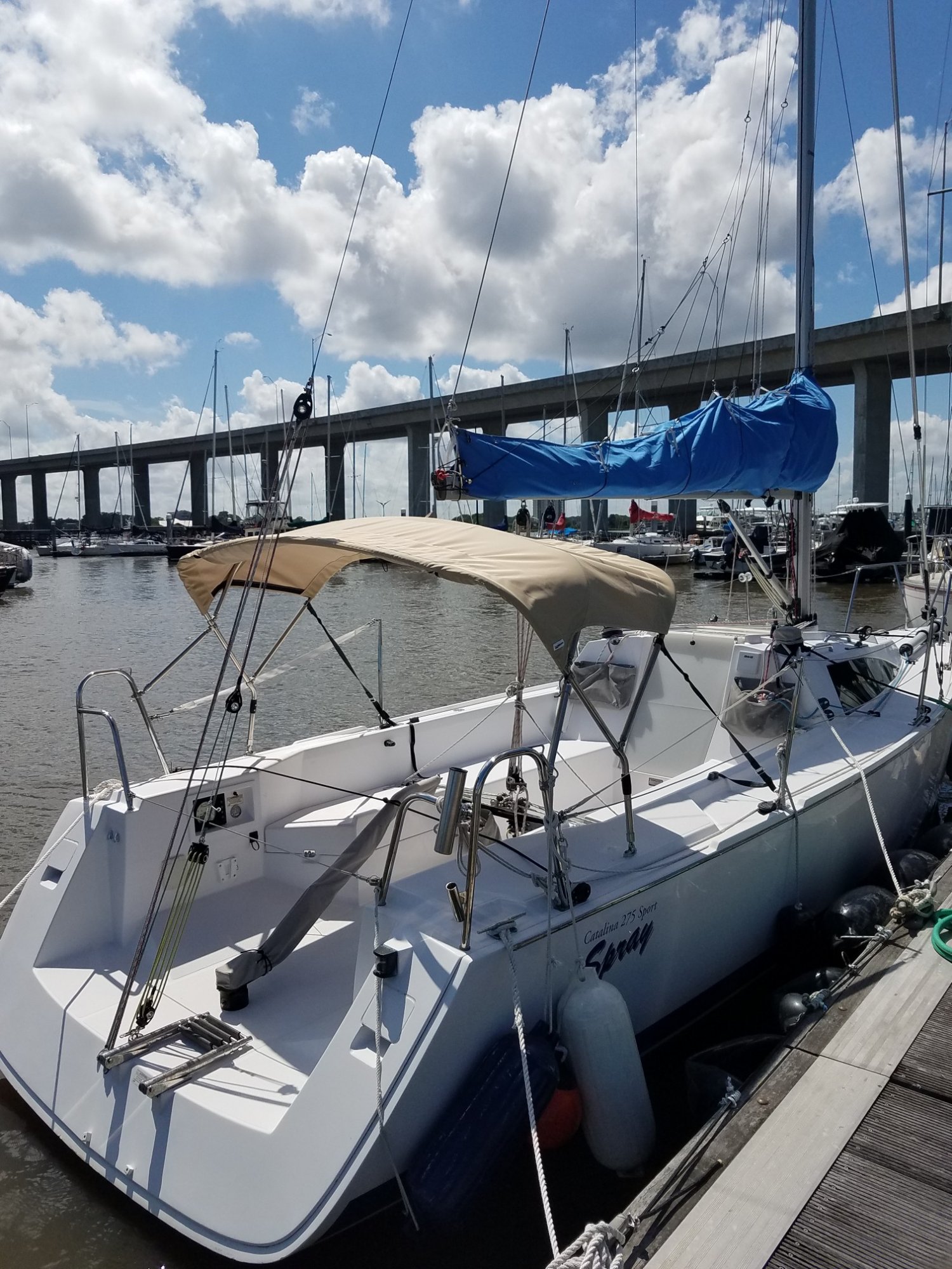

This is not true. My wife designed our sail pack and it has full length top edge battens and I roll it up and stow it along each side of the boom with built in sail ties every time I hoist the sail.
Likes: Ward H
Apr 5, 2009
3,333
to hoist the sail from my roll-up pac, set the autopilot to hold the boat on a heading of about 10º apparent. I loosen the windward side a bit to form a troght and push the sail into it. Then I lower and roll the leeward side which gets all of the jacklines out of the way so that they will not hangup on the battens and hoist the sail. Once the sail is up, I drop and roll the windward side.
To drop the sail, I raise both sides to the correct height which is marked with a line around the halyard at the cleat and drop the sail into it and zip up.
