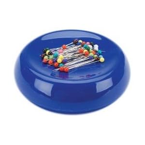

While we are on tips these...
... magnetic pin holders are a good deal ...
http://www.amazon.com/bwm36-GBLA-Gr...N6BNI/ref=pd_sim_sbs_ac_5/178-2164775-9438515
