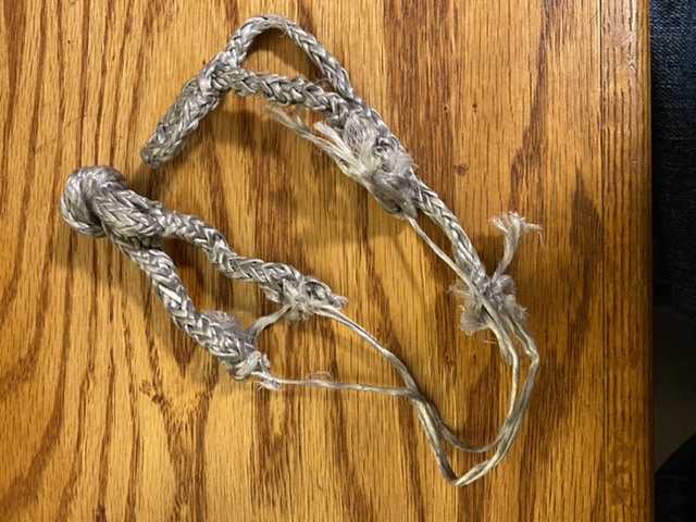

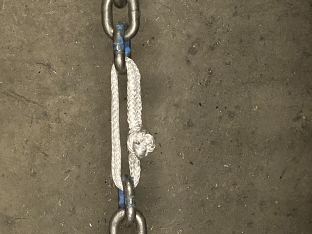

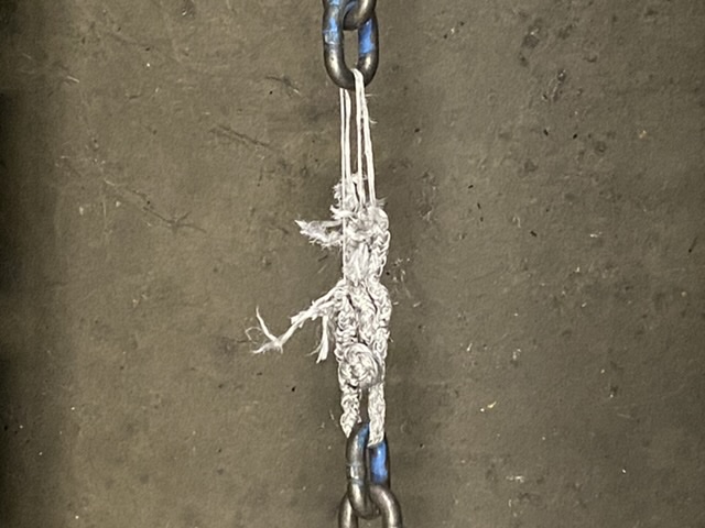

24,805
About a year ago, I load tested a dyneema soft shackle. The listed breaking strength was 8500. The test break occurred at 10,800. The bury was just cut off square. As the tension built, I observed the fibers bending at the cut ends as the line constricted over cut ends.
Here are images of the setup and the broken line. Note the breakdown did not happen at the knot. This shows that the former knot is not a weak spot.
There was a bit of heat created in the process.
