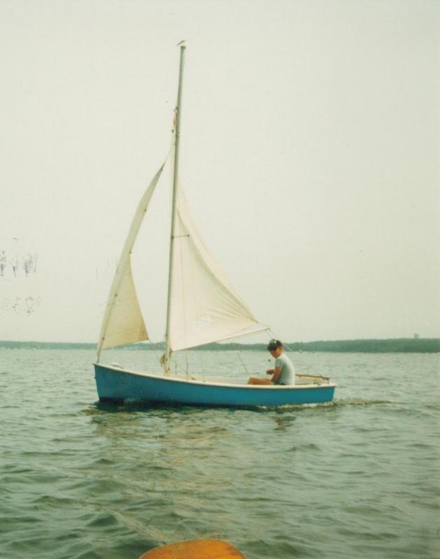

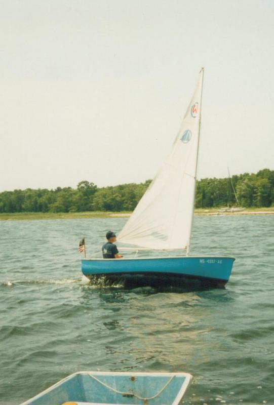

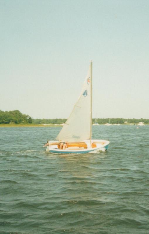

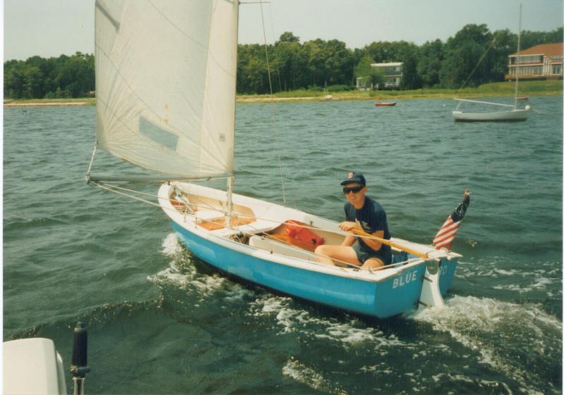

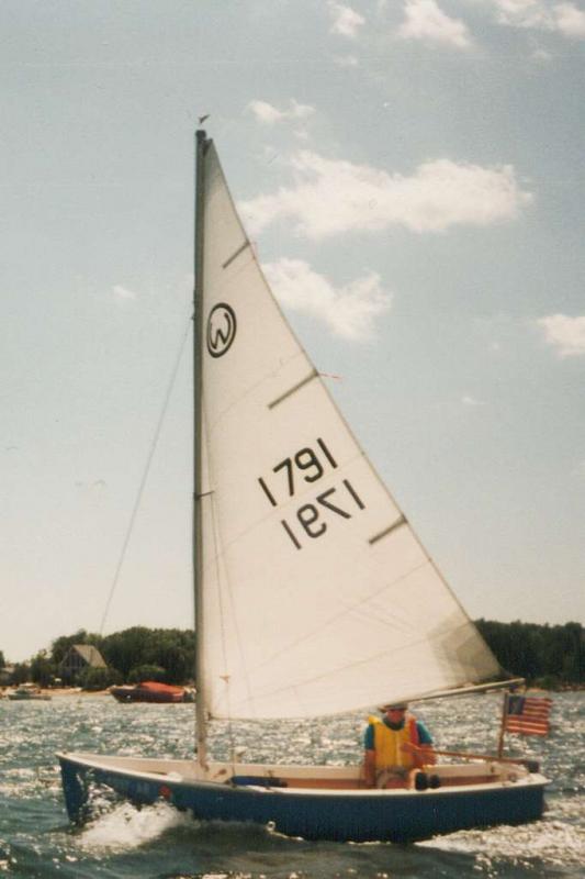

I sail my DS II quite often without the jib, in fact that is my "first reef" when the wind increases. The "trick" is to simply raise the CB a bit to move the center-of-lateral resistance (that is center of underwater area, in htis case the centerboard) more in line with the center of effort of the sail. This will reduce the weather helm (tendancy to trun into hte wind) when sailing with just the main. Don't raise the Cb too much or you will experience "Lee helm" the tendancy to turn away from the wind. You do want a slight amount of weather helm for safety as that will turn the boat into the wind to spill wind from the sail(s) and help prevent a capsize.
The smaller O'DAYs with their large mainsail and smaller jib actually will sail better under main than most sailboats, this is a good feature especially for learning to sail and for days when hte wind is too strong to comfortably use both sails. Again, just raise the CB a bit to better balance sail area to CB position. My old Widgeon would also sail very well with just the mainsail, I just raised the CB a bit.
If you are trying to raise the jib while underway, it is actually safer to let the boat head up into the wind while doing so. Release the mainsheet as well to prevent that sail from filling and heeling the boat suddenly. I usually raise the sails before leaving hte mooring, but can raise hte jib underway by letting the boat round up into the wind while doing so, then bearing off after the jib is up. A tiller extension (aka hiking stick) come in handy to extend your reach when you need to move forward in the cockpit while sailing, or if you sit on hte side deck while sailing in higher winds.
By the way, most of the pictures posted below were taken the first season that I had my Widgeon.... and I'm not wearing my life jacket! YIKES!! I don't know what I was thinking, I was a lot smarter starting with the second season with that boat and wore my life jacket virtually all the time (rare exception was in extremely light winds and calm seas, when it was sitting on the seat next to me). I would never go out in my DS II solo without a proper life jacket now. ( I have an inflatable one now).
