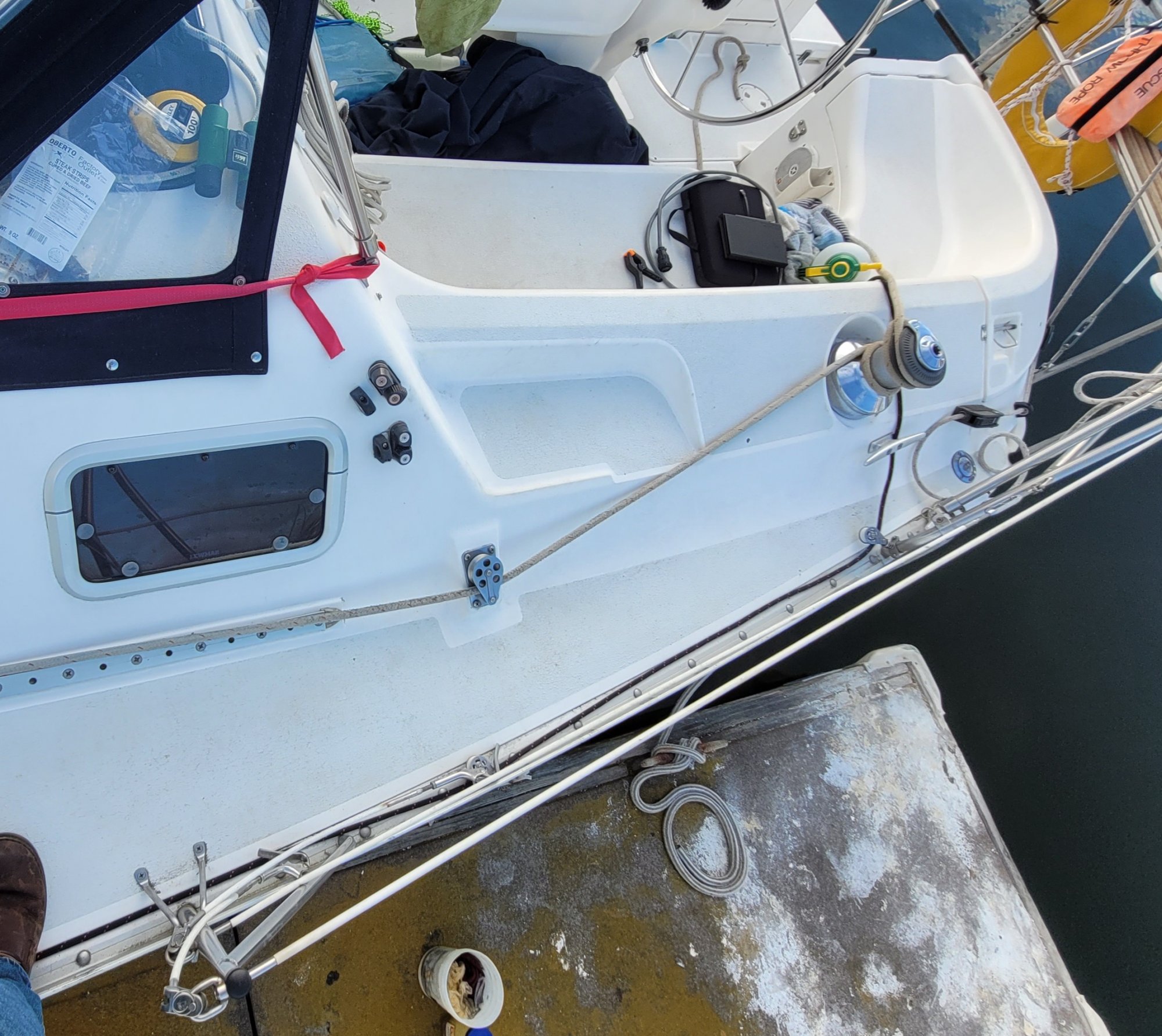

Very good ideas. No arch though, this is what I'm working with. Plz excuse the mess, it was a project day. Winch has jib sheet. Black line is furling line.

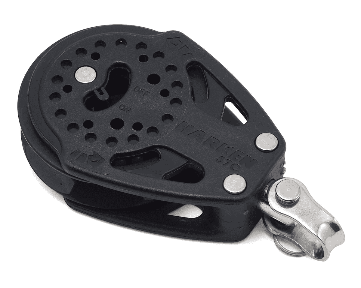

My H41DS had a racheting block and a cleat to tie off the headsail furling line, too. I replaced the racheting block with a Garhauer block with a cam cleat. The cam cleat holds the furling line nicely and I don't need to cleat it off. The cleat is partially under one of the canvas side panels that I had made to enclose the cockpit more. That made it difficult to use the cleat. The new arrangement is very nice and I can use any available winch, if necessary, to furl the headsail.
Garhauer Block with Cam Cleat
I searched quite a few places including eBay and West Marine and all the other blocks with a cam cleat were significantly more money. This one is nicely made; the only disadvantage that I can see is that the position of the cam cleat is not adjustable like it is on some others.

The last fairlead on the line, is it a ratcheting block?
Here is a 57mm Harken. I have the 40. It tensions the line reduces the pressure I have.
That looks perfect! Thank you
it is not. I googled ratcheting blocks. I think they may come in handy.
Why can't you replace that last block with a ratchet block with cam cleat?
I replaced mine with a non-ratcheting block with a cam cleat. I'm interested to know the benefit of a rachet block in conjunction with a cam cleat.
They require less holding power to keep a line from slipping than a non-ratcheting block, which turns freely. Some are even load sensing. That can allow you to maintain tension on your jib sheet, hold the furling line briefly in the same hand while you let go of your grip momentarily of the hand hauling in the furling line to reposition it for another pull. Hope that makes sense. I don't find that the furling line imparts that much tension, so a non-ratcheting block with a cam cleat works fine on my boat. But for bigger boats (or for folks with less strength) it may be an issue. Ratchet blocks are also more expensive. Harken makes an "auto ratchet" which is supposed to be revolutionary in the market (e.g. senses the load and allows slip when its light - so you can let a sheet out without having to turn the ratchet off, has a variable load setting for the ratched, etc.). Haven't seen one yet, so can't comment.
