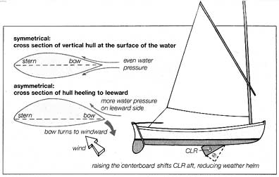

What are you doing with your centerboard? If the sails fill once you head off and you are being rounded up, try a little less centerboard to move its center of effort towards the stern.

Start out with the main only (make sure there’s enough wind or it will get frustrating). Centerboard about 1/4 of the way down as with no jib the push from the main is closer to the stern, so you want the board back a bit to counter that (I actually never lower my Rhodes CB lower than that even with a jib).
Get moving on a reach, so the boat has speed. Trim in the sail as you head up (slow and smooth, not 420 style). Watch the luff in the main, once it starts to flutter bear off a bit. See where you’re at. Ease the main in the puffs to keep flat and maintain speed (you don’t have someone on the trapeze keeping you flat!)
Mess around with the CB position, see how it effects the tiller- you want to be putting as little input on it as possible, if you’re really having to yank it toward you to maintain course, you are effectively dragging a brake through the water and she won’t be going anywhere fast. Mess around a lot. Get fast with the main alone. When heading off make sure you simultaneously let out the main, she won’t turn quickly otherwise (unlike the 420 which will basically do anything the tiller asks before you’re done moving it).

From your avatar it looks like you have a Daysailer II, which was the first boat I owned. The centerboard uphaul/downhaul setup on the DS2 is a weak point of the design. And its possible that the board when fully extended is past vertical, so yes as Mr Fox suggests, adjusting the board toward the stern may well help... as would making sure the main halyard and cunningham are tight.
I made a couple of modifications to my DS2 that also helped me feel in more control. First I modified my setup by replacing the main sheet block on the boom with a 55mm ratchet block w/becket. And second I relocated the jib sheet cleats from the coamings to the centerboard trunk... specifically, I replaced the old cleats on the jib cars with 40mm ratchet blocks and mounted cam cleats with fairleads to the centerboard trunk. Adding the ratchets made controlling the boat much easier... and having the cleats on the CB made single handling less stressy.
