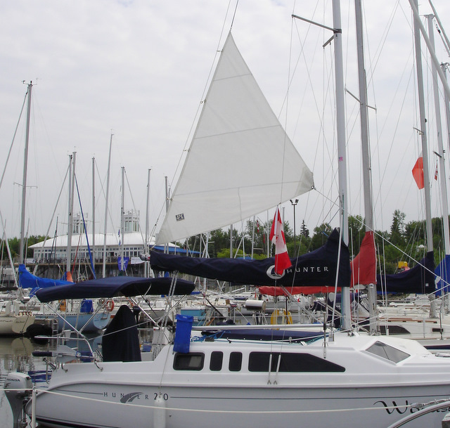

I have a 2005 Hunter 41 that, while at anchor would swing 90 degrees. I purchased a riding sail from Banner Marine. Banner said it would cut the swing by 20 degrees and it did, from 90 to 70.
Which riding sail did you buy? Was it the one that has two panels that tie to both port and stbd, or was it a single flat sail?
A friend bought the single flat sail a couple years ago and although it did help it wasn't "The" solution. I'm thinking that the Vee-shaped twin riding sail would work much better.
zeehag
Mar 26, 2009
3,198
one of my neighbors uses a sabot sail affixed to his backstay, but you havent one.........have you tried using a bridle off the bow to your anchor?? or add a snubber to the anchor rode to forma bridle?? i noticed my fin keel, spade rudder sloop does much better when secured with a bridle system.
