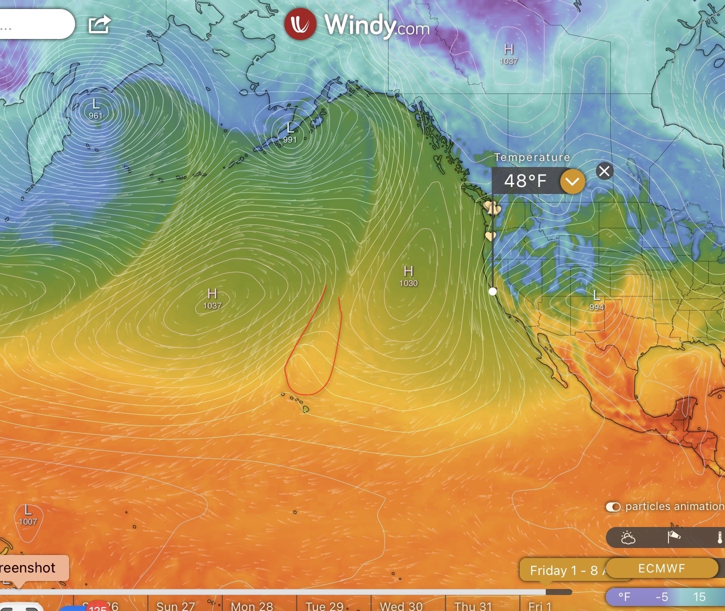

First to get a MACRO idea of what is happening in the Pacific, I use Windy.Com and zoom out to see the general pattern of reported weather. I was being asked to guess 10 days into the future. To do that I use the European Weather Model (ECMWF) to show what they are forecasting. I know that this is a best guess by a computer model and is maybe 30% accurate 10 days out.
I collected the following images for our discussion.

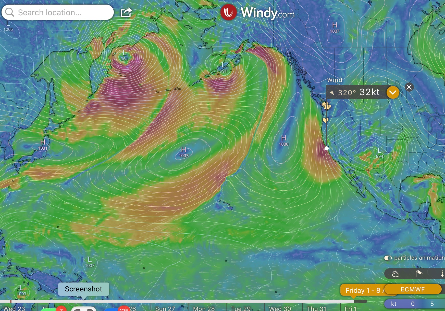

This first image centers on the Hawaiian Islands and is a forecast for 1 April 2022. It shows the surface Temperature, the High Pressure Cells and the specific report for an area just off the San Francisco Bay. This will become important in the next image.
This image is wind patterns around the High Pressure Cells and for that SF Bay region. Note that the winds circle clockwise around High Pressure Cells and when the Iso Bars (white lines of common pressure) get close together the wind speeds increase. The model is indicating that the High pressure cell near the West coast will be pressing up against a Large Low pressure cell located somewhere over Colorado/New Mexico. On the Pacific Coast the winds are increasing as the High cell tries to move the Low cell eastward. Winds in the SF Bay area could be in the 32Knot range. Now for a sailor off the coast that might not be too bad. The winds out of the NNW (320 degrees) would be on the aft beam. The currents along the coast generally run from North to South. This would put the boat in a following sea and a following wind on the first of April.

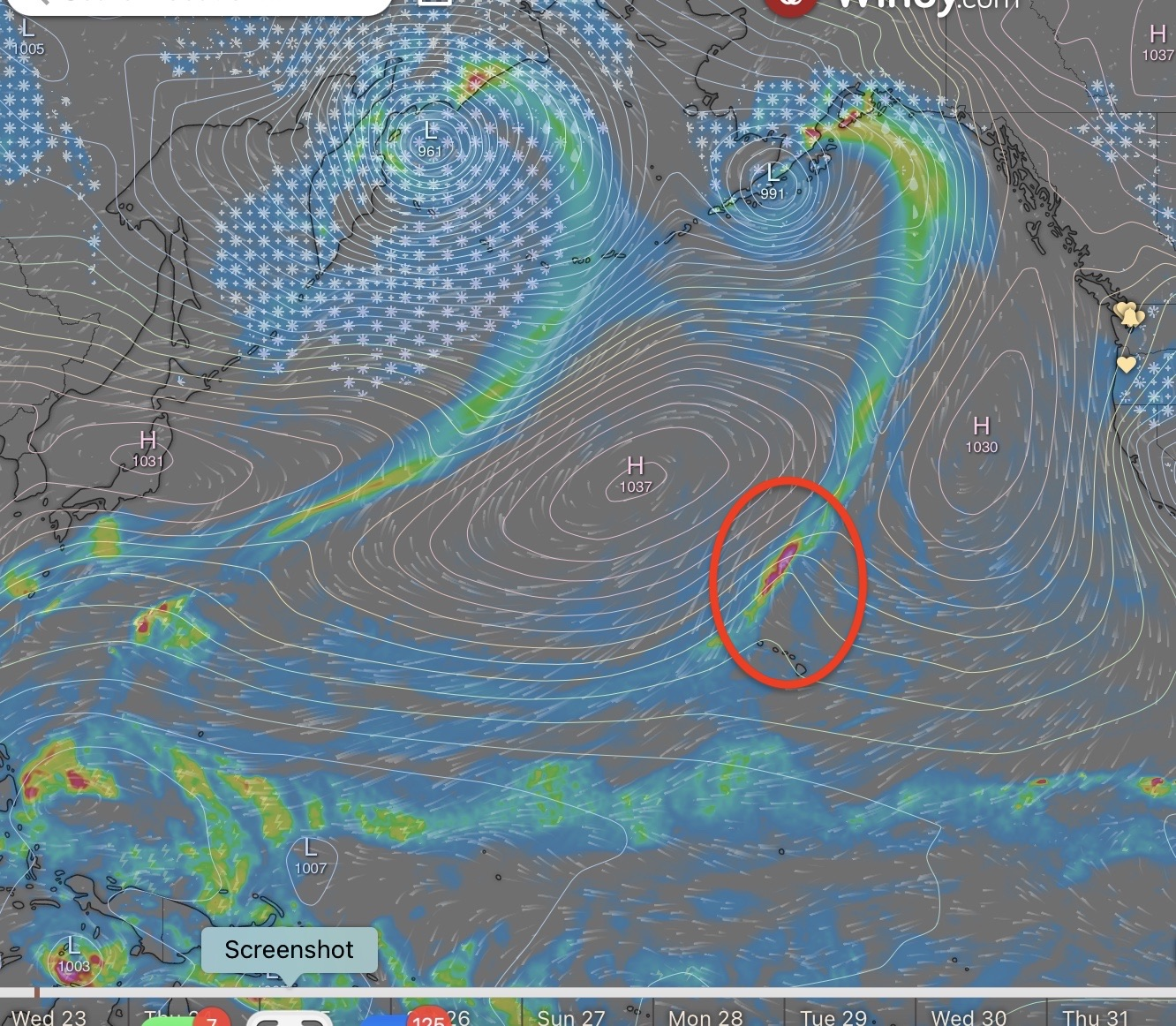

I raised a red flag for my sailor buddy. I saw a ripple in the pressure cells just north of the Hawaiian islands. That wave ripple in the pressure lines shows up on this image of the moisture as a squall area. While it is in the middle of the ocean on this model, it will not stay there. It will be moving. There is no clear guide to how fast or where or what it will develop into. It should be an area of concern for Skipper thinking about heading out into the ocean some 12 to 14 days in the future around the 1st to 8th of April.

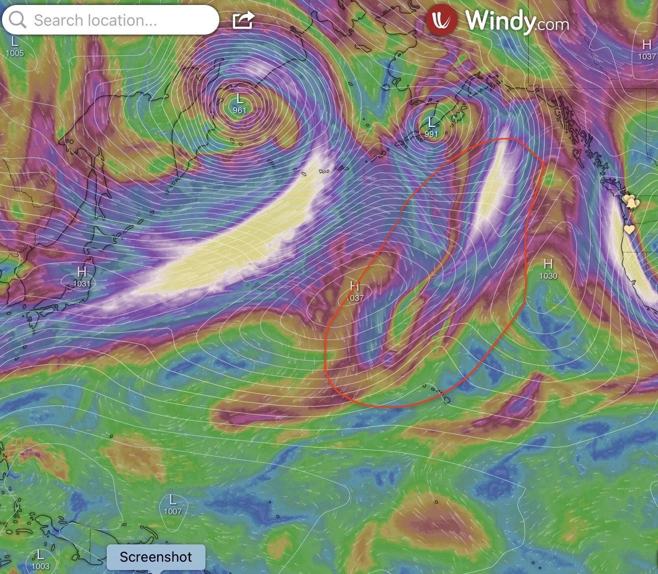

This upper air look at the jet streams in the Pacific give a glimpse at the powers moving the cells. The areas in white are areas of 100 plus knot winds.

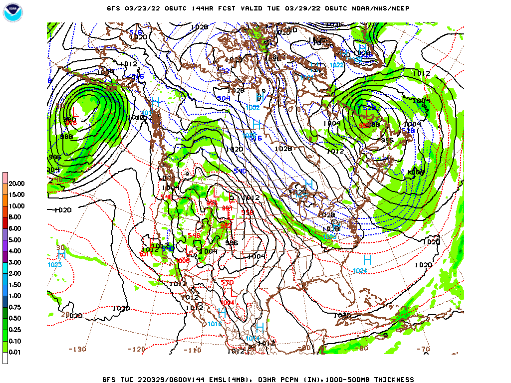

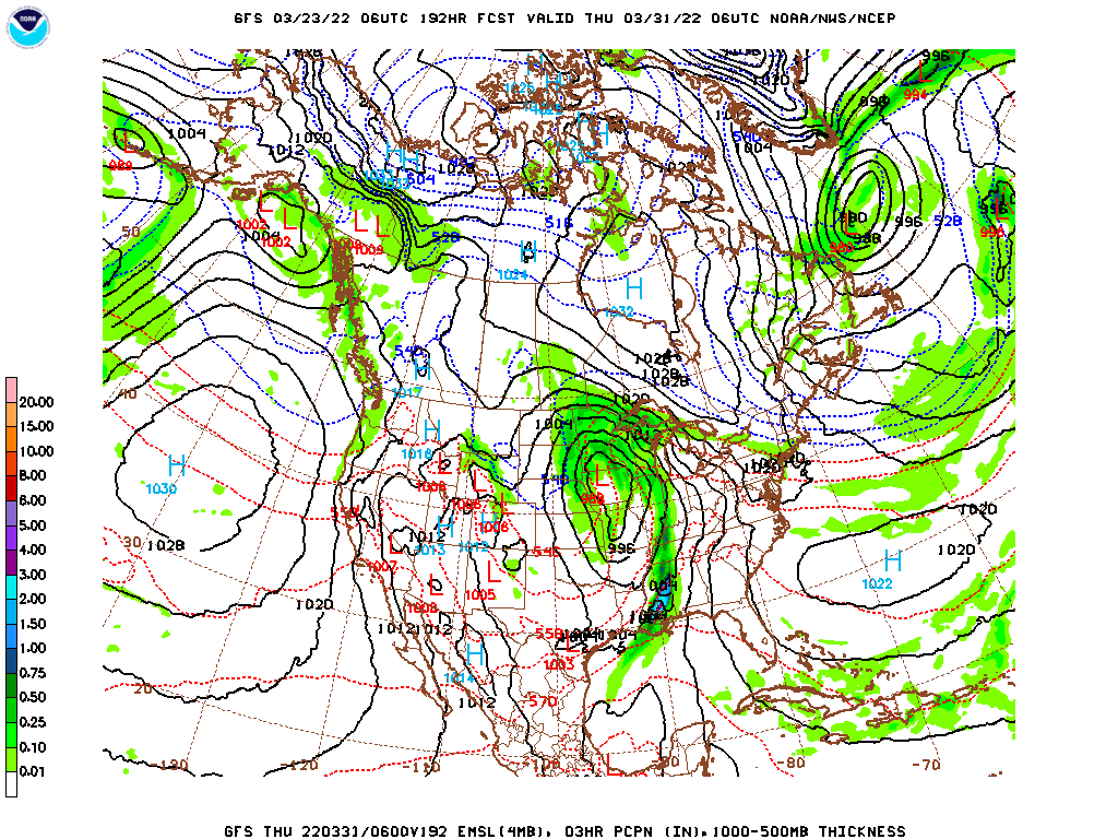

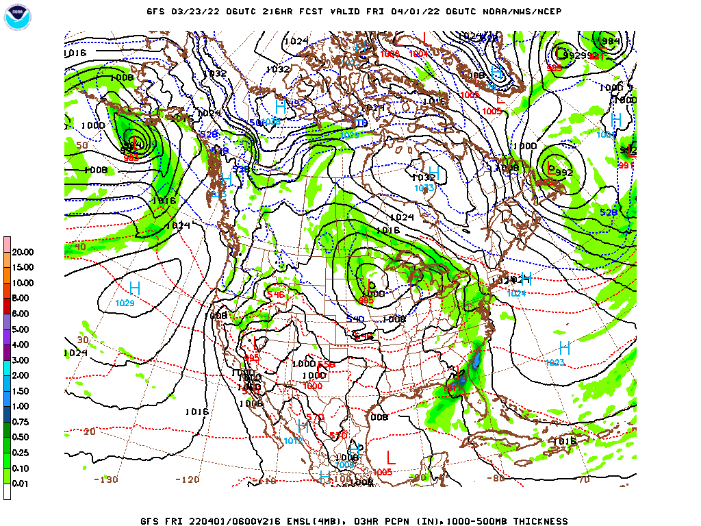

My next step was to look at what NOAA has available for a time frame 29March to 02 April. I gathered these images of the Pacific Coast line for the area of the planned passage.
Looking at the NOAA GFS data at this sight.. https://ggweather.com/loops/gfs_06z_thck.shtml
you can capture images of modeled weather (again this data is GFS modeling). There is a lot going on in these images. You can see High/Low Cells (High in light blue / Low in Red) with areas of green around them (moisture - precipitation), along with lines of common pressure (black lines, which when close together indicate areas of high winds) all are superimposed on a map of the North American continent (brown lines).
Looking at this series of images spread over the period 29 March to 02 April, I suggested a 5 day window of good weather for the proposed 3-4 day passage appears to be indicated.
I also said this real long range look indicates to me that the weather will be turning as you get into 2nd April and beyond time frame.
I pointed out the patch of green indicating precipitation on the NW quadrant of the High Pressure cell showing on the California Coast for April 02 leads me to believe the nice weather patterns are changing and beyond 02 April it looks iffy. You will want to monitor the weather patterns over the next 5 days to see what the models will be saying. I suspect that ripple we saw in the First Windy images will become a major storm front in California.
