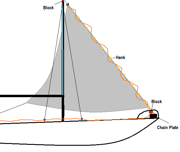

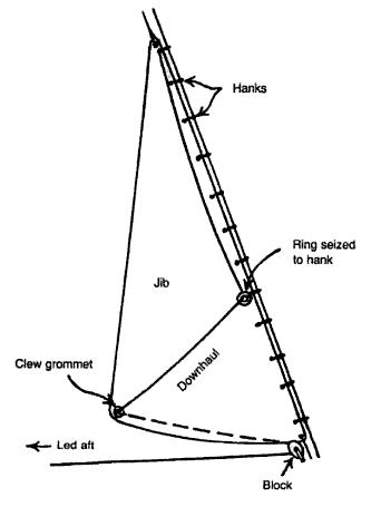

don't mean to dis your down haul but I couldn't make out the diagram.
the first one of these is a drawing I made and the second is one that I got off of this list serve.
I have not tried the second configuration yet but I really like the idea and plan to give it a try.

Your first drawing is the right idea, but I highly recommend you NOT THREAD the downhaul line through the hanks, it's unnecessary for operation, can cause jamming, and is a pain when bending on or removing the sail.... which you should always do after sailing.
Simply run the line through a block at he stemhead and tie a buntline hitch to the first or second hank up top....not the head plate grommet or shackle.... why? because if you do the line will pull the headplate down, folding it over the first hank, thus, binding it up....
No let the line run free except the block at the bottom and where it is attached to the top hank.... when the sail is up, you can tension the downhaul enough to keep it from flopping around.
I rigged my boat with the second system and found it not to my liking.....too much friction... it might work better on smaller boats... it is designed to be a reefing AND a dousing system.... but I just found it unnecessarily cumbersome for my 27 footer.
I have tried the 2nd option and the big problem I had was friction and the sail cloth getting bunched up and interfering with smooth operation. It has the appeal of tucking the jib into a nice ball that does not get blown over the side but I gave up on trying to make it work.
I currently use your first option and for my 100 and 135 it's works well.
