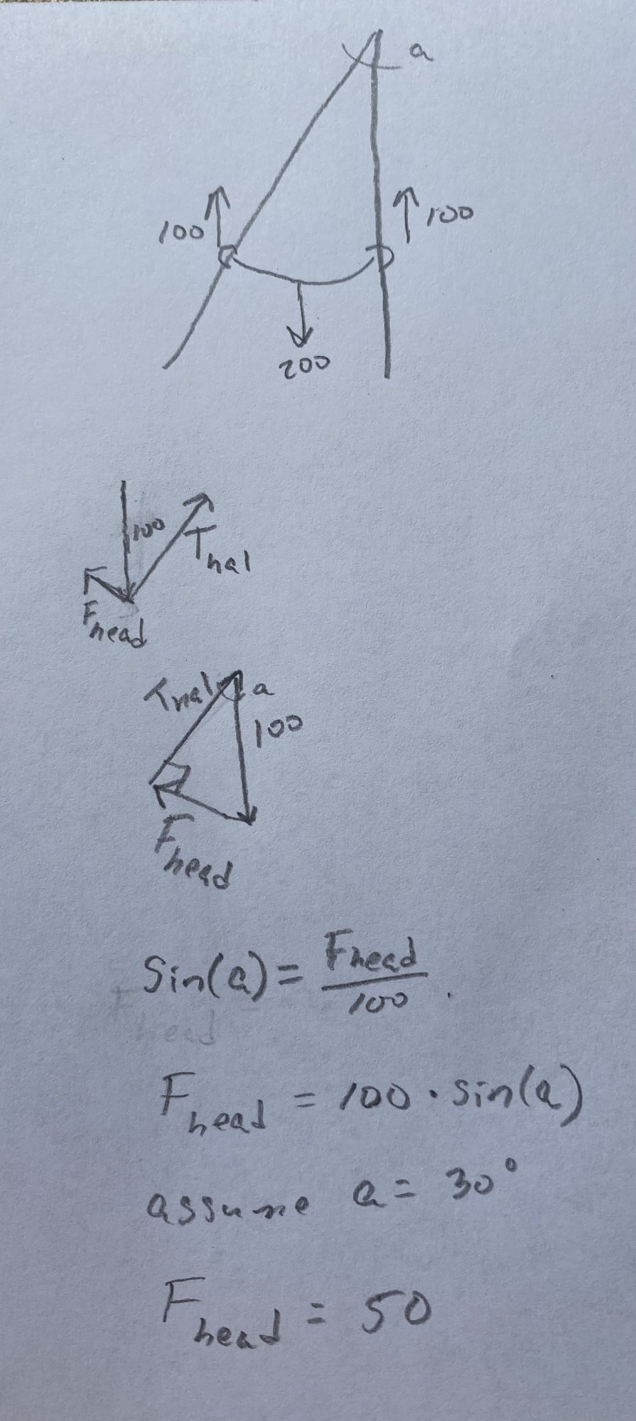

Can someone check my math?
If my math is right a 200 pound hammock load only exerts about 50 pounds of force perpendicular to the forestay. Pretty sure that would be well within its design limits considering the spinnaker arrangements that are available.

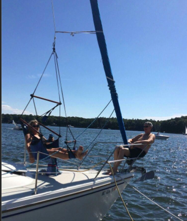

If you go with this set up......lounge chair attached to and supported by a spare halyard with a lateral line between the halyard forestay to center the chair on the foredeck..........almost zero stress on the forestay.
Yeah, I scoffed at first but this may be the ticket. Thanks for the suggestion

Being concerned about the furling headsail, I would hang one end from a halyard and use a strap to confine the halyard to the forestay. That way, the vertical load is carried primarily by the halyard, and the horizontal load captured by the forestay would be significantly reduced. You can adjust the height more easily as well.
That's essentially the way I do it. The aft end is attached to the mast and the forward end attached around the furled jib but the forward end is also held up by a halyard so it reduces the strain on the forestay. In addition, to spread the force on the forestay foil I use a 6 inch length of PVC pipe that has a split opening cut lengthwise. The pipe fits around the furled sail and the hammock line goes around the pipe thus spreading the load. I think it is five or six inch diameter PVC pipe but you can get an appropriate size to fit around your jib. I've done this for years and not had a problem.
