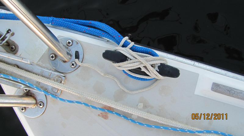

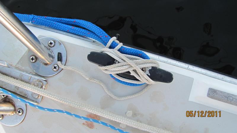

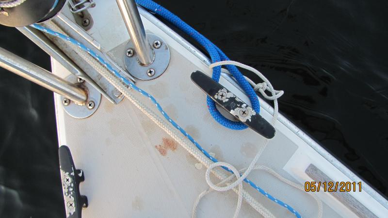

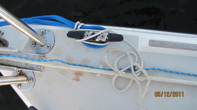

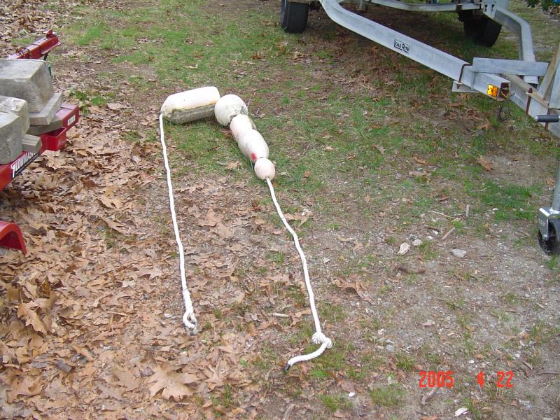

Our biggest problem on the river are the tidal currents. Pendant lines can get slack at mid tides and sink. The current changes, and the pendant line wraps around the mooring chain. I solved that problem by threading Styrofoam fish trap floats on the pendant line to keep it afloat.
I don't believe in using more than one pendant line. One pendant line tied to my Starboard bow cleat is enough.
Actually, my pendant line has an eye splice on it that fit over my cleat. I use a thinner diameter braid line to close up the eye splice and secure it to the bow cleat. This way, it can never accidentally pop off the bow cleat.
You may want to use a 5/8" or 3/4" pendant line with an eye splice on it. This line is really too large to tie to your bow cleat without the eye splice.
Securing the eye splice to your bow cleat will keep it from moving and chafing through as well as keeping it from popping off when the boat is rocking up and down with the waves on a stormy day.
The blue braid line in the pics is one of my 24' dock lines. I used to use a 1/2" nylon three strand line for my pendant line and tie it to my Starboard bow cleat. I now use a 5/8" Nylon three strand line with an eye splice to go over my bow cleat. I don't like pick up sticks. I pick up my mooring line with a 12' telescopic boat hook and having those fish floats on the pendant line makes grabbing the line pretty easy with the boat hook. I practice picking up my pendant line under sail just about every chance I get.
