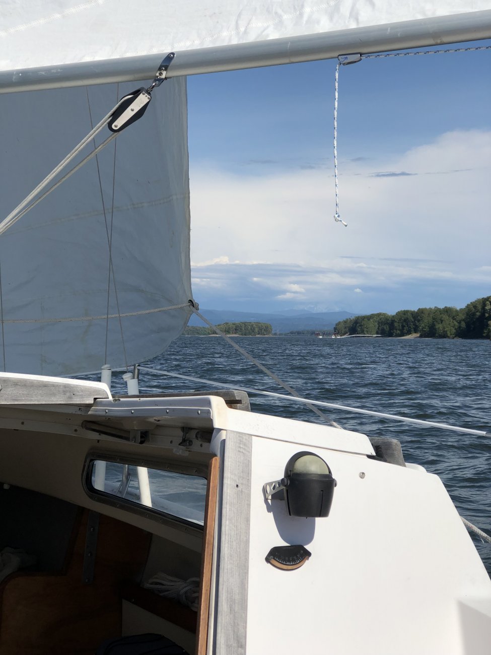

Boom Topping Lift
Parts & tools:
  1. Boom topping lift kit from Catalina Direct
  2. Impact driver and titanium drill bits
  3. Rivet gun and 3/16" aluminum rivets
  4. Hammer and strike
  5. Two beers
When the mast was lowered for the antenna project above, I also attached the stainless steel wire portion of the boom topping lift kit next to the backstay at the masthead. The remaining work was to drill six holes in the boom, two each for a block and an eye strap on opposite sides of the boom as close to the end as possible, and two more for a cleat halfway up the boom on the bottom. I did a lot of reading on the forum about various ways to secure parts to the boom, and I concluded aluminum pop rivets were the way to go.
After downing a "courage beer", I measured and marked my drill points with the strike, took a deep breath, and started drilling. Once a hole was drilled, it was immensely satisfying to pop a rivet in place and see such a secure connection.
Here's a photo of the finished product. The eye strap is on the port side of the boom opposite the block, and the cleat is further forward on the bottom of the boom, out of the frame of this picture.
When I went to run the line through the block, I noticed that the wheel (?) in the block is off center a bit, which made me wonder if I installed the block backwards. Oh well, it works just fine as is, and it's SO nice not having to deal with the original pig tail while hoisting or lowering.
- Andre
Apr 11, 2017
564
Catalina C22 Solomon's Island, MD
Nice work - nothing like a job that is actually done in less than 2 hours. The gods were smiling.

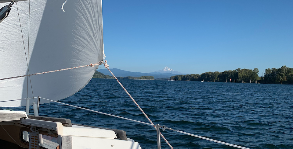

I took a coworker and her boyfriend out for an evening sail this weekend on the Columbia - it was hot and calm until about 7:00pm when the evening (diurnal?) winds kicked up and gave us about two hours of gorgeous evening sailing. Here's my newly minted crew helping douse and secure the genoa before we turned back to the marina. Mount Hood is in the background framed by the starboard shrouds. I love teaching folks how to sail for the first time. It's so much fun watching them catch the sailing bug. Also seen in this photo are my new halyard lines. Green for main, red for head. Makes it so much easier for both captain and crew to remember which is which! That terribly faded vang line is next to be replaced.
Apr 11, 2017
564
Need more #PNW representation in photos ;) gotta get our licks in before the Floridians make us feel jealous all winter.
I don't know - that thing looks a little like Krakatoa from that angle to me. Dang impressive sight though-

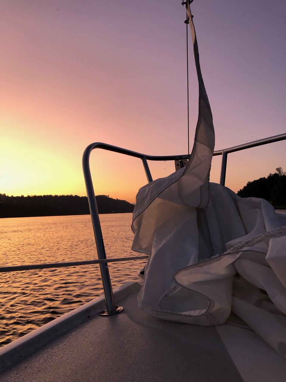

Our First Overnight
It's been a goal of ours to try overnighting on the boat and the stars aligned this weekend to give it a try, along with our three dogs. (The dogs are all on the smaller side, so it's not as cramped as it sounds.)
We sailed on the Columbia for a couple hours and tied up on an island dock to enjoy twilight and give the dogs a chance to take care of business. Between some loud dock parties, and the fact that we tied up in a spot that exposed us to wave chop bouncing against the dock, at 10:30pm we decided to shove off and motor about 500 feet down river to a quieter location and anchor for the night. Thankfully, between the glow of lights from Portland and lights from houses along the river, we had enough light to discern land from water.
I dropped the anchor, 8' of anchor chain, and 150' of rode in roughly 15ft of water fairly close to shore. Probably overkill, but I figured for our first overnight, more was... more. After setting the anchor, I sighted the shore for about 10 minutes to convince myself we weren't dragging, and tucked everyone into bed around 11:30pm. I slept in the V-berth with one dog, my girlfriend slept on the port berth, and two dogs slept on the starboard berth. (One crawled into the quarter berth and made a den, which was pretty funny.)
It was a great night's sleep on a quiet and calm anchorage, and I was thrilled to wake up and find our boat where we left it the night before. We literally hadn't moved an inch. Having the current to help keep the boat from swinging around was great, too.
And, the companionway and forward hatch bug screens we bought through SBO were fantastic. Being able to keep both open, along with a Caframo Sirocco II fan, meant we had cool fresh air all night. I also replaced the old PortaPoti with a Dometic SaniPottie 975MSD, which was used several times through the night and morning. (It's currently not plumbed for pump-out...)
Here's a photo of the morning sunrise at 5:41am, as captured from my phone held up through the forward hatch from the v-berth.
- Andre
