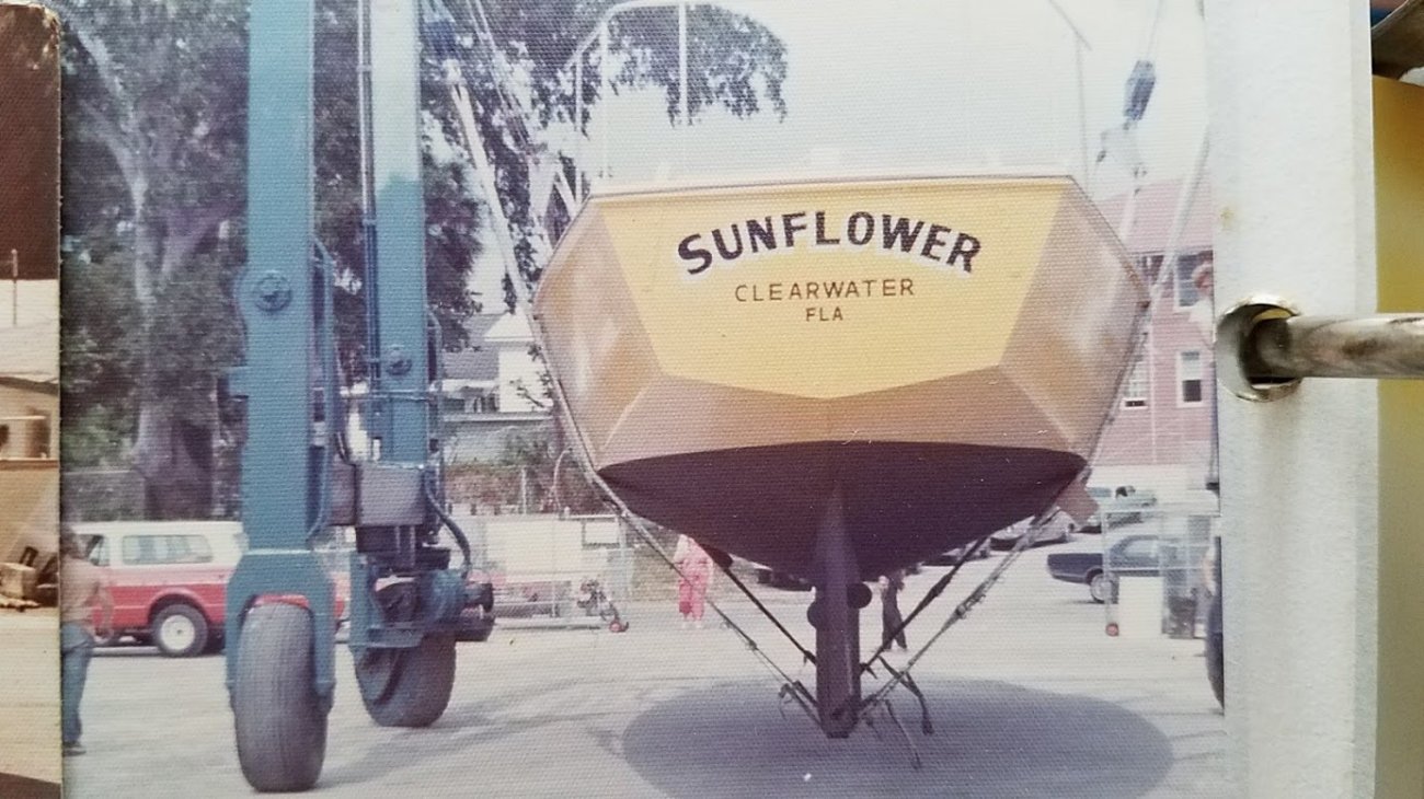

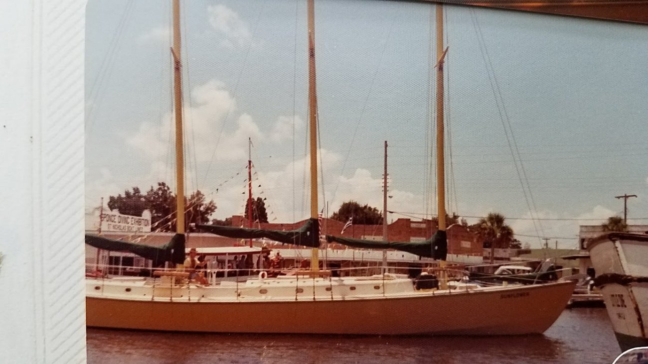

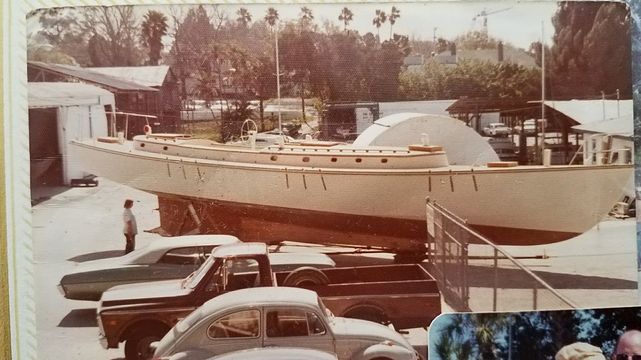

Nice Jon,
Sunflower was a simple pure sailer too. Icebox, no auto-pilot, no windless, We put a dodger on after she was buried by a rogue wave and the main hatch was open. Her half-keel made backing a little easier.
-Will (Dragonfly)

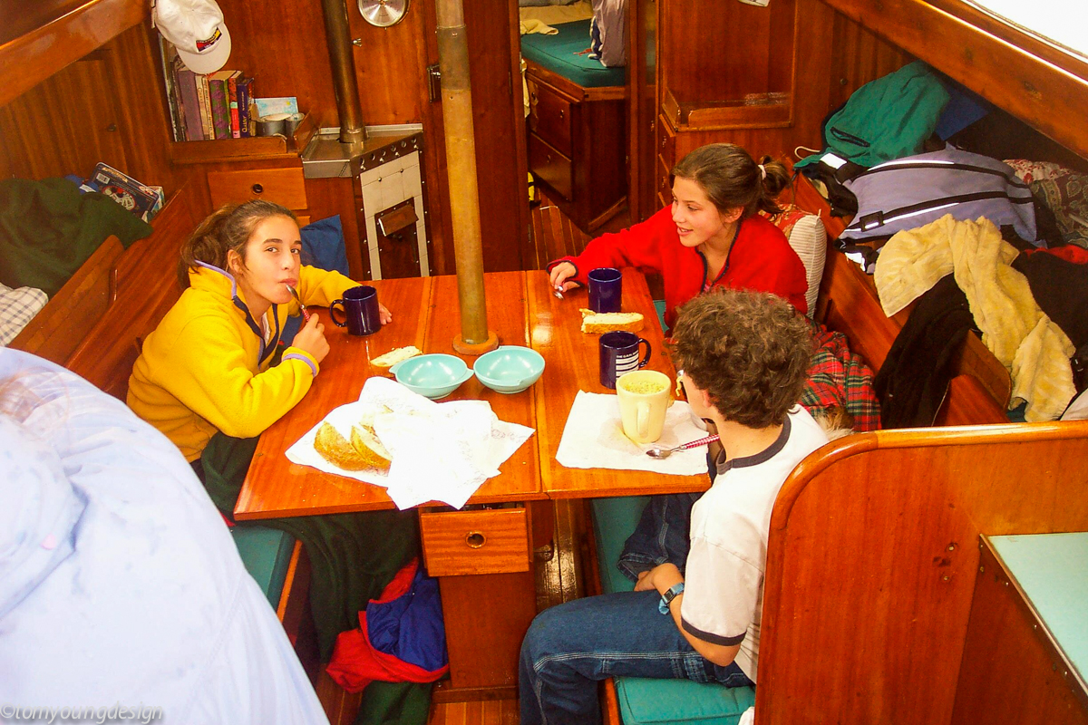

I get that (table removal), Jon. We hadn't sailed our Challenger for more than a few days before I determined something needed to be done to the centerline table. The old designers must have had a vision of a crew of 6, three on each settee, enjoying Downton Abby style dining, several times a day. Maybe this was a day when only men sailed?
But removal wasn't an option. The bronze centerboard linkage tube goes through the table, so you might as well have a table.
After the first season, I removed it and cut it down. It took some time with a tape measure, thoughts, before I determined to cut 7" off each end. That hard won number stuck with me as I recall it now almost 20 years later with perfect clarity. I saved the drawers in each end which are very handy and used all the time.
That old table was heavily used since. Seems Mary Ann was held captive between it and the galley all those years.
No longer a table for six, it was the perfect size for our family of four (or loaner kids). Cutlery in this end, linens (endless) in the other.
It's still annoying at times. But folded down, we're used to it traveling fore and aft through the cabin.

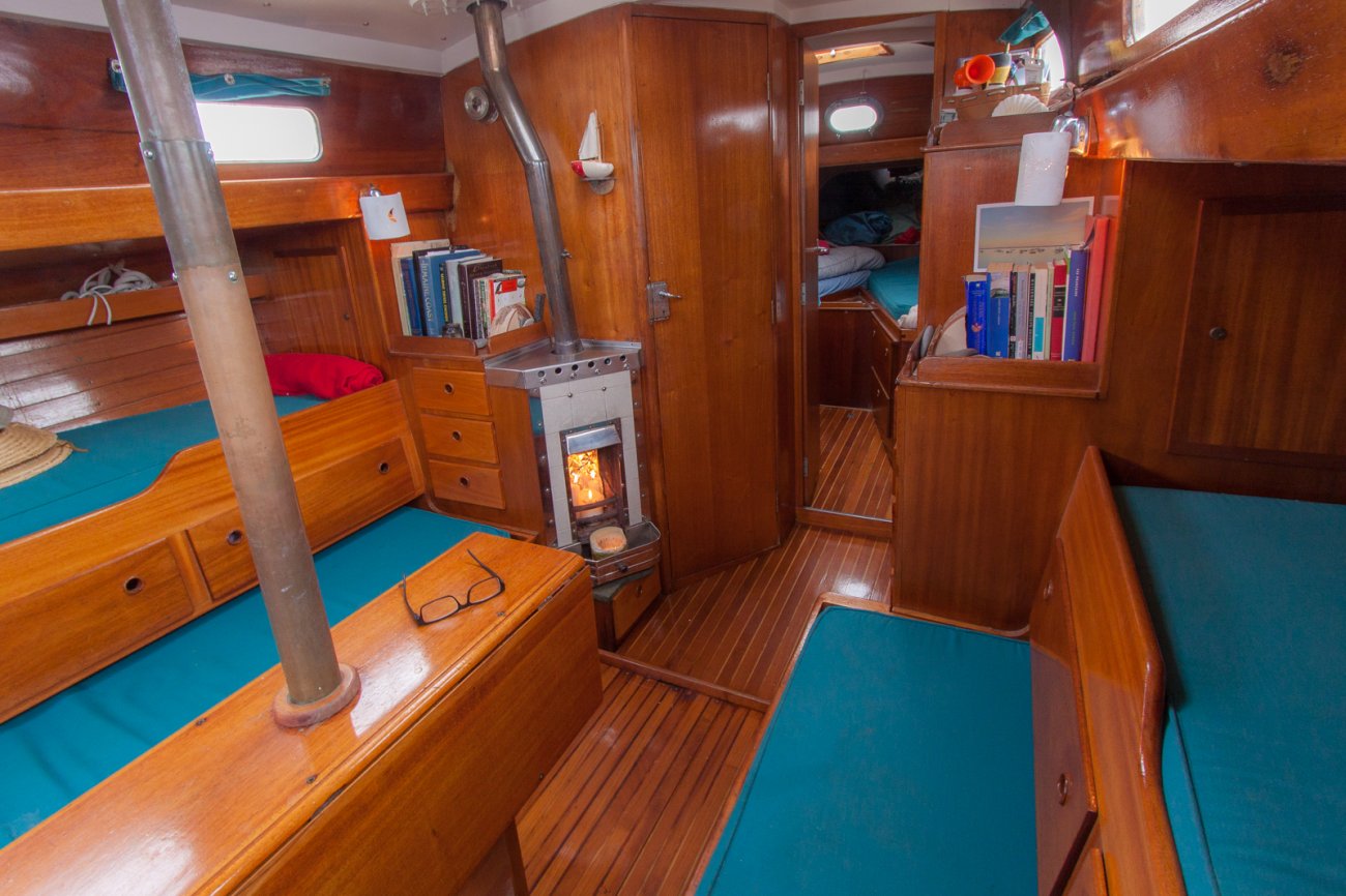

What the shortening did (14"), was allow an open area at each end of the saloon. Especially on the fireplace end, there is now a comfortable seat for two around the fireplace, unfettered by the table.
For TaborKP, I thought of building another smaller table and putting the original in storage. You might consider that option if you don't need regular dining for 6 (who does?).

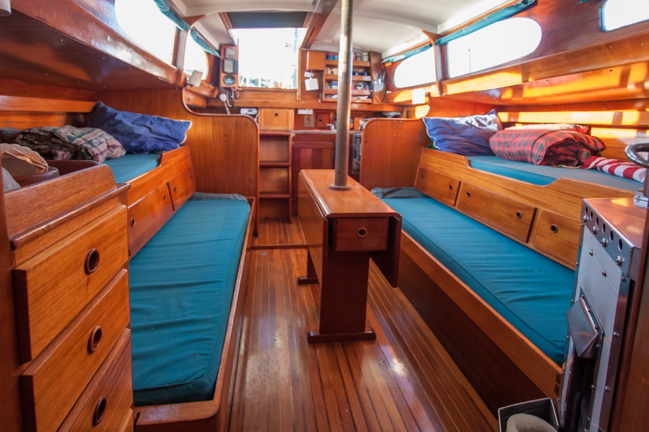

BTW, this table has taken a beating! It was built 59 years ago of a high quality marine plywood. The workmanship was so good must think it is solid mahogany.
Drop leaf shaped mahogany was glued to the edges (and are sound as new). Beautiful old hinges (3/ leaf), shapely wooden brackets for leaf support and heavy latches to secure down, while at sea. You can see the bronze sockets which 4 full length fiddles fit into. Extremely handy to use at sea (we used them a lot).
While the table was out for recutting, I just sanded the existing varnish down(didn't need removing) and applied several coats of spar varnish (it was once gloss-now satin from use).
I've never done another thing to this old table, except to wipe it clean several times a day.
May 25, 2012
4,338
tom, your resolution is the best of both worlds. on aeolus the table was just too much. cramped the galley, cramped the seating below. you have solved both problems while keeping the use of the table. you have the best of both worlds.
nice handling :)
