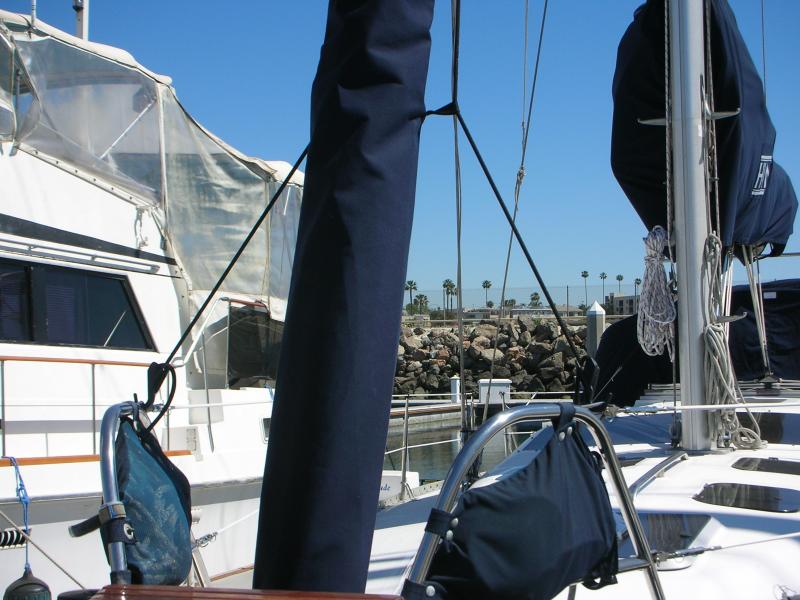

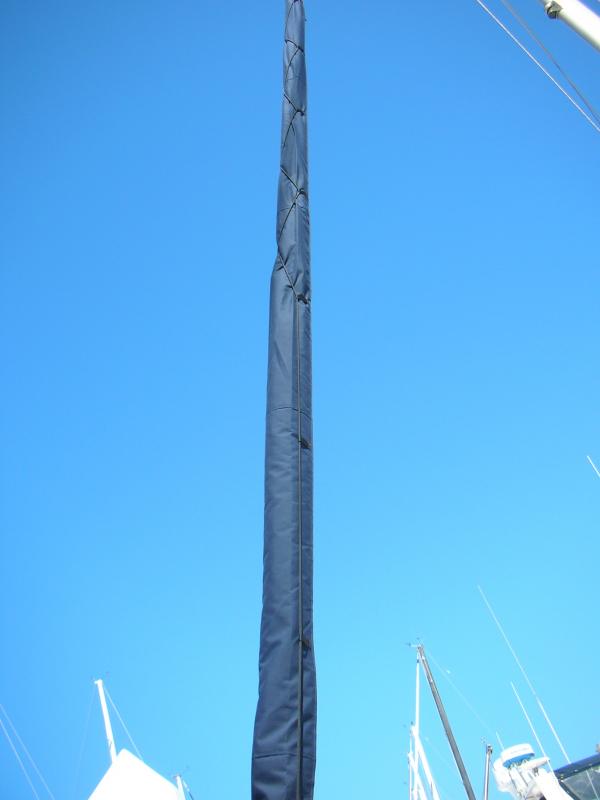

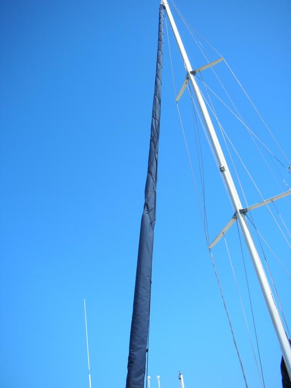

Our local canvas guy puts extra cords on the outside, zig zagging back and forth through D rings. Pull tight, and they reduce flapping from excess material, as well as reduce harmonic oscillations from wind going around, similar to the twisted wire going up your whip style car antenna, or those spiral fins on a smokestack...
