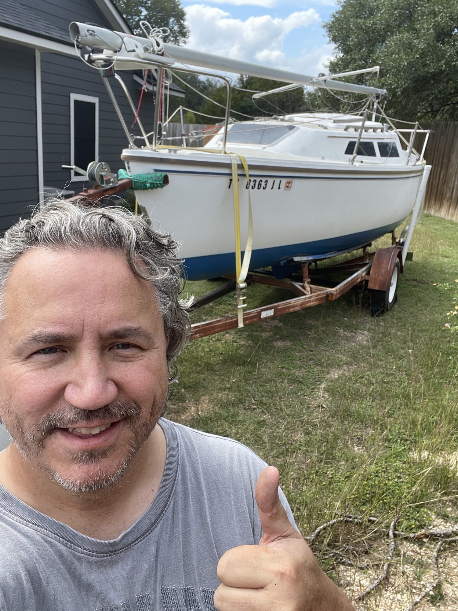

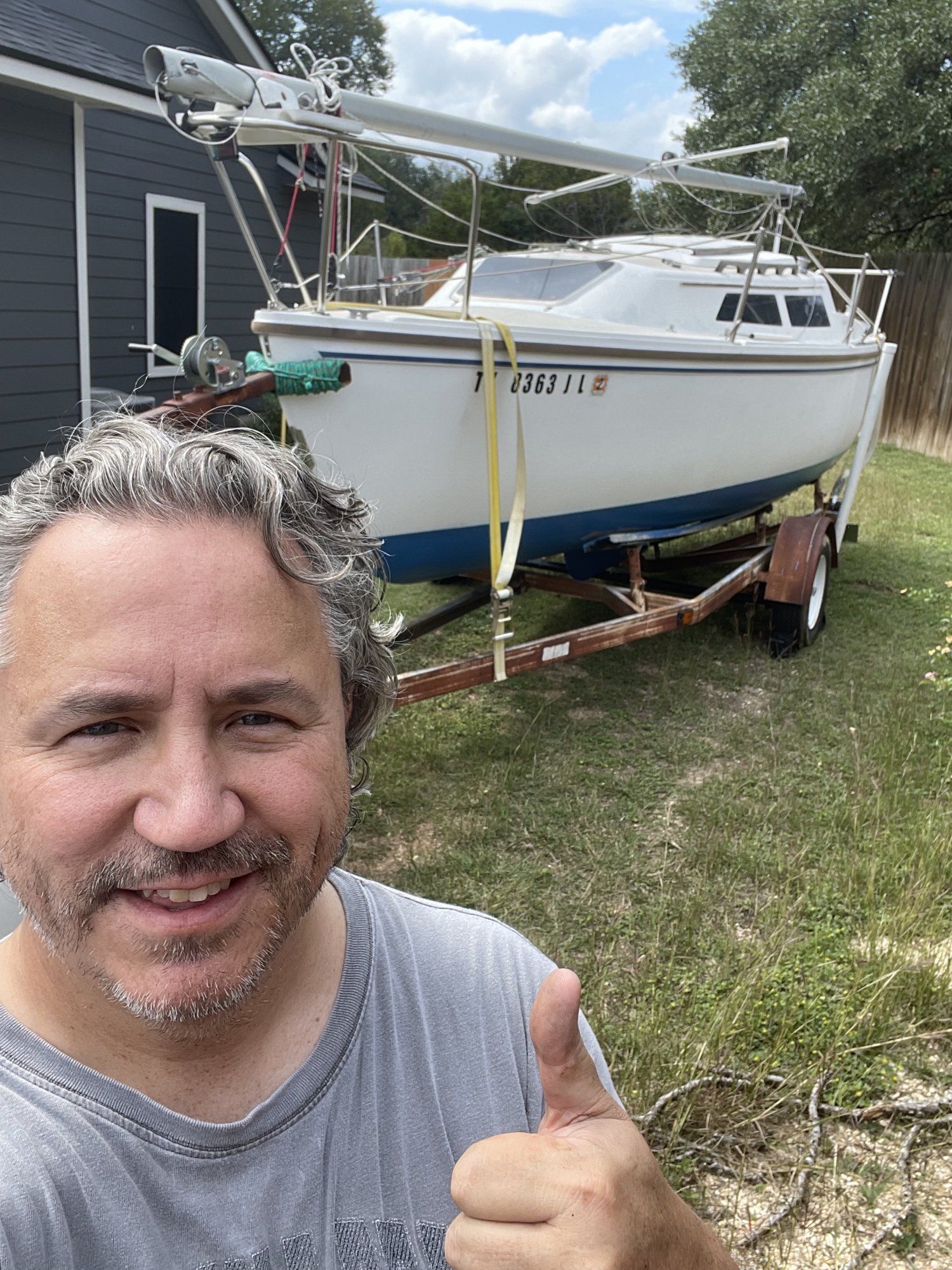

Hello,
I'm new to the forum and have just purchased a 1987 Catalina 22. The hull needs some work below the waterline but most of the shops only seem to work on power boats. Basically I just want to have the hull sanded a bit, and have an anti-fouling coat applied. The previous owner kindly applied new bottom paint but had no way to apply it where the bunkboards on the trailer touch the hull.
Is there anyone that could recommend a good place for this type of work around San Antonio?
Thanks,
Steve

A jack isn't even needed.
Raise the tongue with the support wheel as high as it can go. Support the bow with a 4x4 and some concrete block or other things as strong, lower the tongue. This will give you access to the front half of the hull.
Repeat the process for the stern. Lower the wheel which will raise the stern. Support the stern and then raise the wheel. This will allow access to the stern half.
There are probably some videos on Youtube showing the process.

Agree with the above.........its a relatively small boat for DIY or hire some cheap help to raise the boat as dlochner suggested tape, sand and paint the bottom with 2 coats of antifoulant paint (ablative or hard based on what others at your marina apply) but be sure to wear proper PPE and if you hire someone, give them a big tip.

Welcome to SBO. Just a thought from looking at your boat you might just raise one side of the trailer at a time just 10" or so and then support the boat with a temporary bunk from the ground just inboard of the trailer bunk and then drop that side of the trailer back out of the way while you paint. My preferred method would be to lift the entire boat off/above the trailer as most of us have done as you will likely want to do that for a variety of future tasks.
