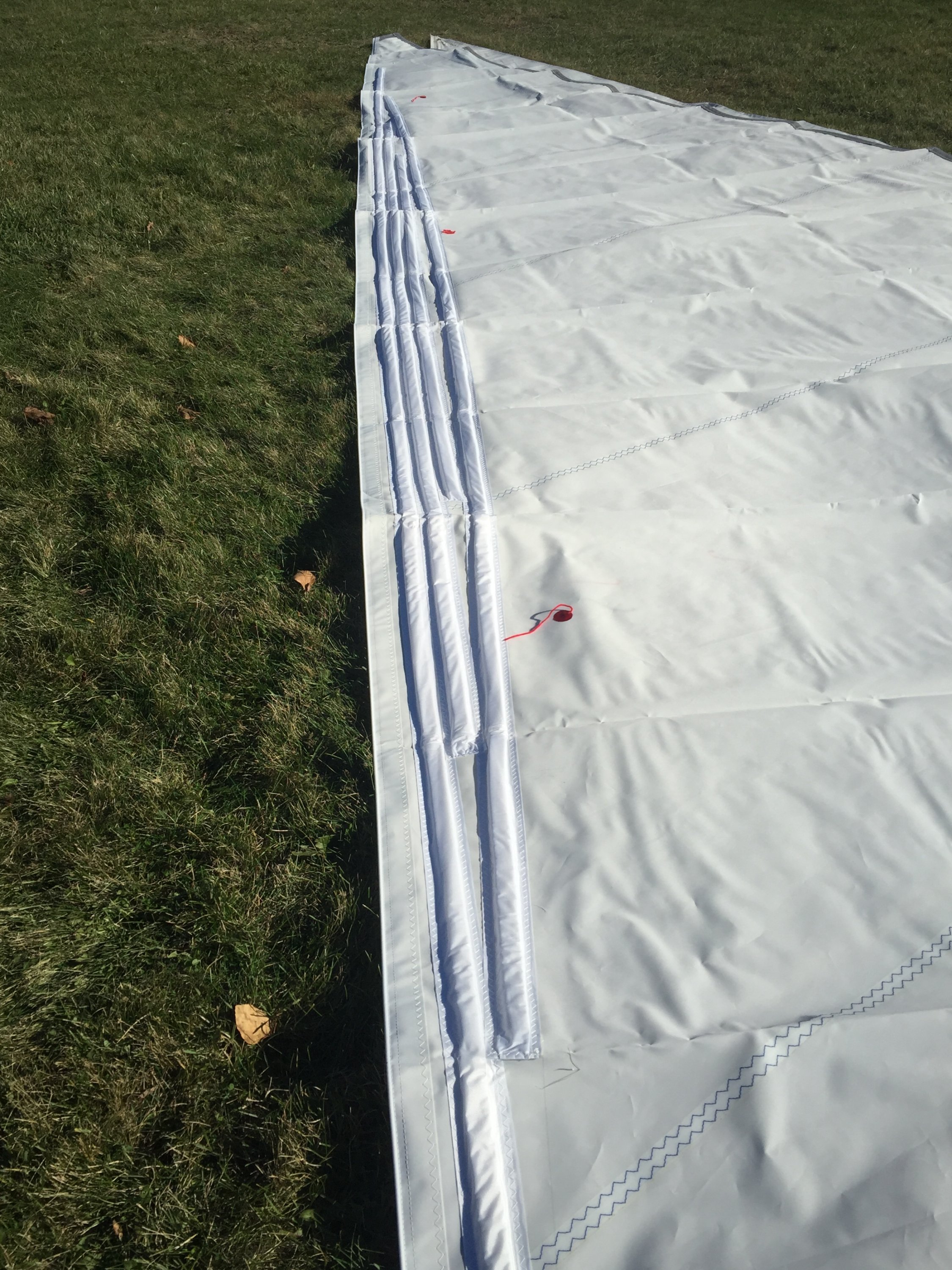

New head sails came with my boat. I just rolled them out to compare with the ones I have on because I am looking to put a new roller furler on. The sail had cushions about 10 inches off the luff vertically. The sail maker said it was to give support for light winds. Has anyone seen sails like this and will I have any issues with the roller furler. Looking at a harken #1 or Schaefer 1100.

That's a "luff pad" so that when reefed, by rolling up some of the sail, it maintains a proper shape.
3,030
Catalina 320 Dana Point
Jibs sometimes have luff pads or ropes under the theory that they will maintain shape when the sail is partially furled.

The foam pads are designed to flatten the sail when partially rolled, by removing draft. The flatter sail generates less lift/drag and is better in strong winds.

Sure. First read what I wrote again. The full sail will have too much depth for reefed conditions. Rolling part of the sail in will decrease the area, but not the depth. It needs to be flatter. The foam gathers this extra cloth into the roll, flattening the sail.
Just like ANY other sail trim condition, you match sailshape with breeze. As breeze goes up, flatten. This is true for all sails, reefed or not.

I believe these are called foam luffs, which fits with some of the discussion above. I like 'em; but my Ulman Sails, sail maker pal does not. Without one a headsail is either out or in. Roller furling, yes; but not roller reefing. So, if you're in a regatta waiting around the start/finish line for the next race you can roll in (furl) the headsail so you do not have to mess with it while waiting--and maybe having a sandwich. Near the 5 min gun for your start you can unfurl it and start maneuvering in anticipation of the "P" flag. But, you would not try to reef it during the race if the wind got up more than anticipated unless it had the foam luff feature. Of course, some folks wouldn't do that anyway (reef headsail) when racing even if it had that feature. Even though the sail is shortened and flattened some, you've got that big roll of cloth around the head stay which wrecks your pointing ability. It's better to feather up to flatten the boat than to roller-reef the headsail if you do not have to go far, IMHO.:)
