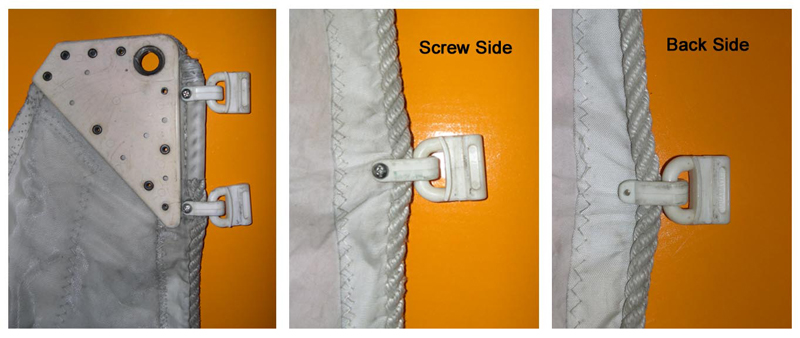

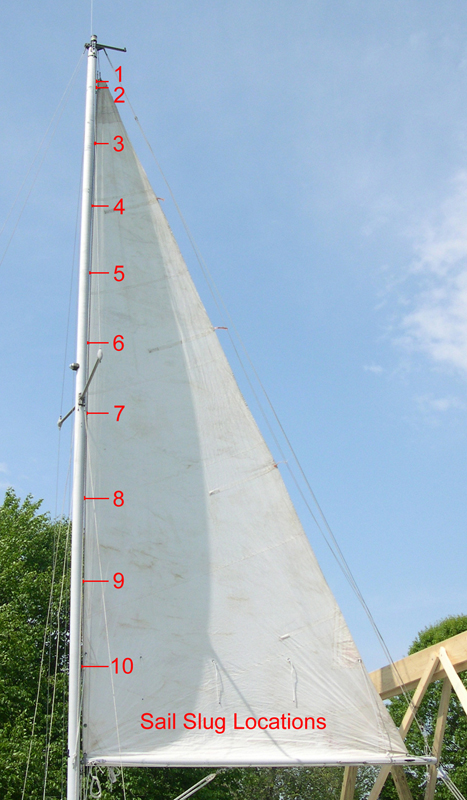

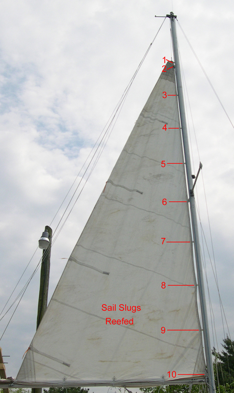

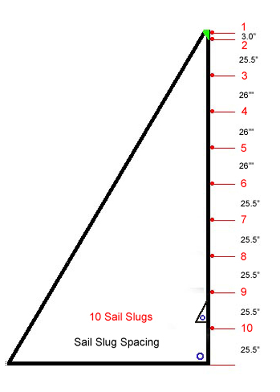

You can add sail slugs
You can put Sail Slugs to your sail yourself, it is so easy it can be done in a couple hours. They are available from West Marine or Sailrite, you need 10 slugs and 10 shackles, place the shackles through the loop on the slug, than wrap the open end of the shackle over your mainsail's bolt rope and put the screw into the shackle and screw it right through the sail and tighten the shackle, thats all there is to it. I did this upgrade to my Main Sail over 15 years ago and have never had any problems with them. I also installed mast gates and that was also a big improvement.
Bainbridge / Aquabatten, Plastic Sail Slug, 5/16" Diameter, MFG Part # - A016, Sailrite # - [FONT=&quot]23307[/FONT], WM Model # - 2690840.
Bainbridge / Aquabatten, Plastic Shackle, Wide, 5/8" Inside Length, MFG Part # - A030W, Sailrite # - [FONT=&quot]24105[/FONT], WM Model # - 2690964.
Here are the links to these product listings on Sailrite's site, there are also PDF instructions, and video instructions on these pages.
http://www.sailrite.com/Screw-on-Plastic-Shackle-5-8
