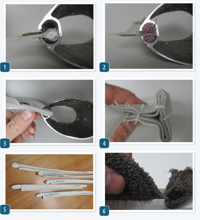

In the P-S articles I referenced earlier there were a couple of similar ideas. Run a cleaning rag up the slot with a downhaul and work it up and down the mast with the halyard. I have a couple of short sections of luff tape that I can clean my jib and main tracks with.
For a small boat like the FS, just take the mast down and clean it. One person can drop and raise the mast although it is easier with 2 people. The mast is really light, maybe 20-30 lbs. I've done it several times with my Scot.
Likes: jon hansen
Mar 26, 2011
4,008
Corsair F-24 MK I Deale, MD

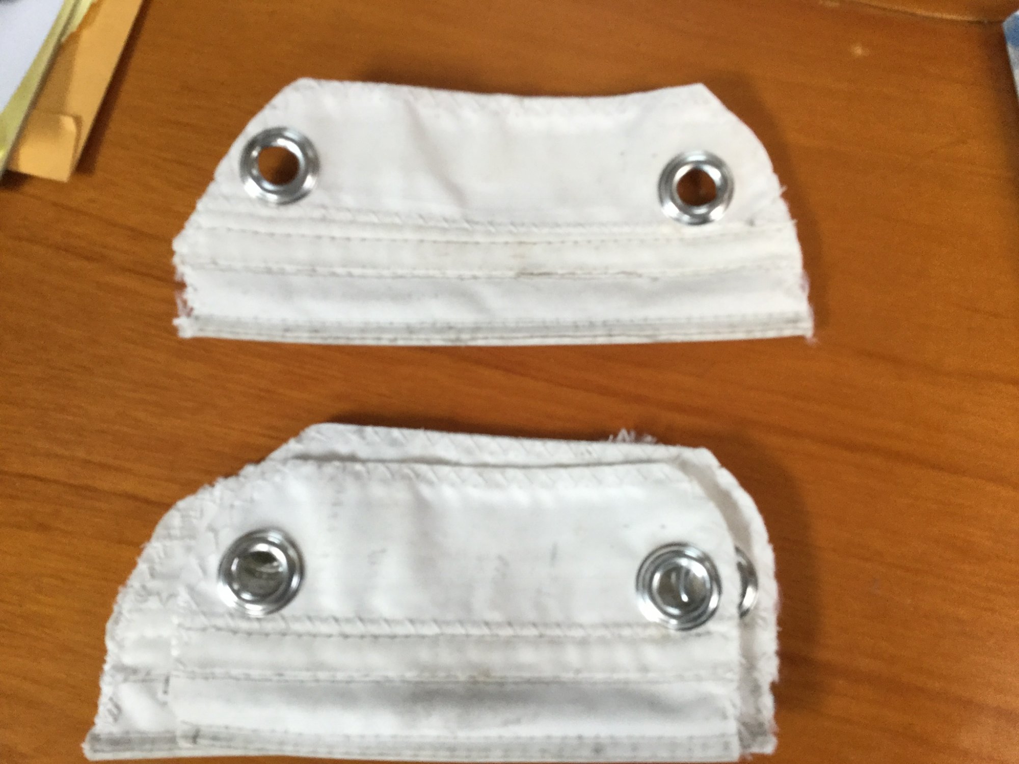

Yup, like this: Either home made or purchased. You can make your own with some luff tape and some grommets. Shooting the hose at the track also helps. You can soak the cleaner with anything from soap and water to mineral spirits, depending on the problem.
The makers of the cleaners I show in #5 is OOB.
