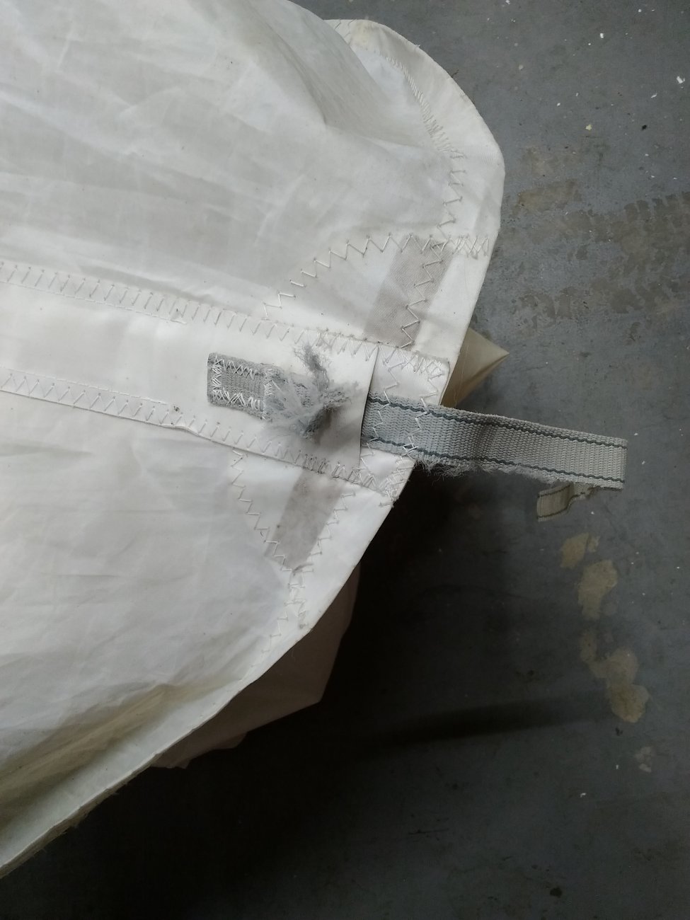

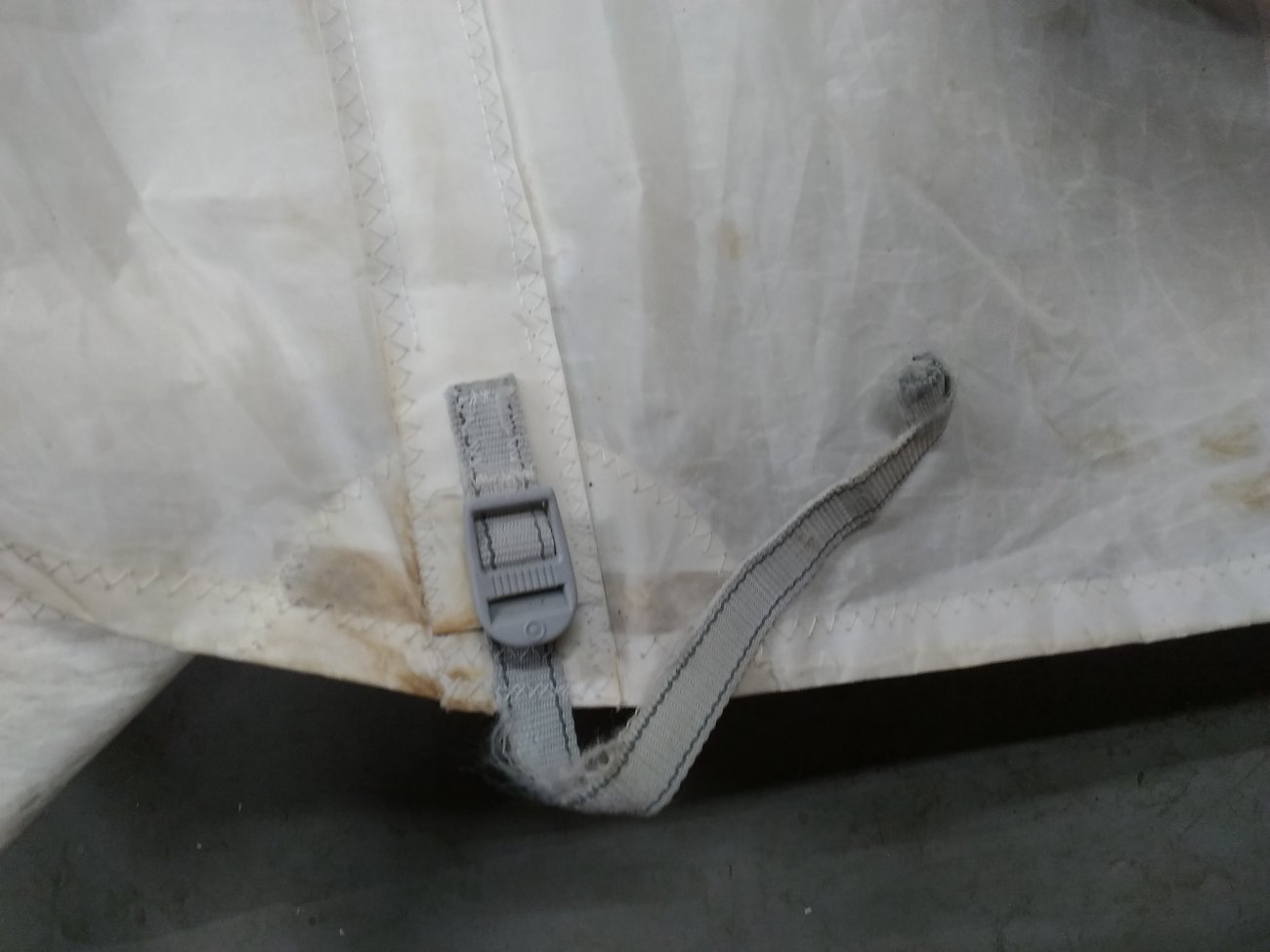

I have a Hunter 18.5. I have yet to sail her and as I was practicing in the driveway, I noticed that there are straps on the sail that look like they either hold the batans? in or attach to a back stay (which I don't think I have) or both. But three out of four are tattered or ripped off. How can I fix them, and do I need them?

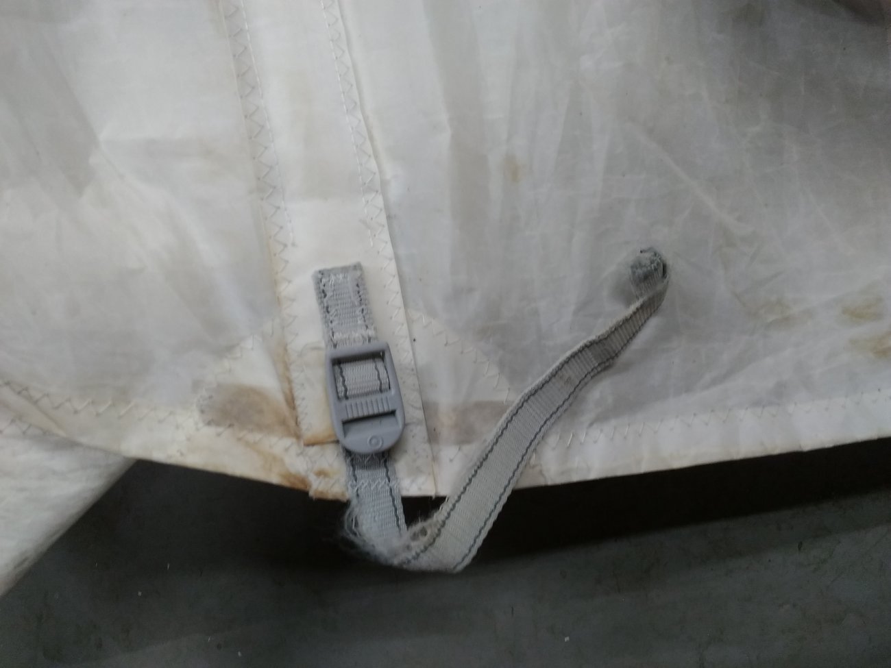

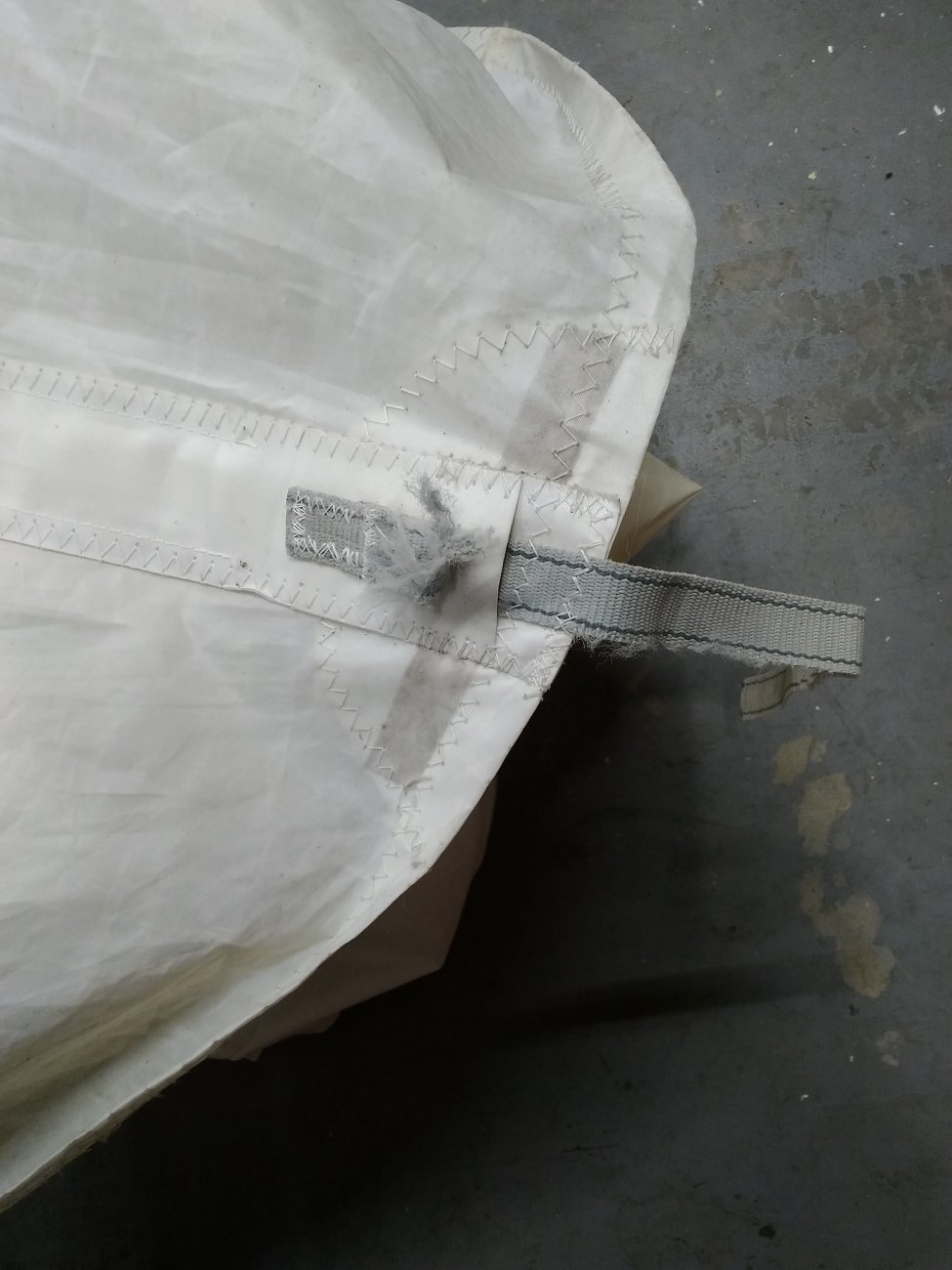

Only one of the four are intact. I can see that hold the bath and, but what about the rope that dangles from the top of the mast?
Do I have to sew on new straps or can I use glue?

It is 18.5' long. The straps are sewn, and the battans have loops on the ends. I plan going out this weekend, maybe without battans and then work replacing the straps. Thanks for the help.

D7764, keep it simple so you can get out there. Most install battens at the beginning of the season, removing them only for storage. Take a needle and heavy thread, sew the grey webbing strap pieces together once you have the batten in place. Sew just the strap if you can versus through the sailcloth. If you have to sew through the sailcloth, that will be ok. Then you can then fix when you have time. The fix involves removing the webbing that is damaged, sewing on a new piece with the buckle I recommend sailing with the battens in. The battens support the positive roach in your mainsail, keeping the leech from folding down on itself.
