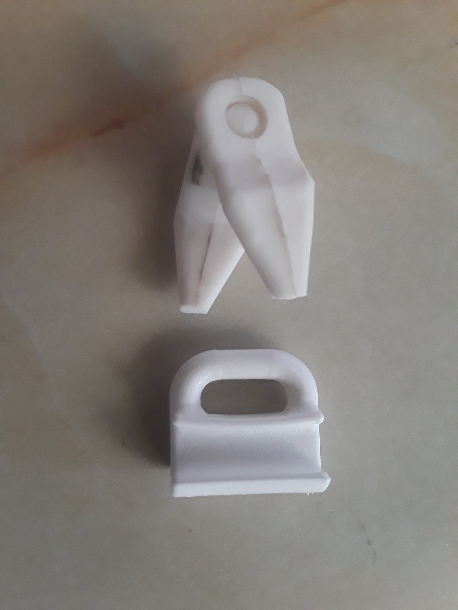

Had a very windy sail yestersay. My neighbor broke 6 sail slugs. He had to remove his main to get new ones sewn in. Came to find out I broke one too. Only mine snap thru grommets in the sail. The loop part that captures the slug broke away. Does anyone know where to get these? May as well order a few.

If you broke only one, I would suggest replacing all, because the others may not be far behind on the assumption that there would be UV damage and/or age.

Yah likely they are all aged and brittle. I had half of mine go on our first few days of sailing on a week long trip. Luckily a local marine store had some instock and we were able to continue on :)

Depends on which part breaks, of course. I never break the shackle, only the slug.

If the slug breaks get wire bale slugs (if available). Alternatively, they may just be old.
If the bottom 1-2 slugs break first, the problem may be that the tack is secured too far back from the mast (very common) and the outhaul tension is pulling them out. Slugs are not made to withstand outhaul tension.

When replacing sail slugs make sure the new ones are identical to the old ones.
When I had my sailmaker install slugs to convert my main from luff rope to slugs I couldn't get my main up. The second and third slugs from the head would tilt and jam into the luff grove.
I tried lube on the slugs and everything else I could think of. But nothing worked until I looked real close and saw that those two problem slugs were slightly different in shape than the others.
It turned out that the sailmakers slug locker had a few odd slugs thrown in. He changed the odd ones and now there's no problem. It took a very close examination to see the difference in slugs. But it made a big difference.
