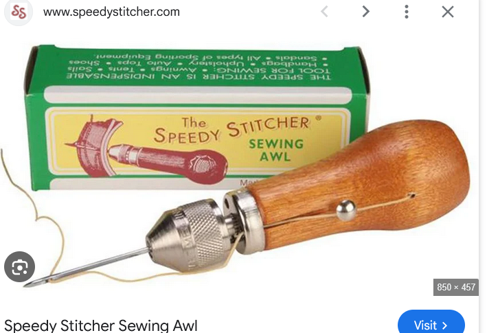

RE: I'm trying to reduce friction without breaking the bank on an external system. I currently have nylon slides which are likely five years old.
The slides can rotate or twist in the track if the tape connecting the slide to the sail is old/ worn/ loose.
It could be a lower one that is twisting.
Check for loose or wobbly (that is the technical term :cool:) slides.
Then get some new tape and reconnect then TIGHTLY.
Nice easy Speedy Stitcher job.
Gary

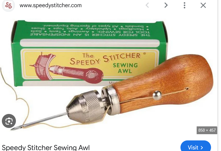

Gary
It's connected to the slide with a shackle but I know there's play in it. I saw the lower end of the first slide go aft a bit when I first started pulling on the halyard. Too bad I can't get the halyard to connect to the sail, closer to the mast
